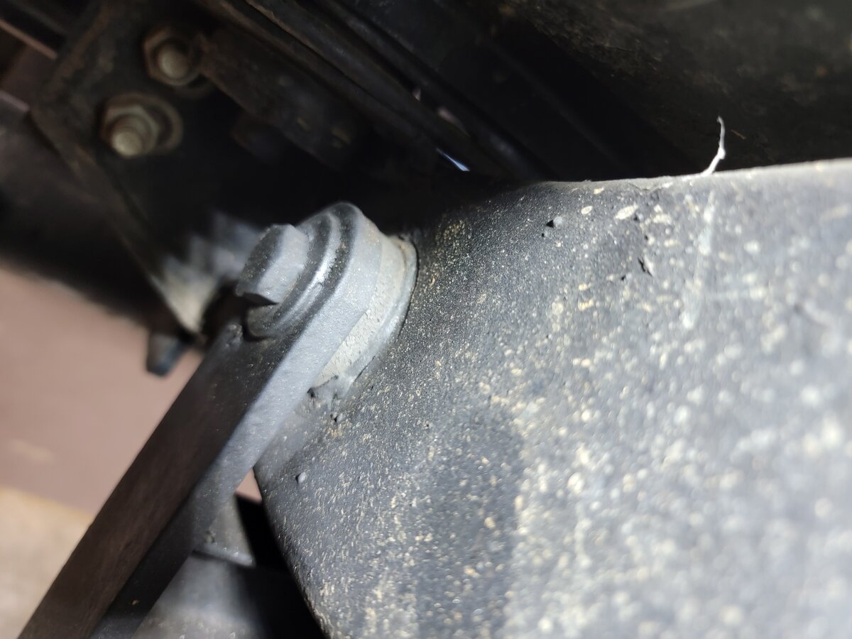

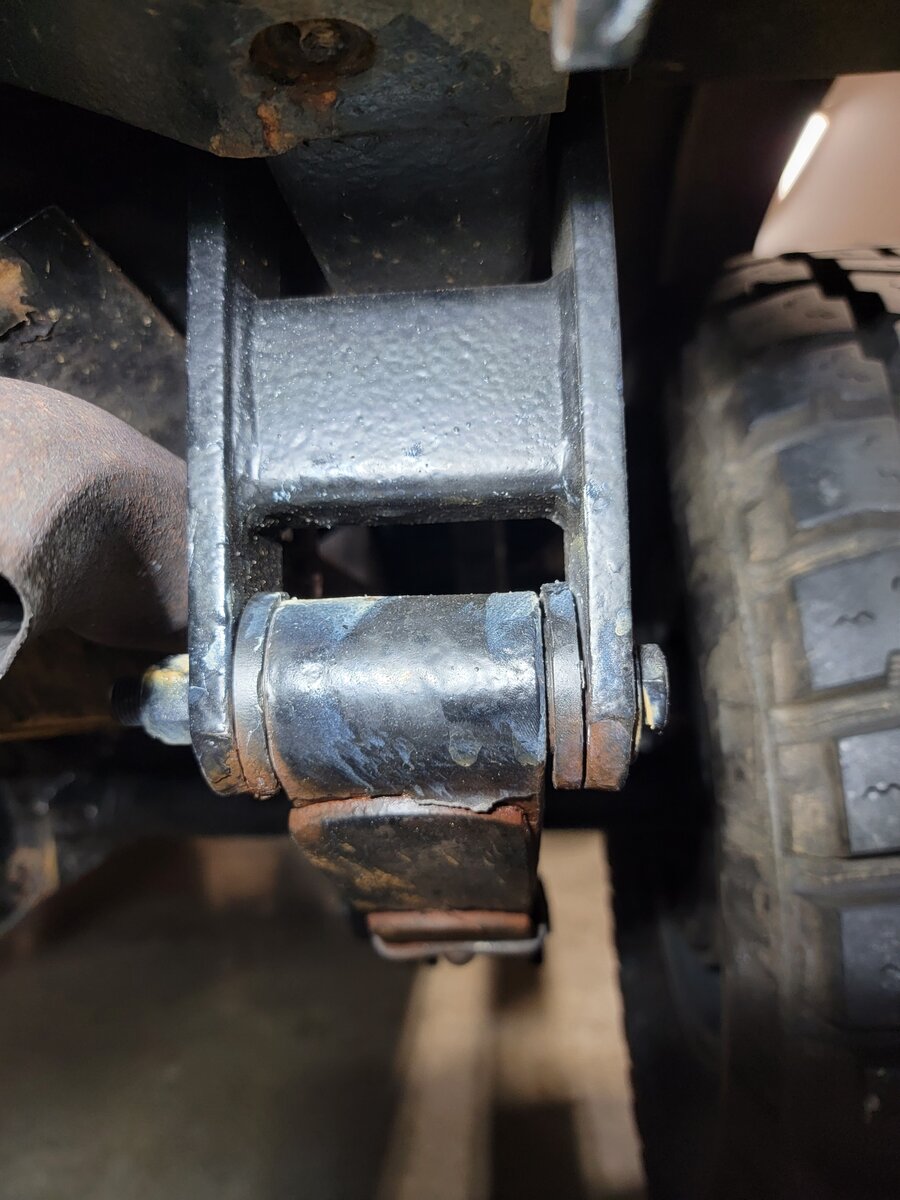

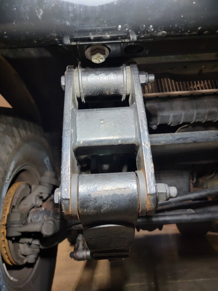

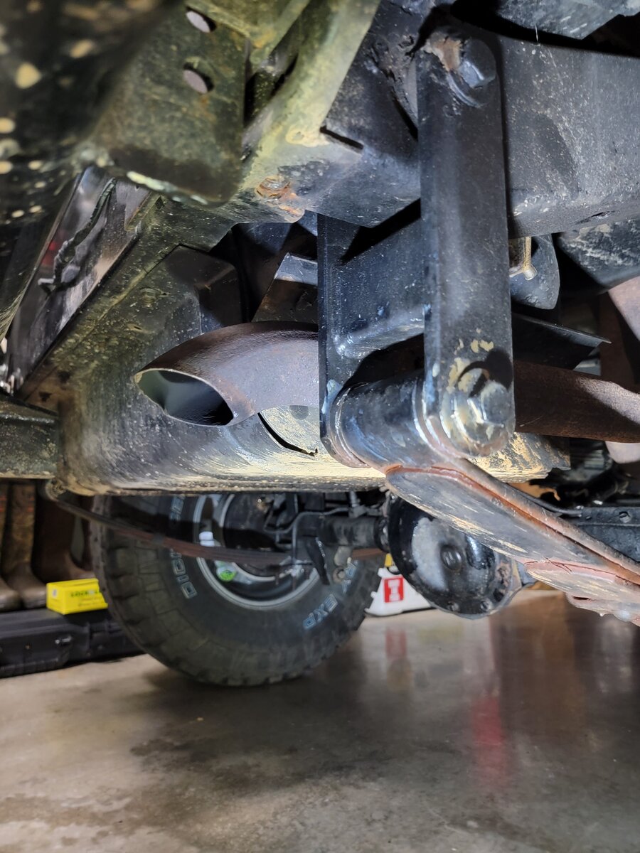

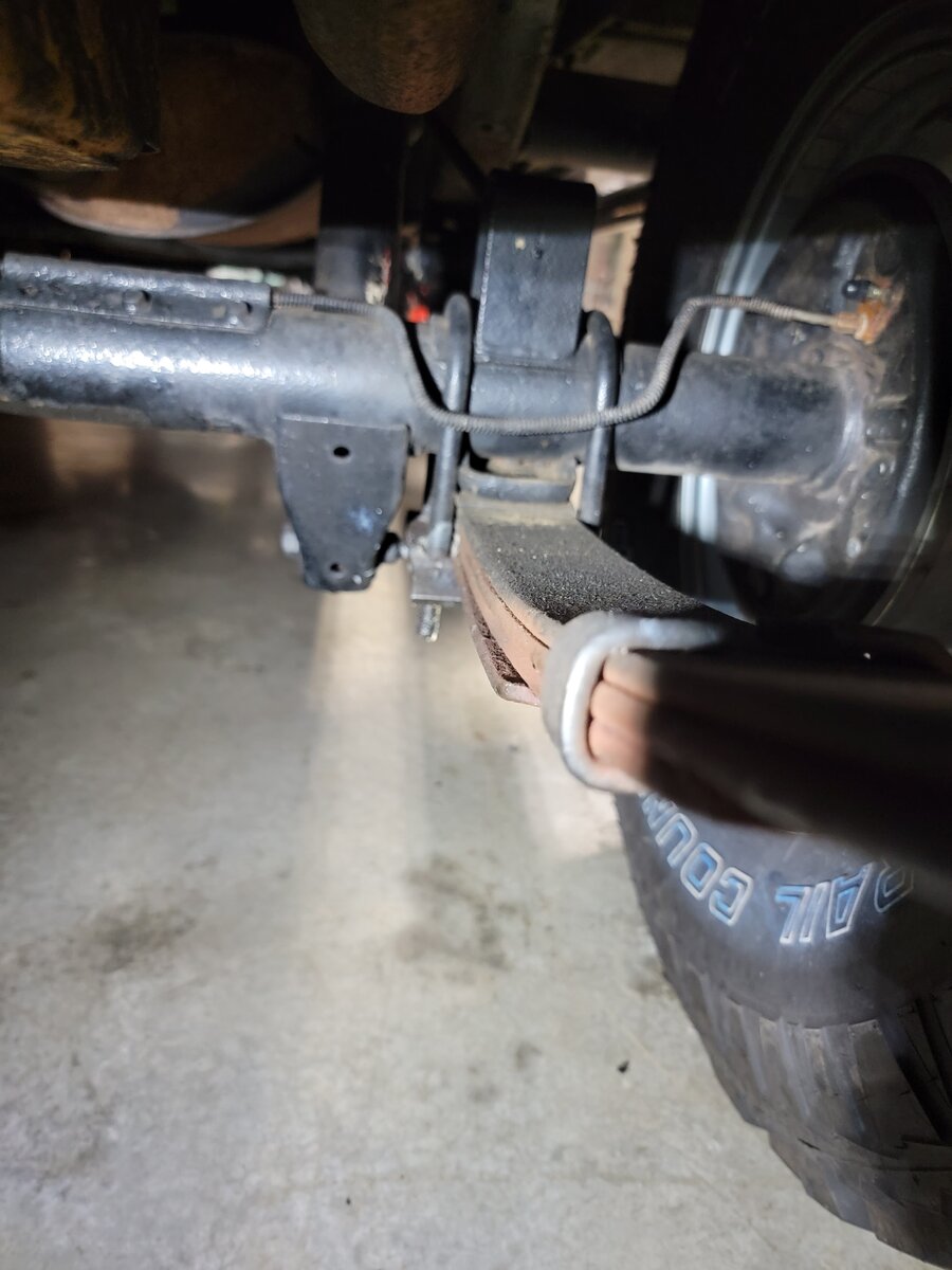

Discovery #1. Started inspected these closer, plan was to replace them eventually anyway but Im curious what the forum pros say as far as how soon, or if there some other solution. The PO had a large lift with extended shackles installed. I know the issues that come with these but I have not fealt them yet, plus these welded shackles seem real HEAVY DUTY compared to what is on the market.
Anyway, the bushing at the bottom seem newer than the shackle to frame bushing, maybe diff material. It also looks like there is a small gap on the bottom bushings. Do I just tighten these down? I feel like the shackle is already bending in a little from this being done in the past. Also what torque to tighten them down to?

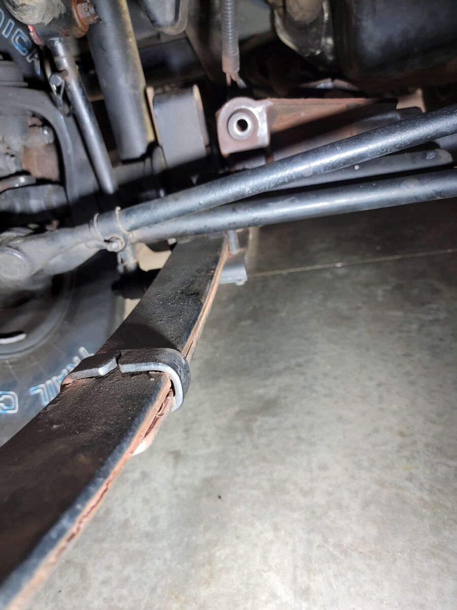

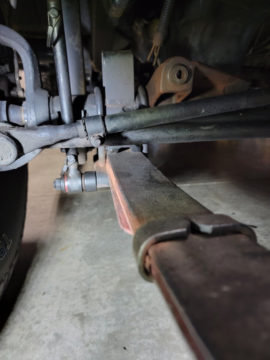

Discovery #2. My some of the leafs in my spring are sticking out some. Is this normal? No? What is the cause and fix? Hammer them in and retorque ubolts?

As for the bushings it looks like the previous owner put in bushings that were too long for the spring or something. Those are poly, many aftermarkets are. The stock frame bushings are rubber Clevite brand. I don’t know why you have a problem though. I’d figure out what springs you have if they aren’t rough country.
I wouldn’t worry about the leaf being slightly crooked. It’s not going anywhere and it’s still carrying the load.
I'm still trying to find out what springs I have. Everything at one point was painted over, even the shocks so haven't been able to see any clear markings. There is some paint coming off on one shock that shows white and red underneath. I'll prob try and strip the paint if needed.
