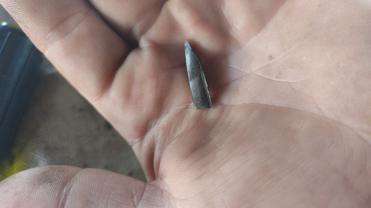

Well I found this when I drained the fluid.
I’d guess that piece fell off the input gear or counter gear, being those gears are not really in play when in 4th. I’d buy a reman trans from rockauto or similar.
