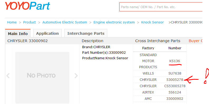

this year car know the new sensor can even hear bad HDA or BAD Lifter racket, to there is that pain, cured in 1991.with TBI or MPI.
there are no sensors sold now.zero. (www endless searches, none) 4.0L yes not yours.
so is moot point right lacking one ,try running it missing.

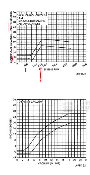

FSM pages, on timing dizzy 4.2
chapter 8D page 49 covers it
if engine pings. lower the static time say 2 degrees and then see if PING ends, (if happens at all)
it even states in the FSM to ground out the KS sensor,so static time can be, set, and vacuum advance defeated.

the dizzy does it all (and tiny bit via ECU.,,
this distrib is set at 1600 RPM for hood sicker spec, label RPM with a tool called a timing light. vacuum adv. pulled and plugged hose.

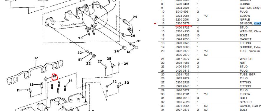

the rumor is the KS sensor can retard spark 15 degrees. and is not covered in the FSM. so is unknown.
it's purpose is to run REGULAR gasoline the cheap stuff.
a car this old gee, i'd have already tested the vacuum advance by hand vac,pump and the centrifugal too. they love to rust up and jam and MPG goes to HORRID.
that is about all.(the book covers all tests just told)
