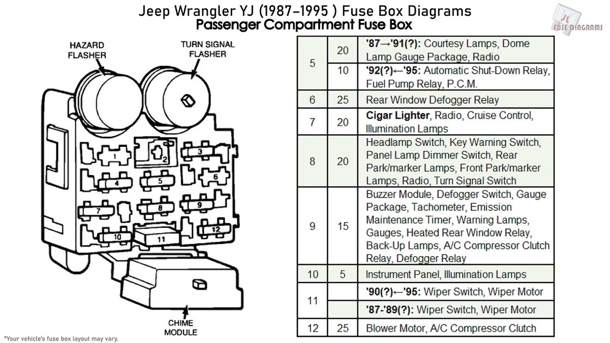

T-Rex Jeepster The Unoffendable Supporting Member Joined Sep 13, 2021 Messages 288 Location Middle Tennessee May 29, 2022 #4 Change the dome light fuse......Don't ask me how I know this......After spending HUNDREDS on the usual suspects........... Flyer58 said: Change the crankshaft position sensor on the bell housing? Click to expand... Yeah did that, No Bueno..................Dome light fuse.....................
T-Rex Jeepster The Unoffendable Supporting Member Joined Sep 13, 2021 Messages 288 Location Middle Tennessee May 29, 2022 #5 Check out #10.......Dome light fuse that also powers everything essential for internal combustion.....Both spark and fuel..........
