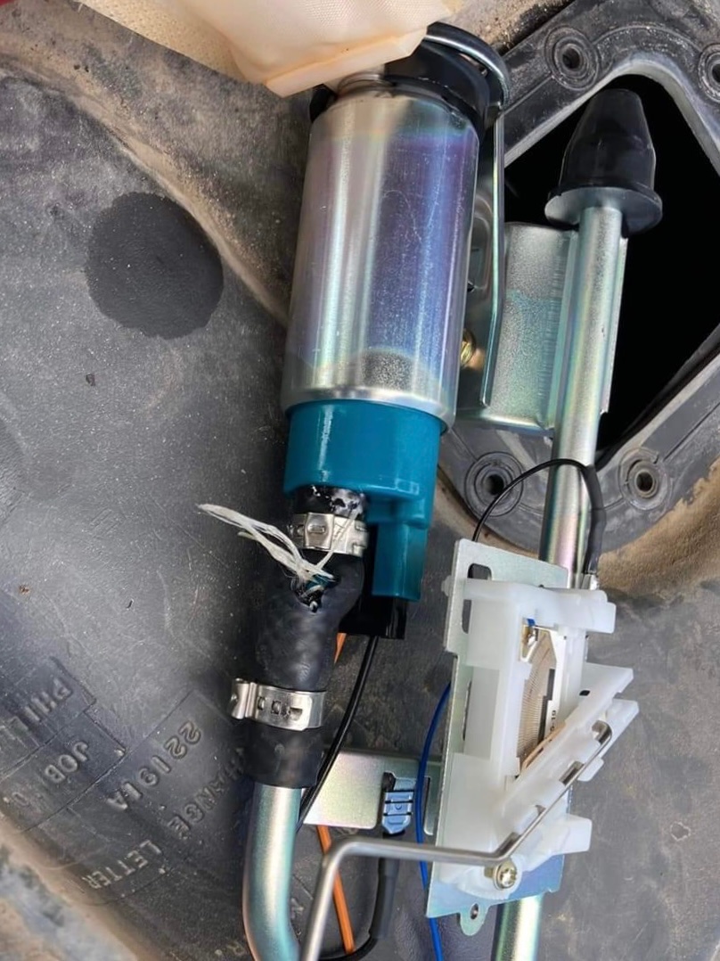

If the PO put in a typical aftermarket fuel pump assembly, there is a strong chance the 2” long hose on that connecting the pump to the outlet is split and not allowing pressure to build. Have to pull the tank and look at the hose for that one.
With the pressure not building even with pinching the return, I’d say you probably have a pump issue or the burst hose issue. If it’s the hose, then you need to get fuel pressure rated, submersible rated hose. Can find it on Amazon.

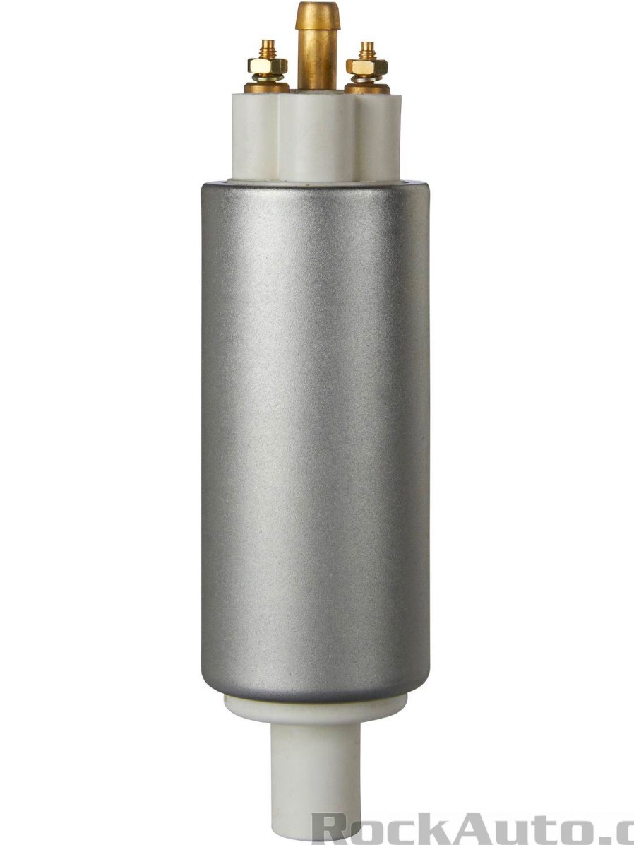

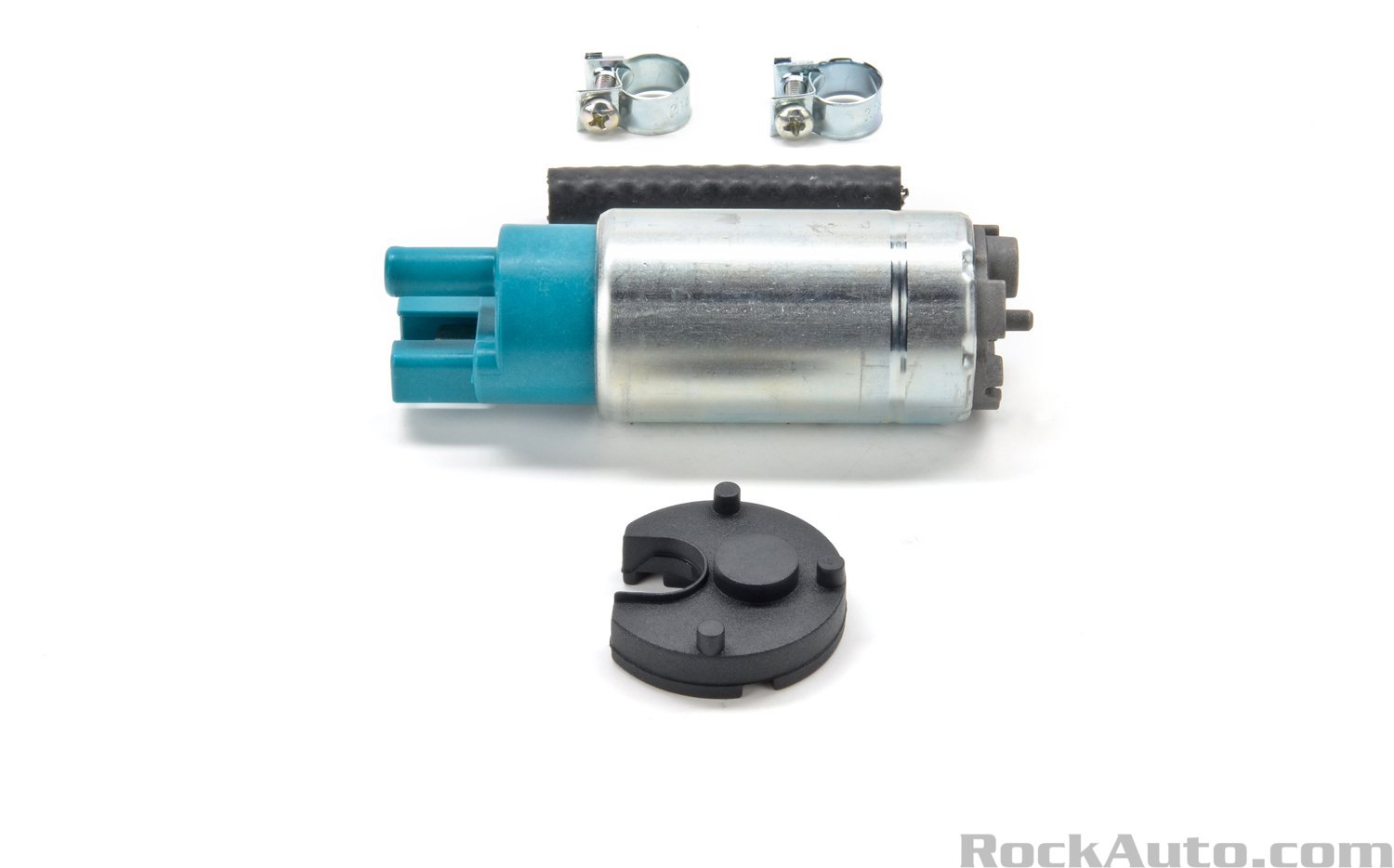

Looking on Rockauto and they have differing options for the pumps as far as terminal connection styles. I'd imagine 15 and 20 gallon are the same pump. They're the same tank, just Chrysler tried to monopolize paying more for having a bit less plastic on the filler neck. Mine is a 20 gallon or has had the mod already done.
Any preferred pump brand if it comes to replacement?
Other sources or part numbers of pumps to check out?
Given the guy had the sender replaced, I'd like to just replace the pump itself if everything else looks fine. The gauge is spot on for accuracy.

I don’t know much about pre-91, but from the research I’ve done, the best I’ve been able to determine is that from early 91 to somewhere around 93, the pumps were a brushed motor design and were larger, and supposedly they were Walbro brand. These are less common to find replacements for. They are the larger pump that have the studs and nuts for wires to connect to.
Supposedly some 93 and later had the smaller brushless motor, which was supposedly a Bosch (mine was and many others have said the same). It has a 2-wire connector on top.
The sending units are not cross compatible with the different pump styles because the pump sizes are different. So depending on what you find will really determine what you should buy.
My 94 had the brushless motor pump. It had Bosch written on it. I got another Bosch. Looked different but fit fine and worked fine for the little bit of time I’ve ran the engine. It did come with a hose as well, and I trust Bosch to give me a piece of hose that won’t burst.
Sending units from factory were 15 or 20 depending on what option you had. Most shipped as 15gal with the vent tube limiting capacity. Anything that came with advertised 20 gallon capacity would have the 20gal version sending unit. The funny thing is, it doesn’t make much difference either way. If you have the 15 gallon and trim the tube, you end up sitting on full for 75-100 miles. I know someone with the factory advertised 20 gallon on the YJ he used to have, and his still sat on full for a long time, like 75 or so miles. So apparently they are not that different, despite being two official different part numbers from Mopar.
Back to the topic of the earlier larger pump vs the smaller later pump: these can be interchangeable if you buy the sending unit that fits them. So if you wanted to swap from the earlier pump to later for better options, you’d just need the sending unit means to use the other pump. The overall height should be the same between the two because the tanks to my understanding are the same height.
