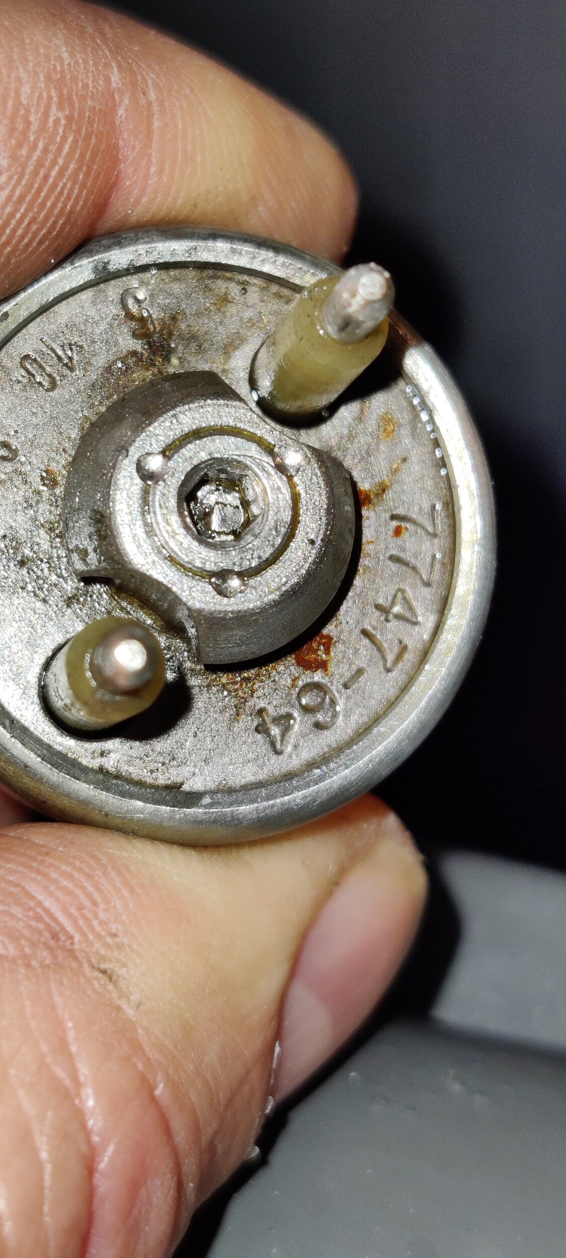

Is there anything wrong with this fuel injector?
jpjeep26uk
Nov 12, 2022
350
UK
Hi, can anyone tell me from the pictures if there is anything obviously wrong with my single point injector for my 2.5l 4cyl?
Before I start hunting for a new one around the globe.
( It's getting power and ground from the ECU but not spraying at all despite having fuel at the inlet)
Thanks all.
Rockauto has new or rebuilt injectors. So they are available. TJ39 for a 90 YJ with the 4 banger,new is $108 or GB REMANUFACTURING 81116103 Reman T/B Fuel Injector @ $33
Thanks Gila, Just checked them out. That's not bad even with shipping. Probably get the new one rather than send mine over for refurb.
Just can't seem to get mine to spray the fuel. Pulse is there, noid is showing good power pulse etc, fuel is there, just won't let the fuel through, so I think it's a busted injector.
