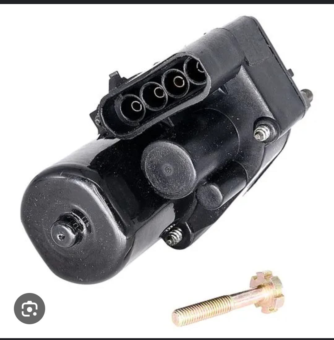

In my quest to rule out everything that was preventing my Jeep from firing up I played around with the idle controller and forgot to take a pic of where it was when it was running smooth.
Can someone with a 2.5l 4cyl take a pic of their IAC so I can try the setting out to see if I can replicate it please? Mine is running but it's quite chuggy.

Heres a pic of my type of IAC.
dont know if it will work or not, but try setting the screw to bottow it out, slowly unscrew 1/1/2 turns. keep slowly move out till it running right. also are sure you got the aic seated correctly. good luck.
