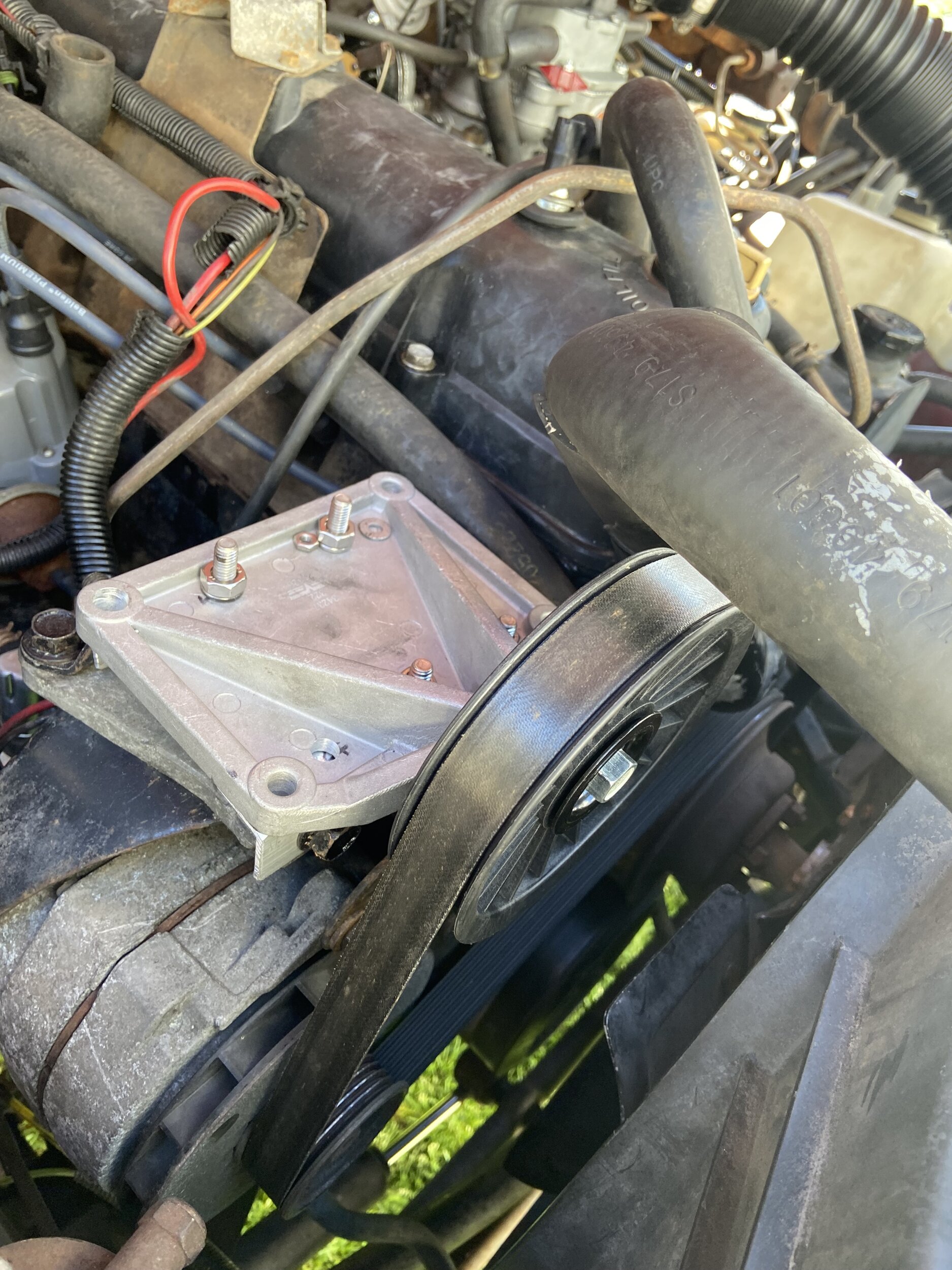

Took compressor off and laid the by pass pulley top of mounts just to see WTF.
Slipped existing belt over pulley to get idea of how it'd go.
" Hmmmmmm, maybe I can use existing belt and not cut bracket mounts"?????

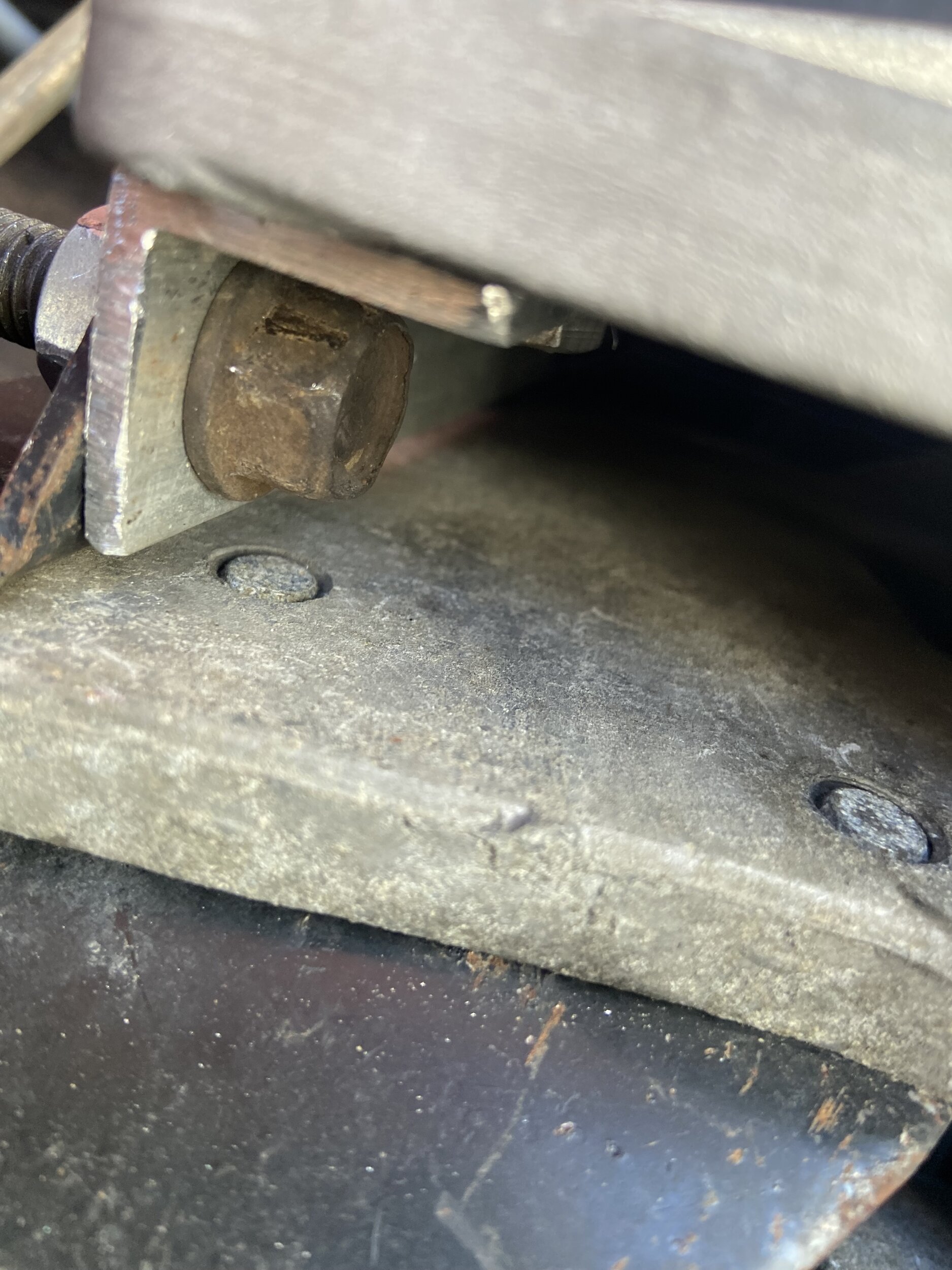

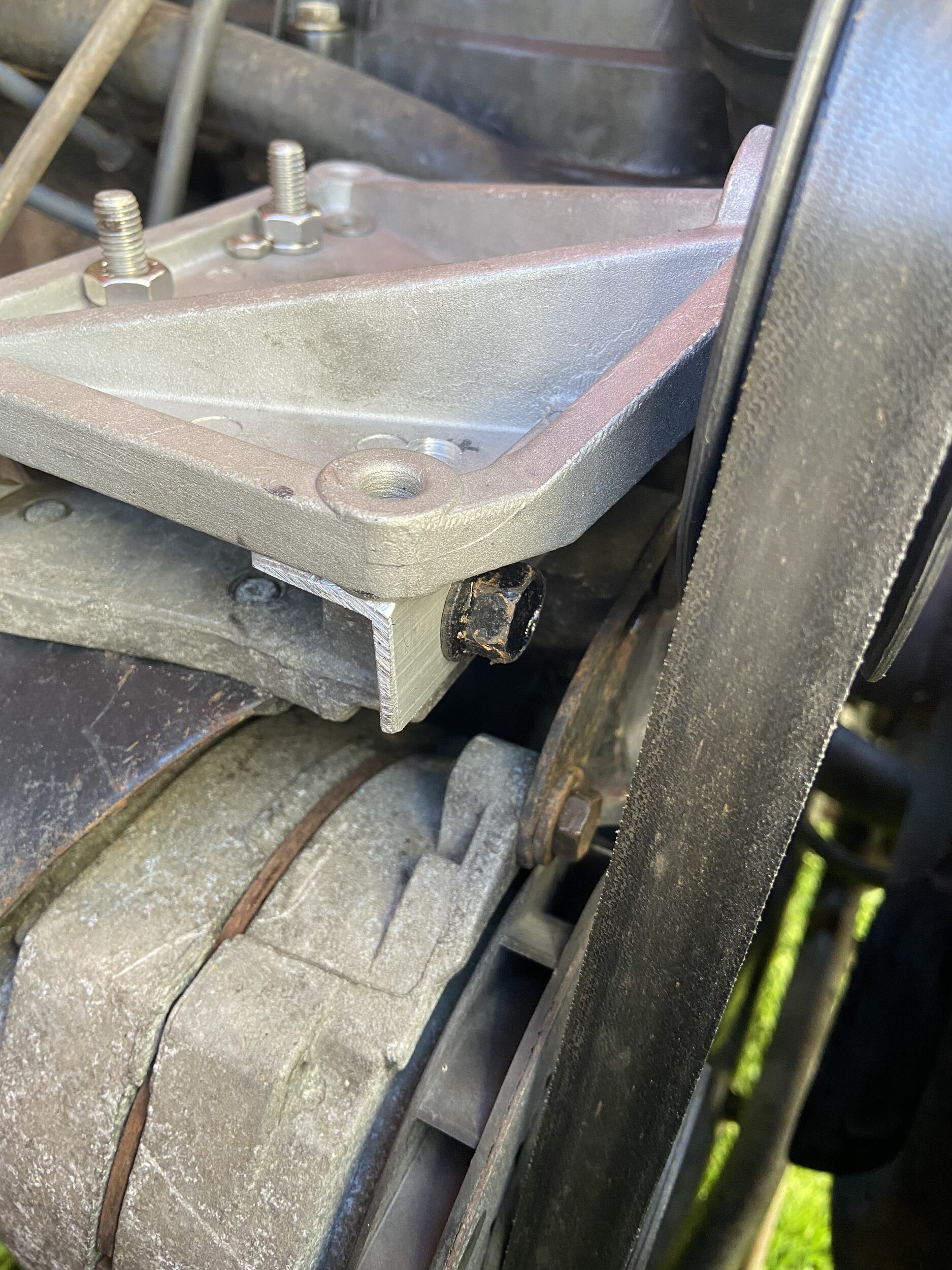

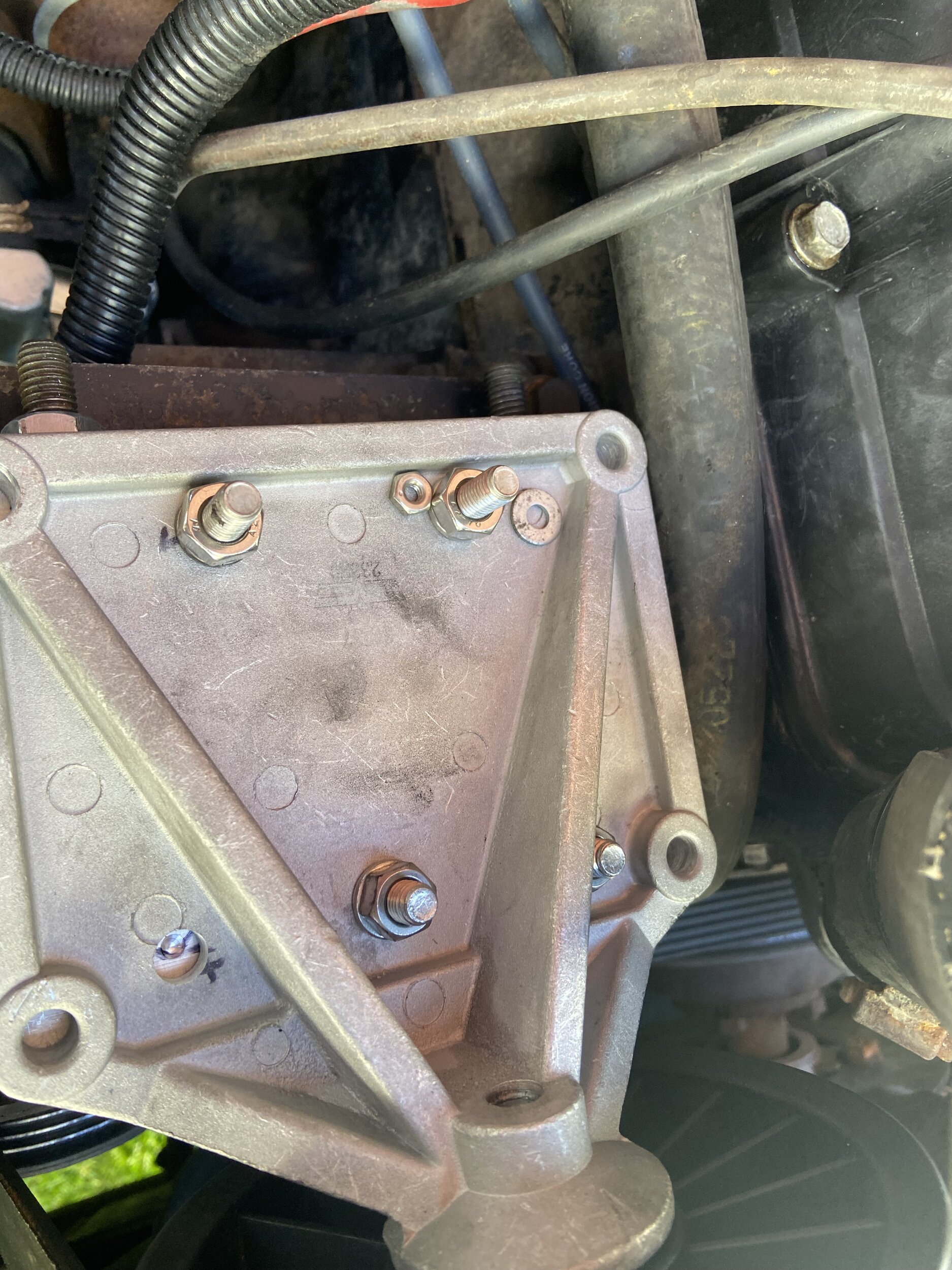

I took a 2" almn. angle and lay it on base,( there is a metal one in back for rear compressor).
Drilled holes to mount it on compressor bracket laid By pass on top, marked place for new mounting holes, Drilled them, then drill almn angle, bolt it all together, used existing belt to finish mod off.
Didn't have to use new belt!!!
Seems like it works well, sturdy!
Make sure By Pass Pulley is slightly IN from alt to make sure it works well,( center line on compressor and By Pass Pulley is under radiator hose).
Might have to cut out area to get at #1 spark plug,( maybe).
