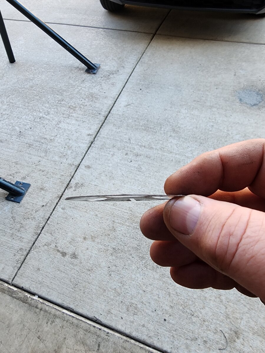

Pman Moderator Staff Member Joined Jun 15, 2023 Messages 60 Location Washougal Wa 98671 Sep 30, 2023 #1 I noticed the thin steel plate under the horn button is not flat. Is it supposed to be slightly concave? If so which end goes towards the steering wheel? Pic for reference but it's hard to pick up in a photo

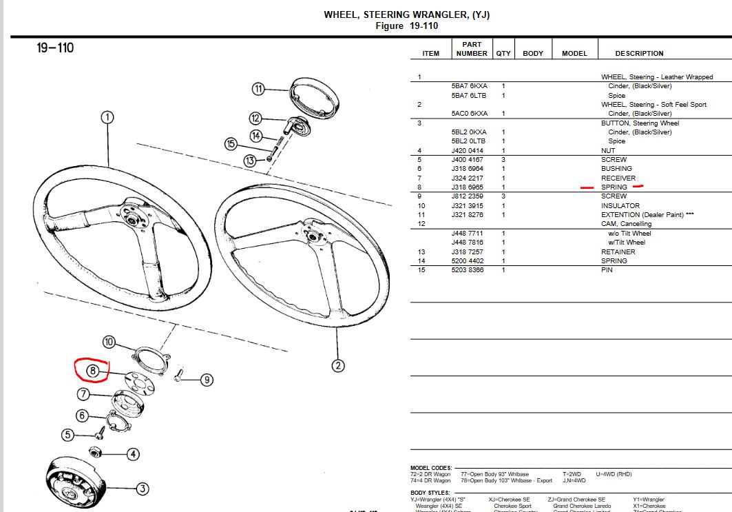

deadpool1 older than dirt but faster than the speed of dark Supporting Member Joined Sep 21, 2023 Messages 424 Location locations in USA and Peru and Coasta Rica, Oct 1, 2023 #2 yes not plate it is a spring. on purpose or horn spring . Reactions: Pman
Flyer58 YJ Enthusiast Joined Apr 12, 2020 Messages 977 Location Magnolia, Texas Oct 1, 2023 #3 A I recall the outer edge curves forward, away from the horn button Reactions: Pman
