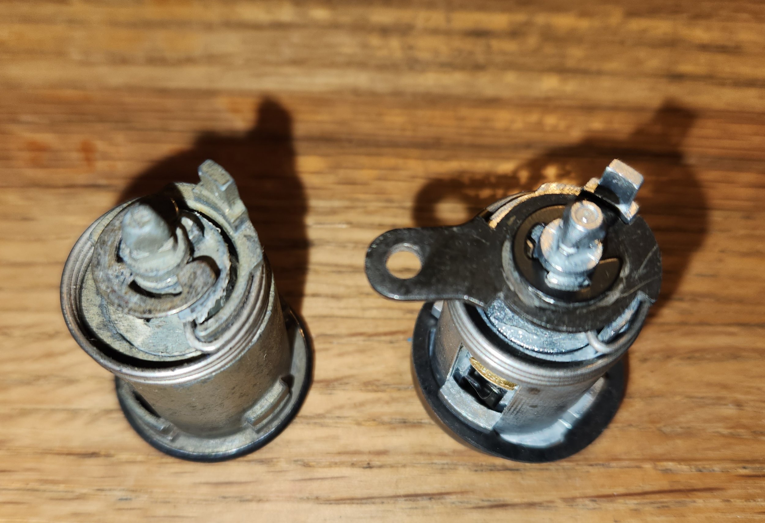

Having problems finding door locks .ordered for my year 94 they r diff..can the hard top b a different year how can I tell thanks
Those look close to what my 92 has but yours is missing the rest of the linkage that goes to the latch.
I bought a new set from Amazon and the linkage is not included with the locks.
The linkage on half doors is short, like the one on the right, I need the longer linkage for the full size doors. Something that's no longer made and very hard to find.
deadjeepparts list what i think you want{27.99} used they have six listed on ebay.

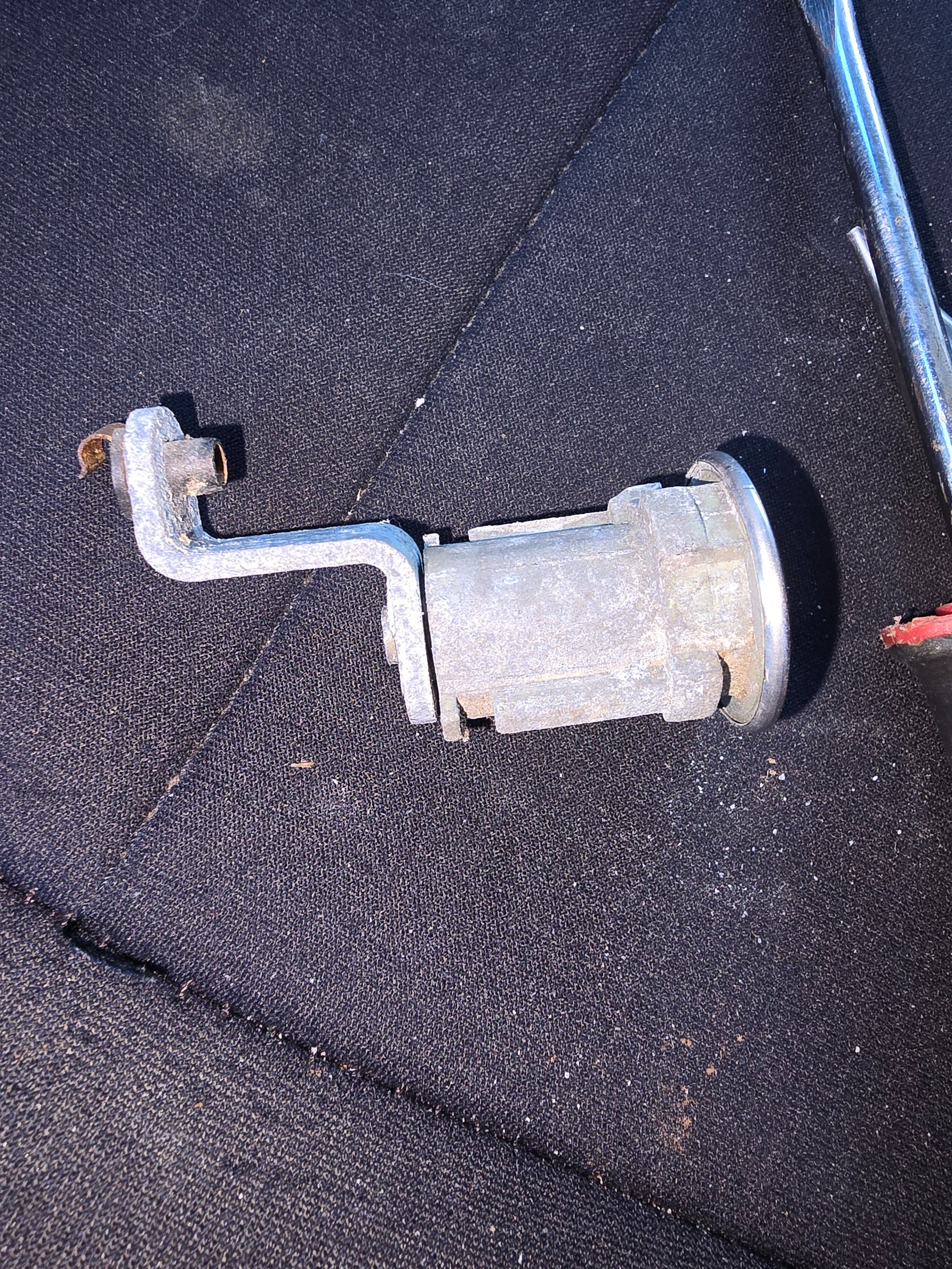

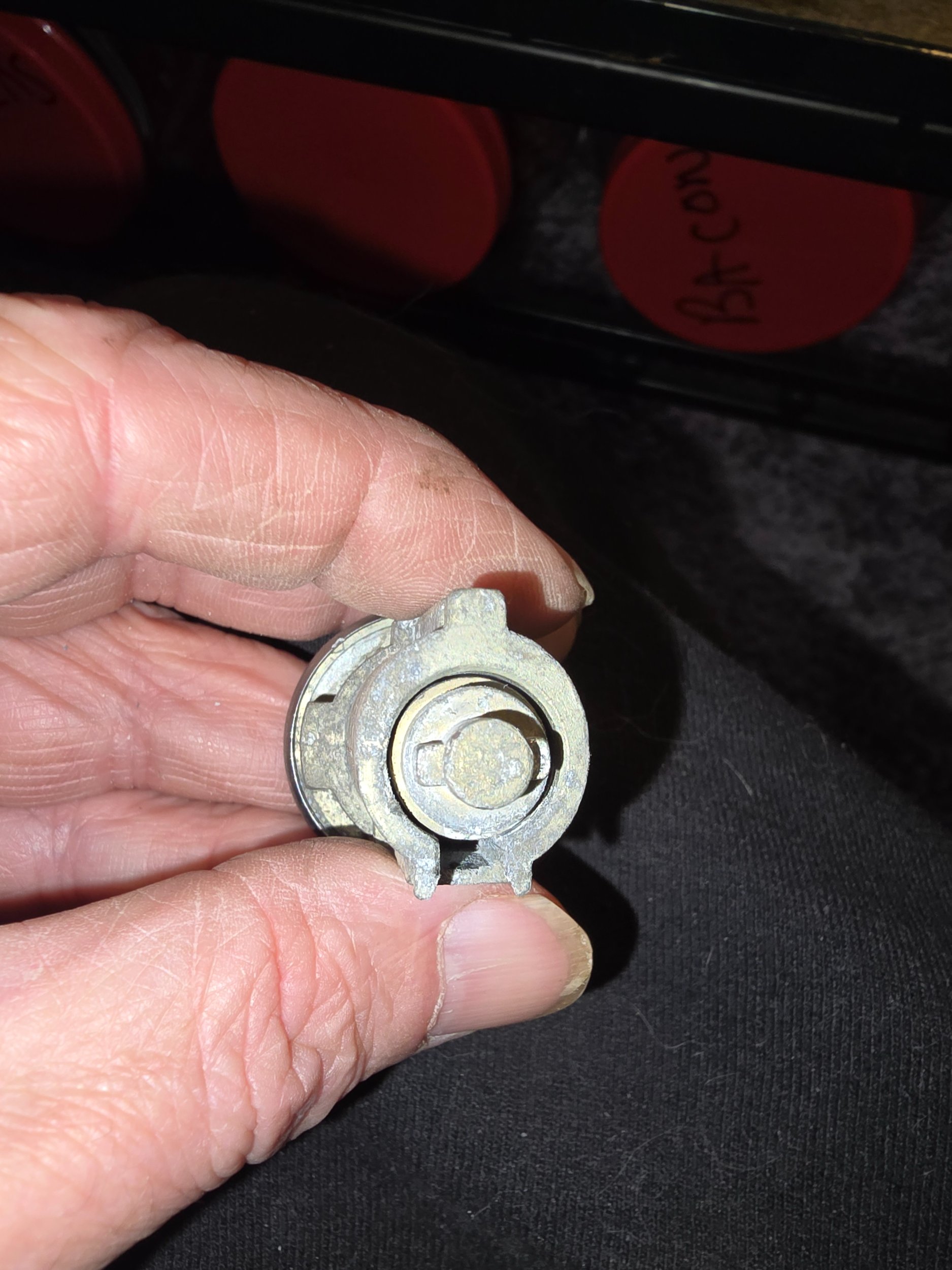

My 1995 YJ with Half Doors driver side out side door lock cannot be operated with the key anymore. It used to work a year or 2 just fine, but over the years the key slowly began to "hang" while trying to lock or unlock the door. The inside door lock works properly. Any ideas how to fix this lock?
I had the same problem in the past yr. i flooded the lock with wd40, is now working fine. good luck
