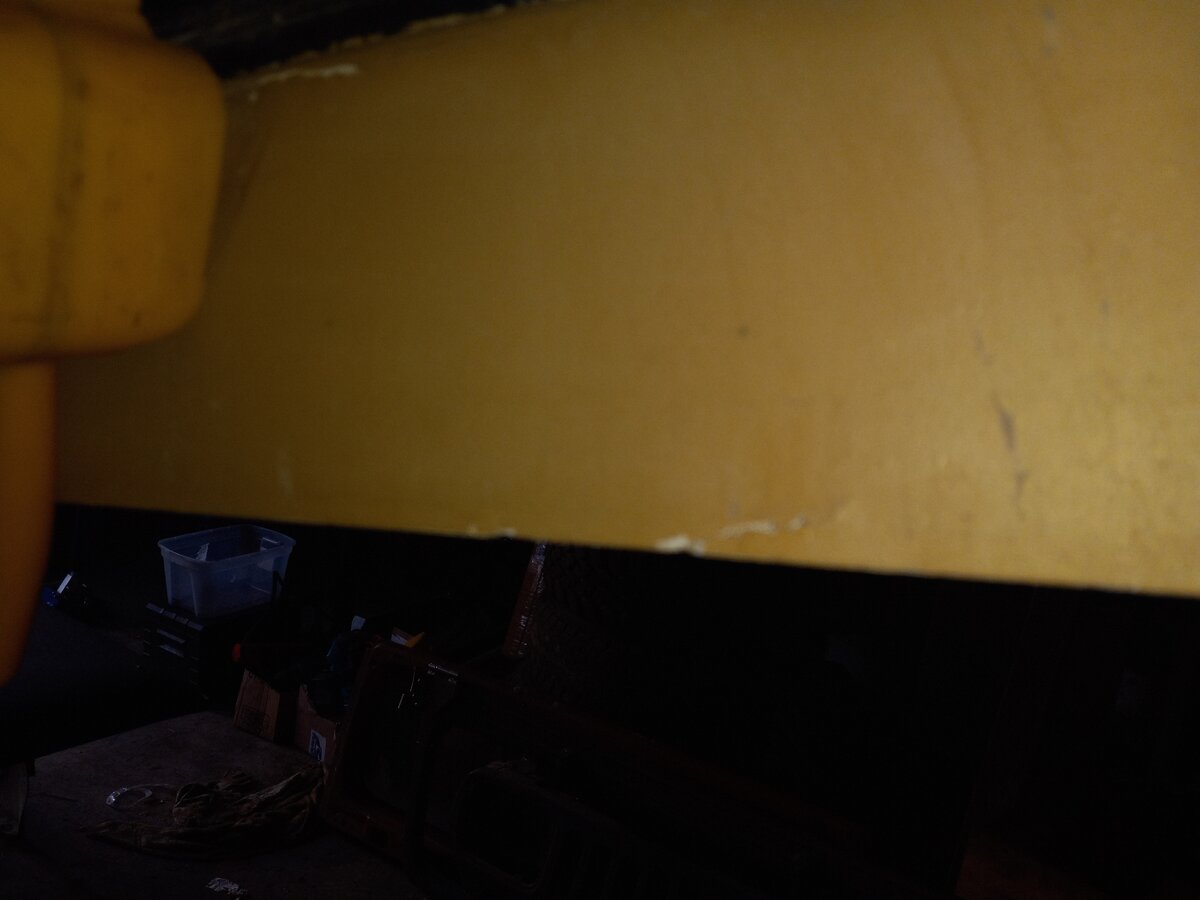

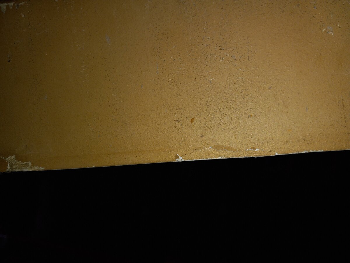

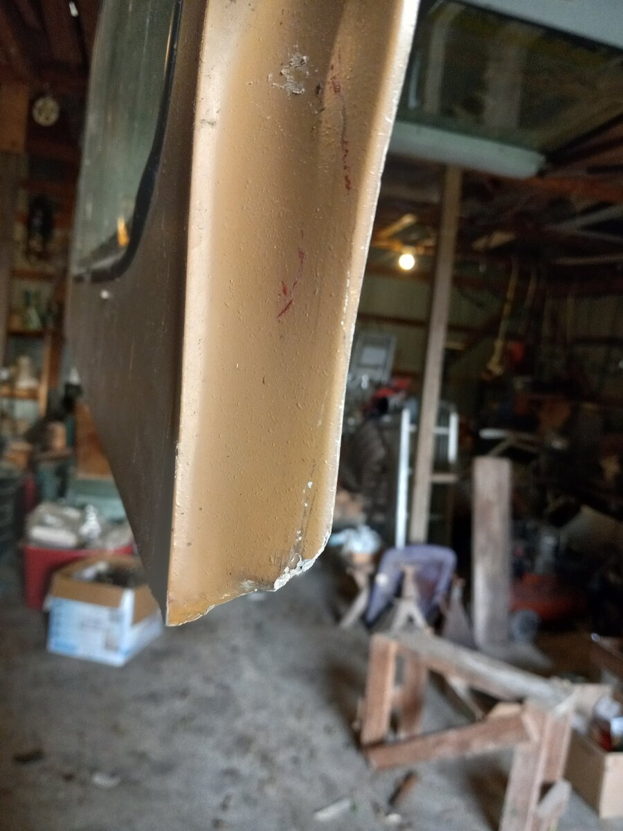

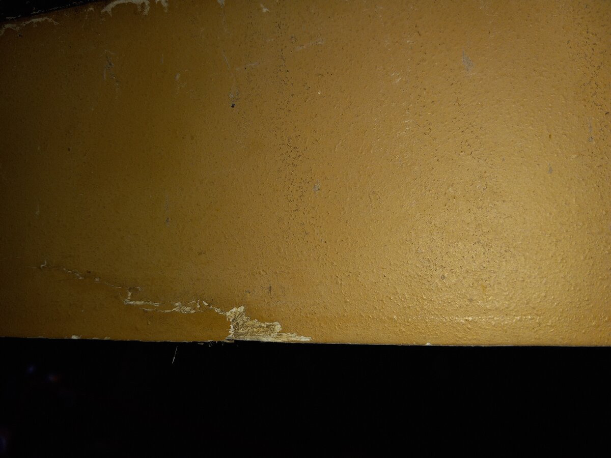

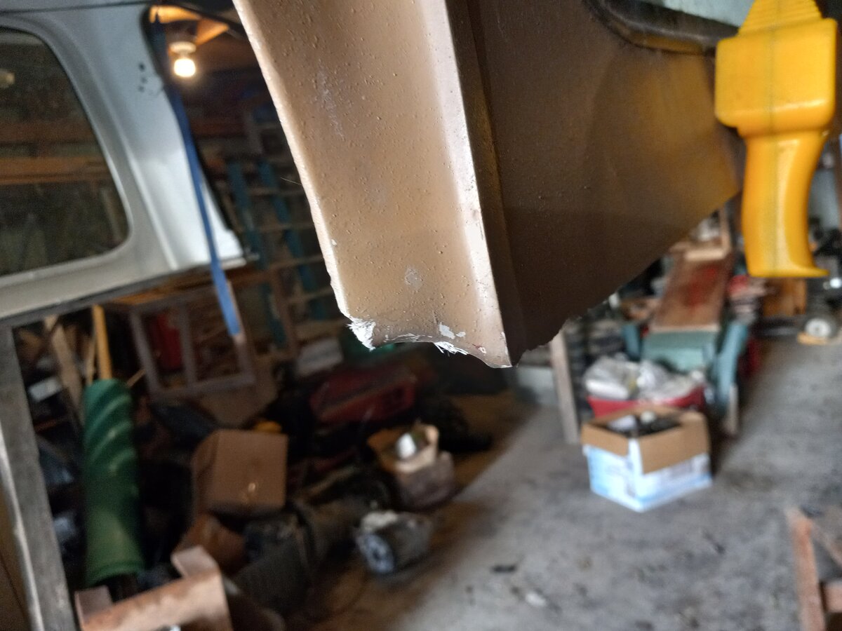

I would keep the 93 hardtop because it has the rear wiper, but it has cracking along the bottom. Not sure if it is fixable or if I am being to bothered by it.

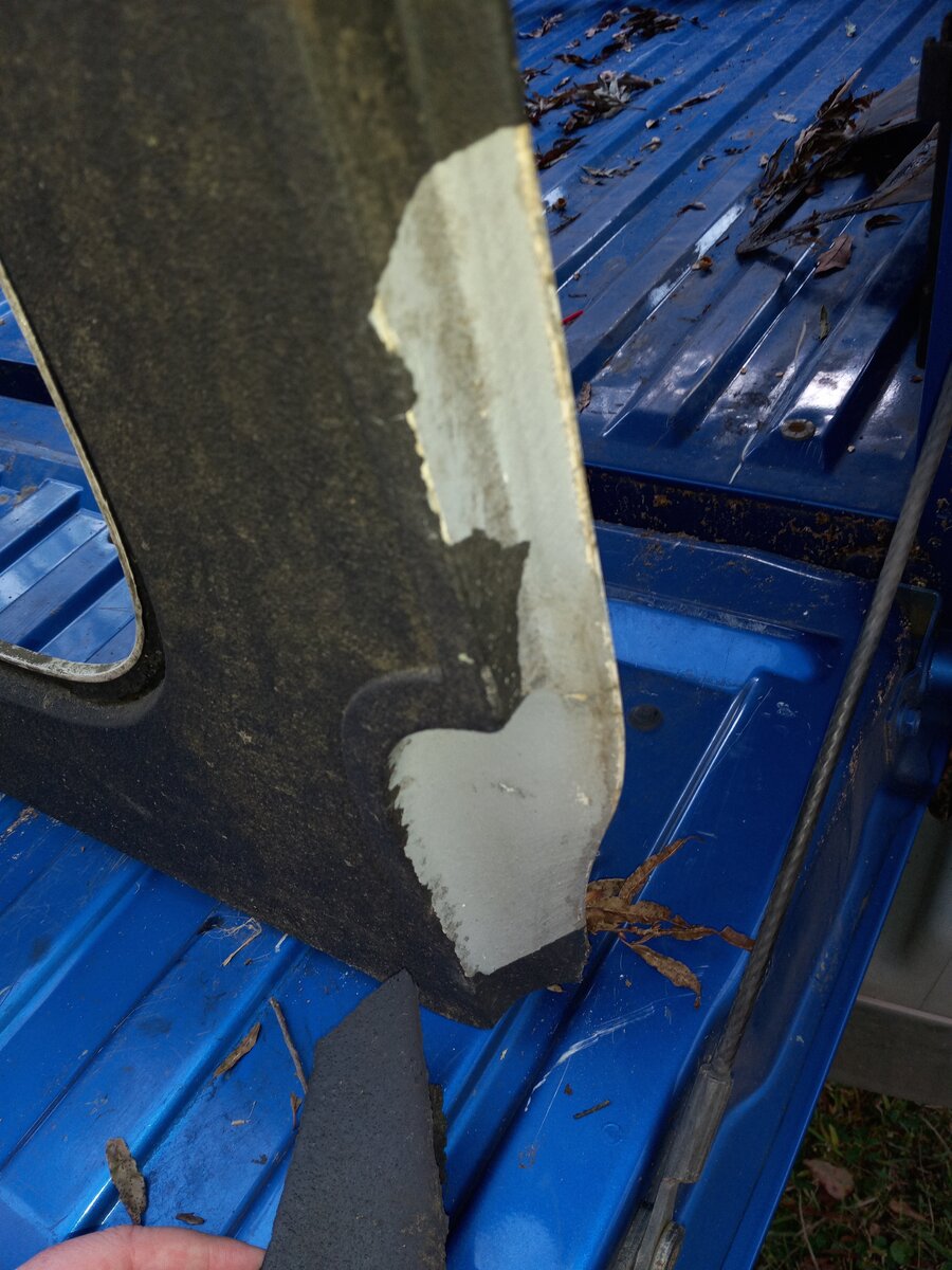

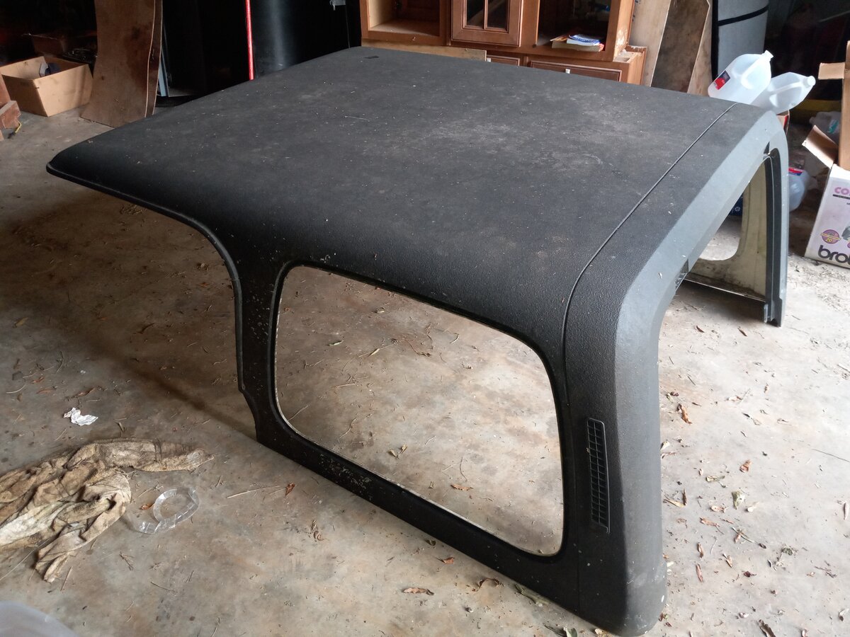

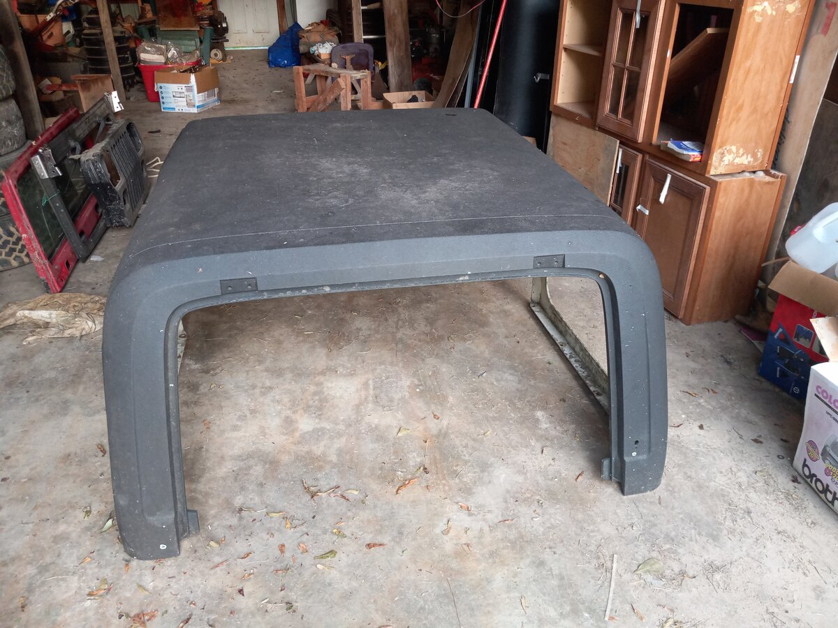

The 88 hartop is in better shape. It is rhinoed, but is is peeling off in places. No big deal. I would plan on removing it anyways and repaint it.
88 hartop:

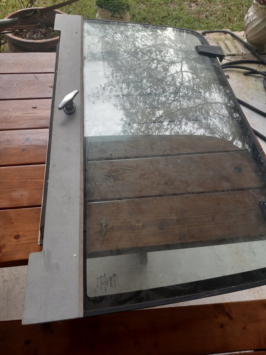

This leads me to my question. How often do you guys use the rear wiper? I was planning on swapping the rear doors and the plugin(if possible) and thus keeping the 88 hard top with the 93 rear wiper door. However, my Jeep does not have the correct harness and switches to even use the rear wiper, but if I were to plan on it later on, I would rather have the rear wiper.
If the rear wiper is not a big deal, I will save all trouble and keep the 88 hardtop as is and sell the 93 with the wiper door.

wondering if you'd be able to fish the 93 wiring/hose guts from that top into the 88? Haven't looked into that much. Probably don't need the wiper/washer but it would be nice to retain it if possible. Or maybe a body shop that knows how to work with fiberglass could fix up the 93 top for you?

Yeah, I wasn't sure if that is an easy fix. I am not familar with fiberglass.
If it's got the dome light then at least you know the wiring path is there. How tough that might be to fish the guts through, who knows. And you'd probably need to swap the glass over too because I believe the glass has the wiper and motor mounted to it. Recalling from memory here as I'm not home to look.

I know nothing about fixing fiberglass personally but I have seen some people say "working on fiberglass is cake". Not sure how true or not true that is, but maybe worth a call to a few good shops.
