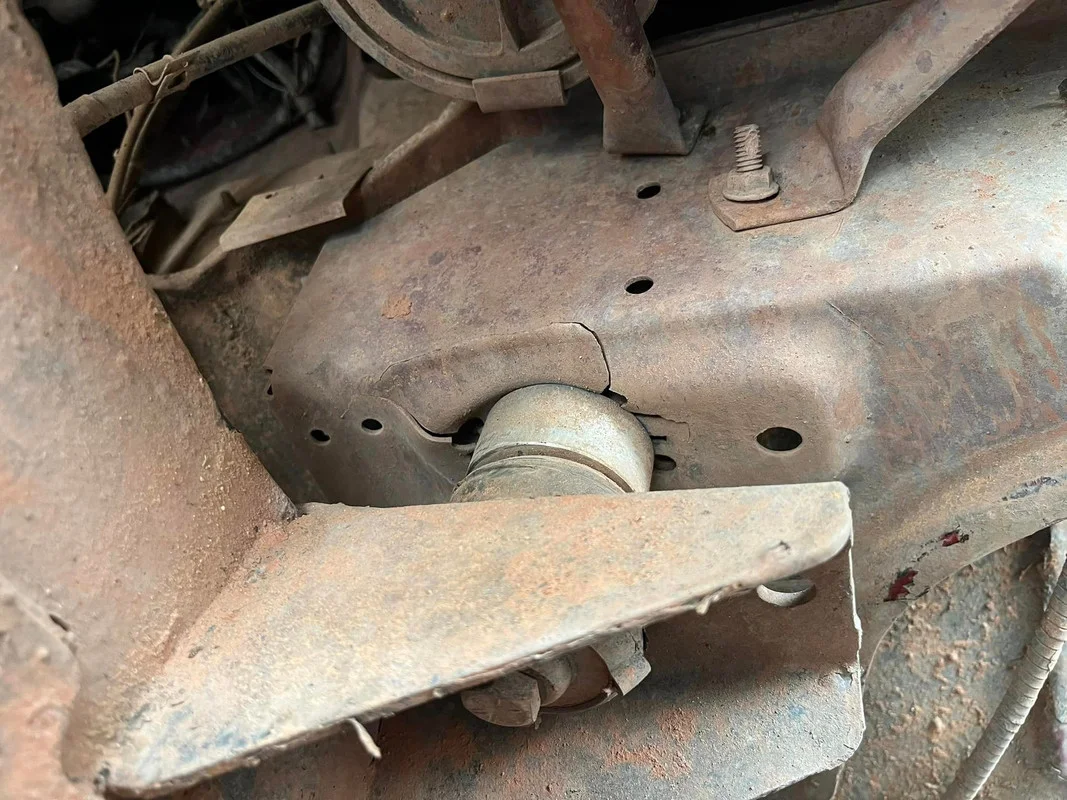

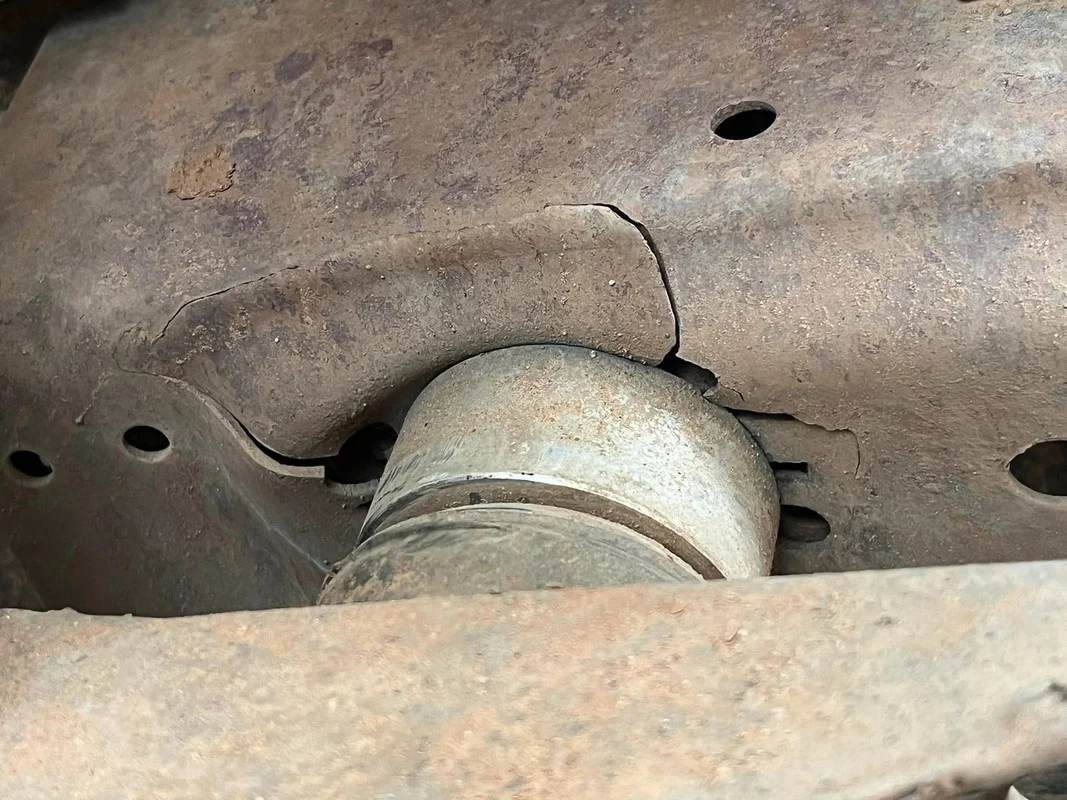

Dang yeah that’s a hell of a repair. Was looking more so to replace the body mount bushings stock height. I already have 2.5 inch leaf spring lift and shocks. I got all the bolts off except two. One I’m still working on getting out and one snapped so I’m going to have to do surgery and drill out very carefully and tap it so I don’t have to cut it out. Still trying to decide on a kit. Poly or rubber. I would really like red poly but I’m all ears. What are your thoughts
Thanks. I just ordered the stock rubber mount from crown automotive with all new hardware. Snapped one boat I need to drill and tap patiently and the one that seems like it’s seized. May try to apply some heat to the bolt to see if it will losen so that I can get the new ones on lol
Yeah, those bolts will get you. Let me guess, either one of the rear mounts or the one just below the footwell?
