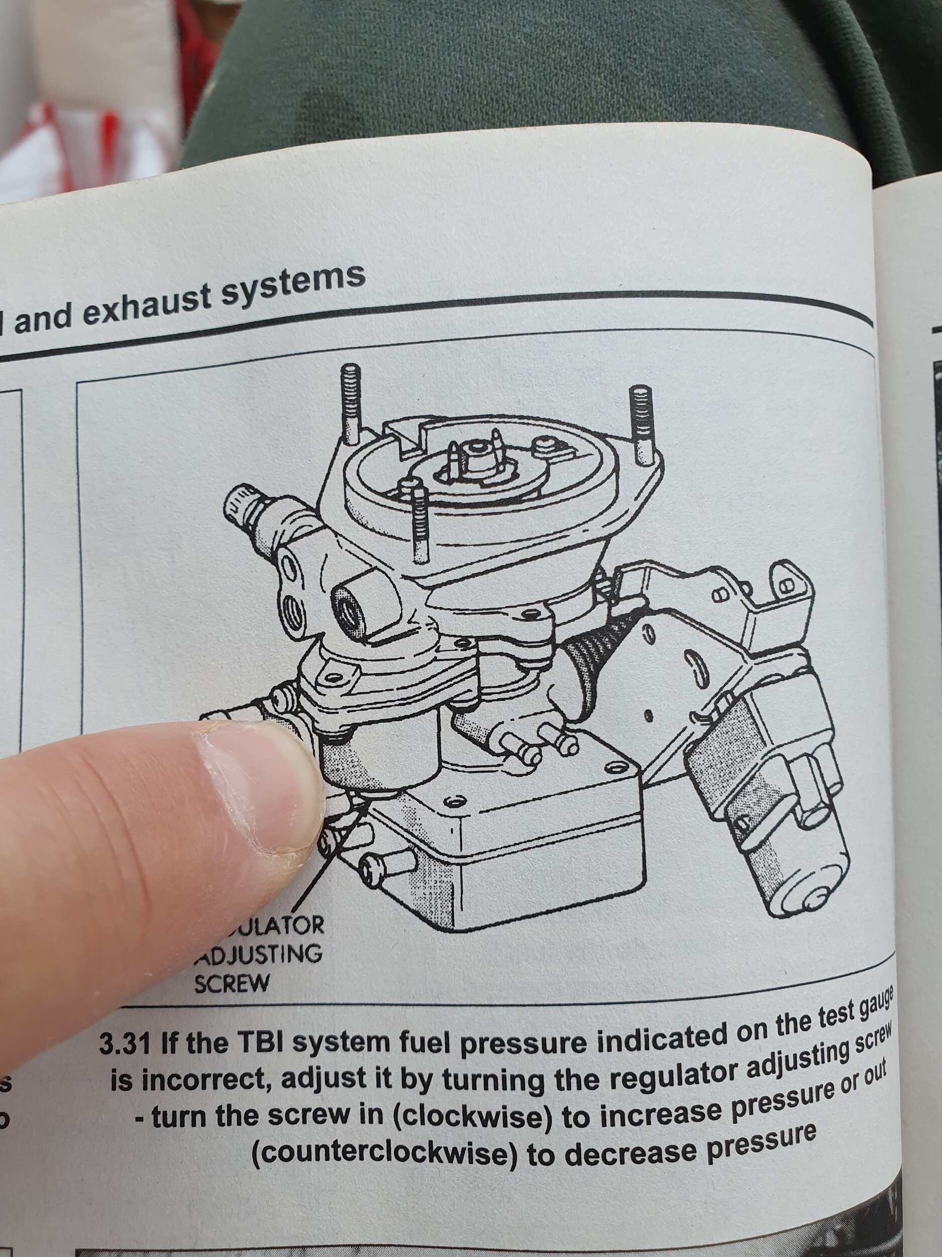

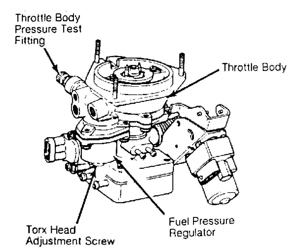

Is this the fuel pressure regulator?? (2.5l 4cyl- 1989)
