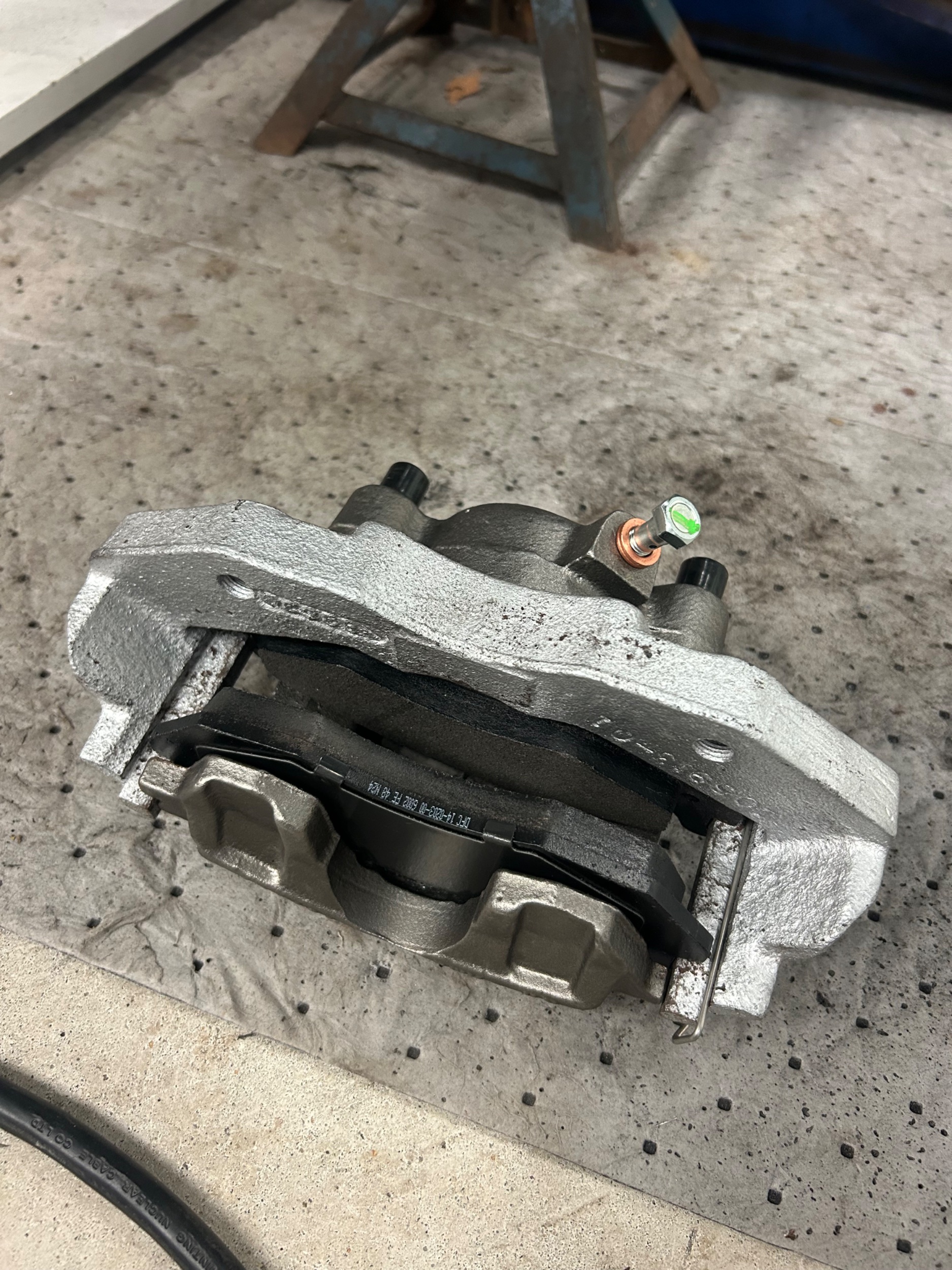

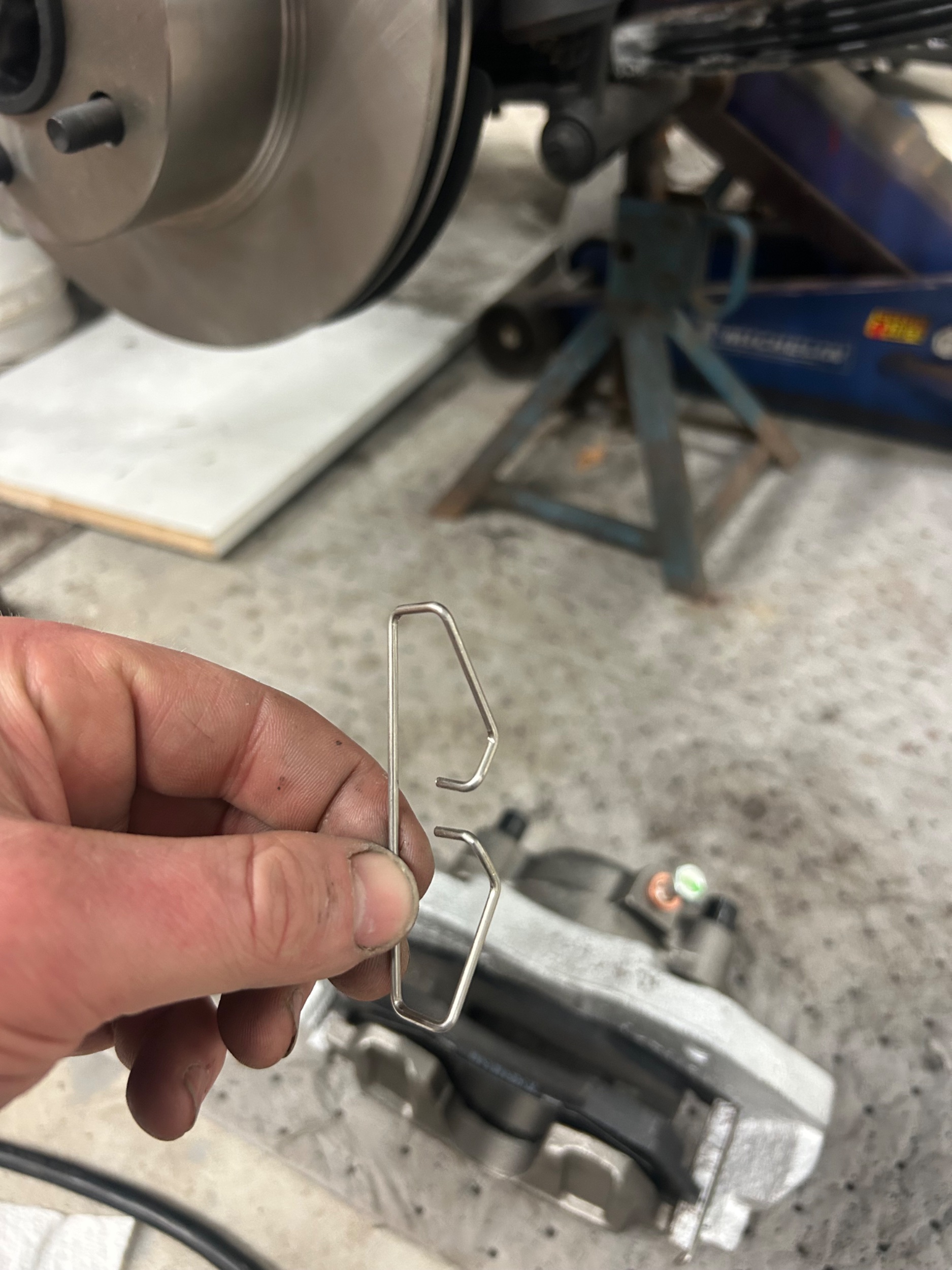

Bought new calipers for my 89 YJ and I’m at a loss for how these spring clips reinstall to the calipers. If anyone has any pictures or could walk me through getting these back in- I’d appreciate it!

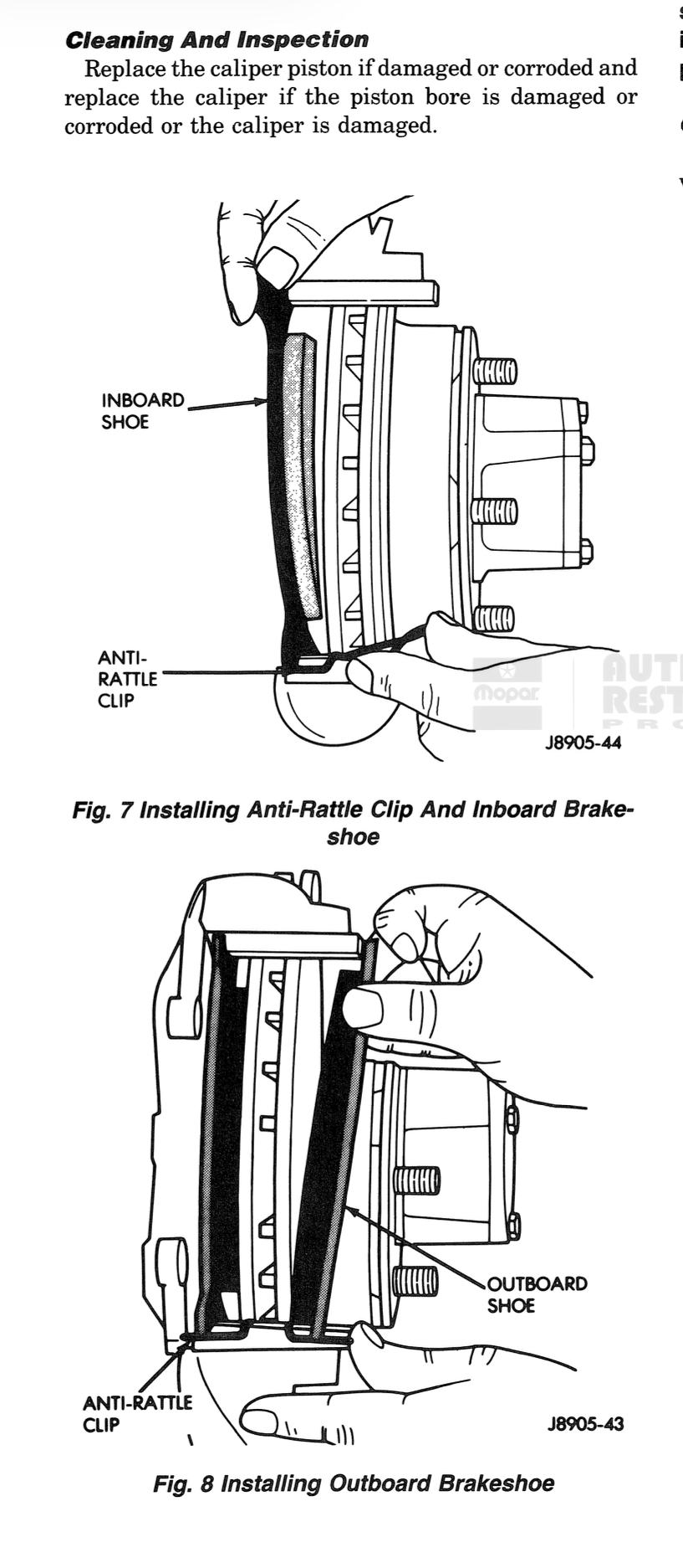

You’re supposed to take the caliper off of the caliper bracket, put the anti-rattle clips onto the caliper bracket while loading the new pads in, then install the caliper over the pads and into the bracket.
This is 1987-1989 specific.
