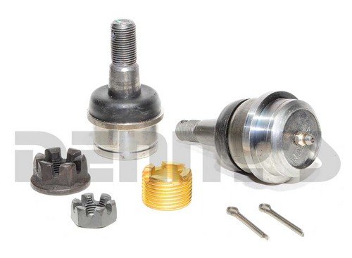

You're talking about the brass- gold piece in this image... I replaced those in my spindles...I cannot remember the name of that specific part, but yeah that's all the same for the ball-joints and those go in the lower spindle and fits 1984 to 2006 Jeep YJ, TJ Wrangler, Rubicon and Unlimited, XJ, ZJ with DANA 30 or DANA 44 front. They all have the same dimensions and taper, you can get the ball-joints in knurled or non-knurled. That's one of my worries as well...is finding one and someone has put knurled ball-joints in it. Definatly going to be inspecting the housings very well before I pay and walk away. Facebook marketplace in my area, people have front axles that are not Dana 30's listed as Dana 30's 🥴. I'm familiar with other years and their features. Maybe the 90's model just don't get the brass piece. Donno, I haven't had to use any of the 90's stuff. Good info though and thanks for the chat Sir.
Yes, they do not use that piece in the 90s models because they started tapering the lower ball joint hole in the knuckle instead of drilling and tapping it for the insert.

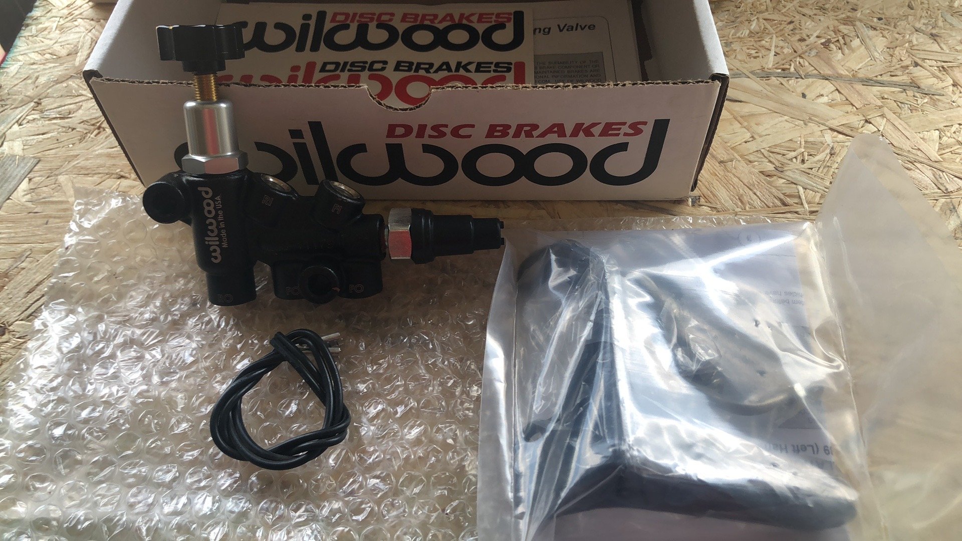

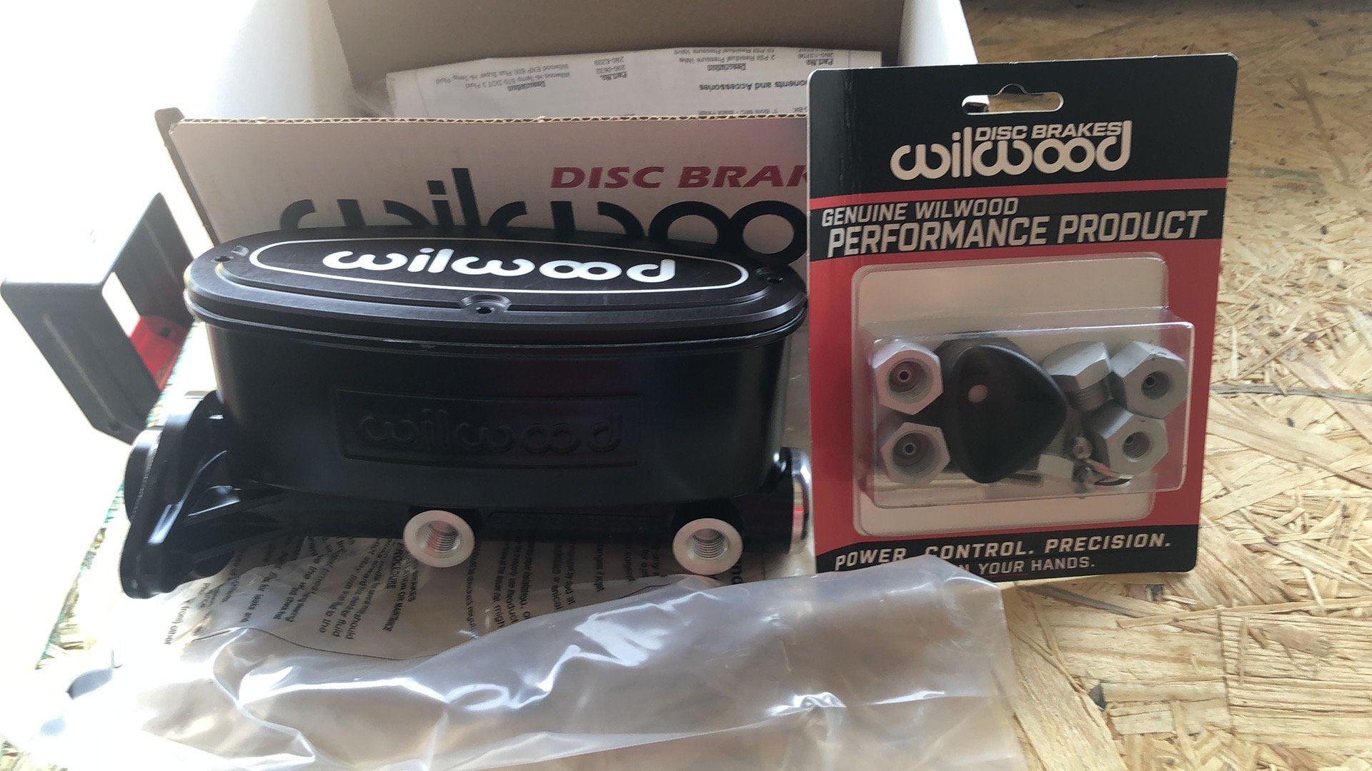

I have Wilwood everything, master cylinder, long braided brake lines, front brake kit, proportioning valve, slave cylinder and this rear kit will be here the 9th. I bought Classic Tube stainless steel hard lines, you just have to remove the shipping bends. I'm not ready for those yet, the fame still need to go to the sand blaster and get painted, but I'm going to install the new springs, bushings and shackles, the rear end and the rear brake kit and install my wheels.
That front kit is a guaranteed fit for 87,88,89 YJ and the TJ needs YJ spindles from those years and then they can install the front Wilwood kit. The video is on Youtube, just search Wilwood Big Disc brakes for YJ Jeep.

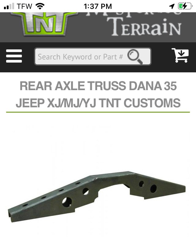

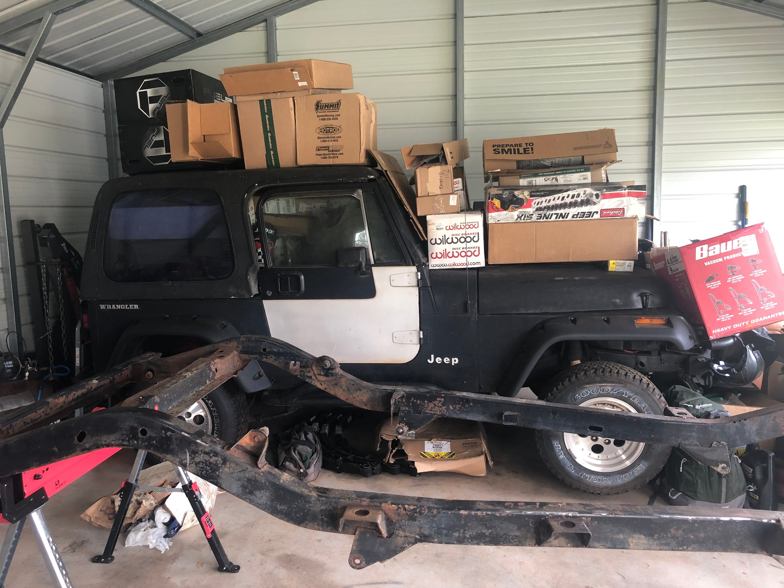

You can see the front kit on the hood of the Jeep, I've not opened it yet. I included my TNT truss, Wilwood master, adjustable proportion valve. i have their 10" braided brake lines too. Parts are stacked in front of the Jeep, under the Jeep, filled the inside of the Jeep and then stuck the hardtop on it ha-ha and stacked parts on top of the Jeep... then the garage was turning into a warehouse so I bought parts into a spare room in my house. The entire Jeep is new... even the tub is getting new parts (floor and water fall section). My engine is being built by Newcomer Racing .... the head is max ported and polished as is the Clifford intake, full MSD treatment, Banks header, forged rods, Keith selected the pistons, I have a Comp Cam 68-239-4 but that maybe changing to one of Keiths recommended cams. Engine should be nasty. Its got all the goodies.
I plan on selling my factory fender and fender wells...they're clean! ... I'll have a few other things to sell to I'm sure.
