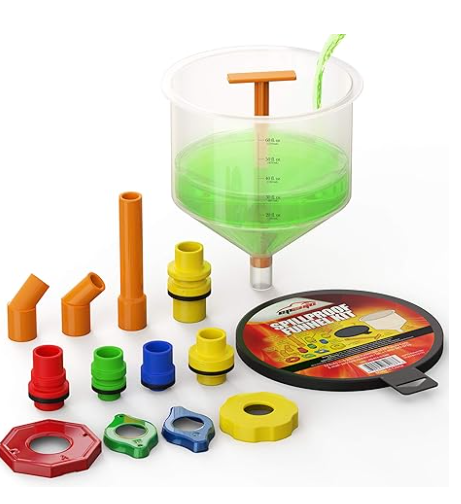

I'll be doing this soon and finally broke down and bought a coolant funnel which helps when filling and spill over.

Thanks for the reply. I actually was looking at that exact same setup. I will flush and refill in the next couple days. My afternoon was filled today with finding a short in the running light circuit. It is too stupid what I found. Some people need not do wiring mods......🤠
