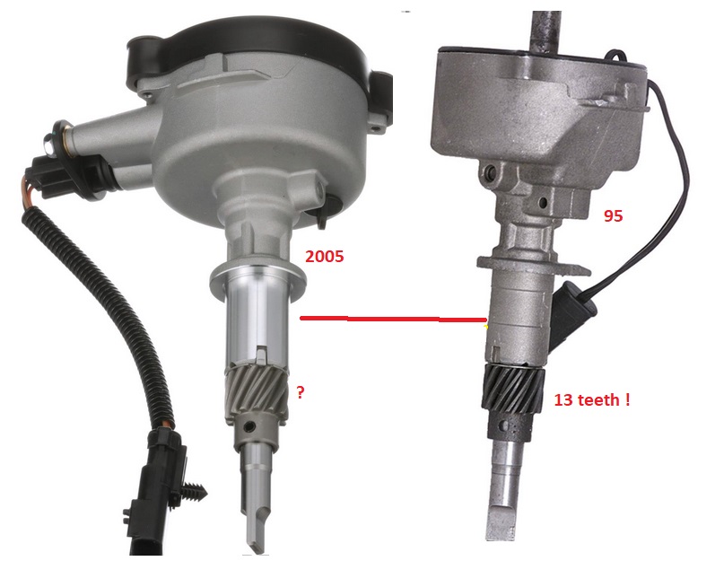

the last engine used fake, distributor ,device (CMP new), that may fits the same hole as the old distributor. THE CMP sets only injector timing.

what car did the 2005 engine come from? ( wrong alternator for sure , )
here it is 2005 , called the cam synchronizer , dizzy hole.
here they are. just one step of many.
