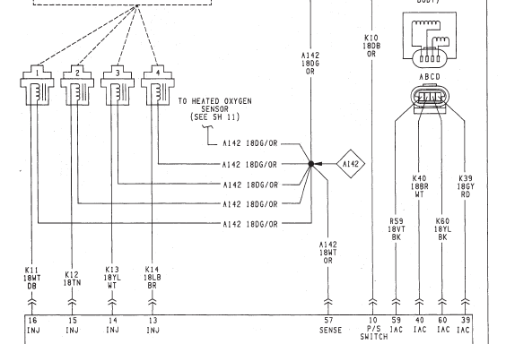

A few times recently, it gave me a check engine light (super surprising). The flashing light sequence indicates code 27 for an Injector Circuit malfunction. It's intermittent.
* The injector plugs are receiving both positive and ground (used a test light). Removing an injector plug will cause a rough idle and an immediate CEL.
* I put seafoam through the intake, independent of this concern, a couple of months ago (four-hole mustang 5.0 injectors have ~50k on them).
* I popped in a new relay into the Auto Shut Down relay slot (no change).
* If I disconnect the battery, it will usually show code 27 prior to starting. The CEL stays off after restart.
Poking around the engine bay while running, I can occasionally hear it drop a cylinder while pushing/pulling on the wires on/adjacent to the injector rail. It is not consistent though. No single push/pull anywhere will cause a reproduceable response. I really do not want to rip into the wiring harness as I'm concerned I could end up with a litany of other issues.

If I was a betting man, I'd almost bet you've got a break somewhere in the wiring harness. I can't tell you how often this is the case and how often it gets overlooked because in many cases it requires doing some serious investigative work and tearing apart the wiring harness.
I don't trust mechanics anymore (it's so hard to find a good one) so if it were me I would figure it out myself.
Thanks Chris! How is this usually done? Would an experienced mechanic take the harness off and inspect it off of the vehicle? Or would they leave it in place and probe and probe and probe?
A period correct OBD1 would tell me which injector, 1-4, is not firing, correct? I'm having a hard time figuring out which one to get without going to an MT2500. Google just wants to convince me to buy OBDIIs until the cows come home.

I had a similar issue with my 95. I went through the whole Jeep when I bough it, pulled the engine, etc. I swapped out the OEM injectors that were nasty with rotted o-rings for a new set of K-suspension 4 hole injectors during the rebuild. It ran great for a month or so and then I began to have an intermittent problem similar to yours. I would lose a cylinder or two and then it would be back. Sometimes I could turn it off and restart and it was normal again. Other times, that didn't work and I'd be limping it back home. I played with the harness while idling and sometimes it would do it and sometimes not.
I had considered one of the new injectors could be faulty and during the rebuild I was very thorough and like you mentioned, I cleaned all the injector connections with good electronic cleaner. I had intended to then hit all the injector connections with some dielectric grease but just forgot to do so. When trouble shooting, I remembered this and went ahead and applied some to all of the injector plugs. In my case, that did the trick and for over a year now, it's been running like new.
Just a suggestion before tearing into the harness as it's a simple task and in my case, fixed the issue. I was at the point that I was ready to open up the injector harness and begin inspecting all the wiring but thus far, glad I have not had to.

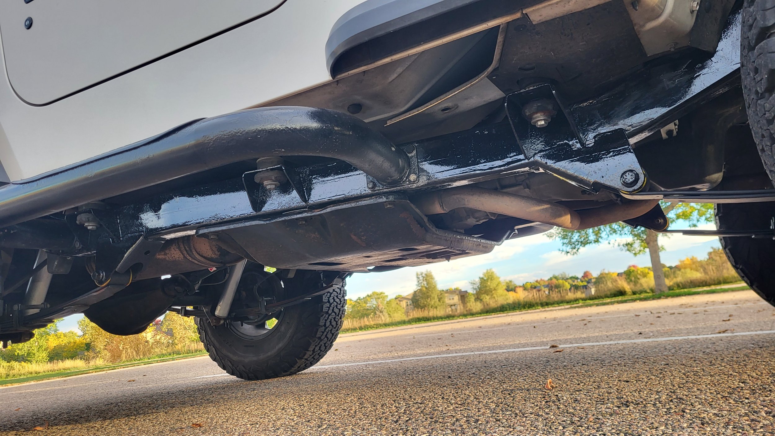

The first time I got the CEL was immediately after dropping the fuel tank to finish POR15'ing the last bit of the frame/replacing the tank skid plate. Nothing I've read would point me to return to the fuel pump wires/plug as the culprit. Agreed? The CEL came on as soon as I restarted though. If a bit of something got mobilized and made its way to an injector maybe? Is this remotely possible?
