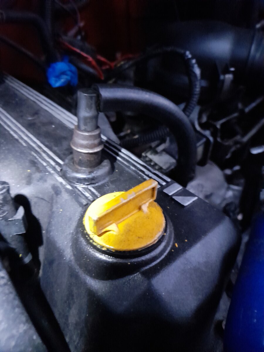

Can anyone tell me the actual name of these two parts on the top of the valve cover?

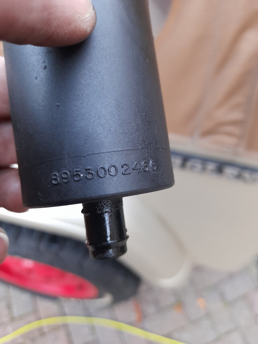

Can anyone tell me the actual name of these two items on the top of the valve cover please. I took them off to see what's in the holes and the rubber grommets are totally shot. I figured these valves?/ sensors? must be ancient and time for a replacement along with the grommets. But dont know the precise name to search for.

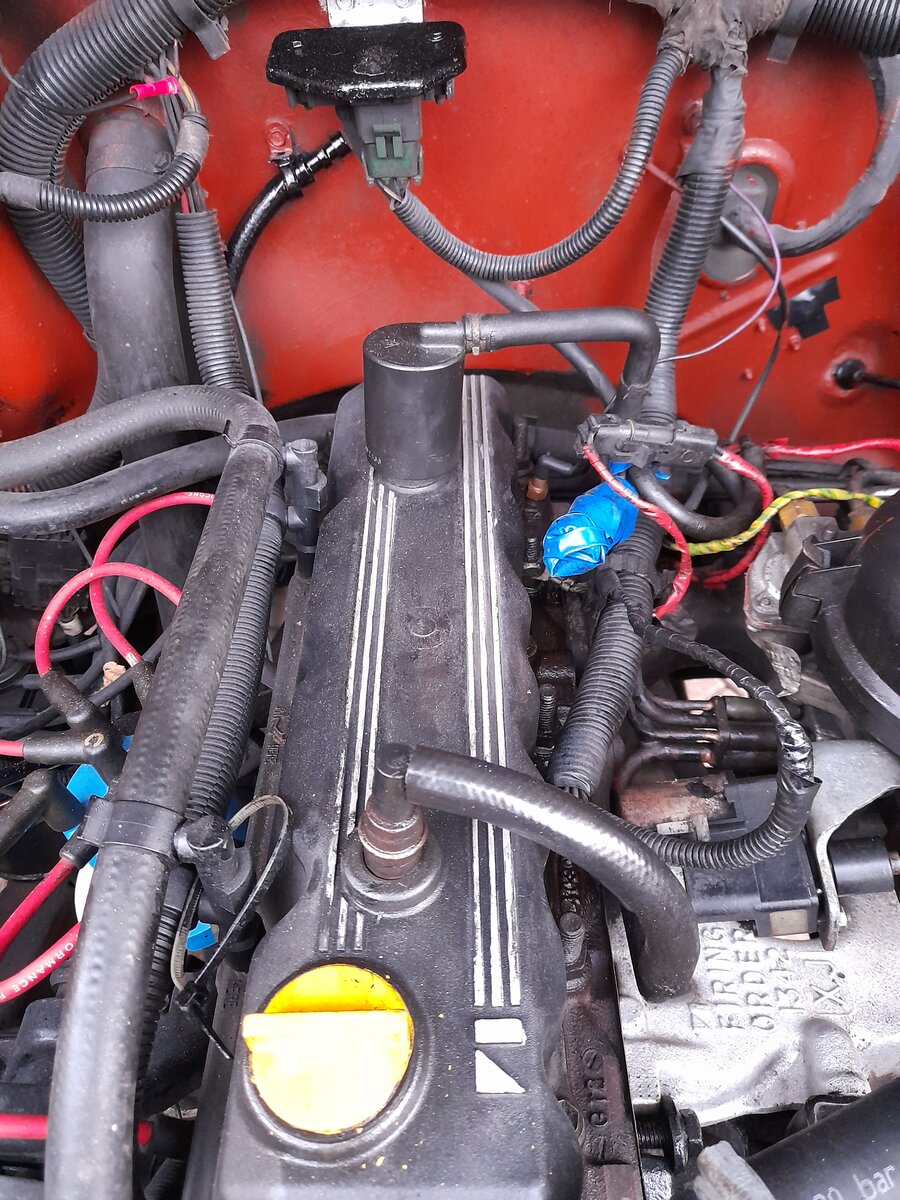

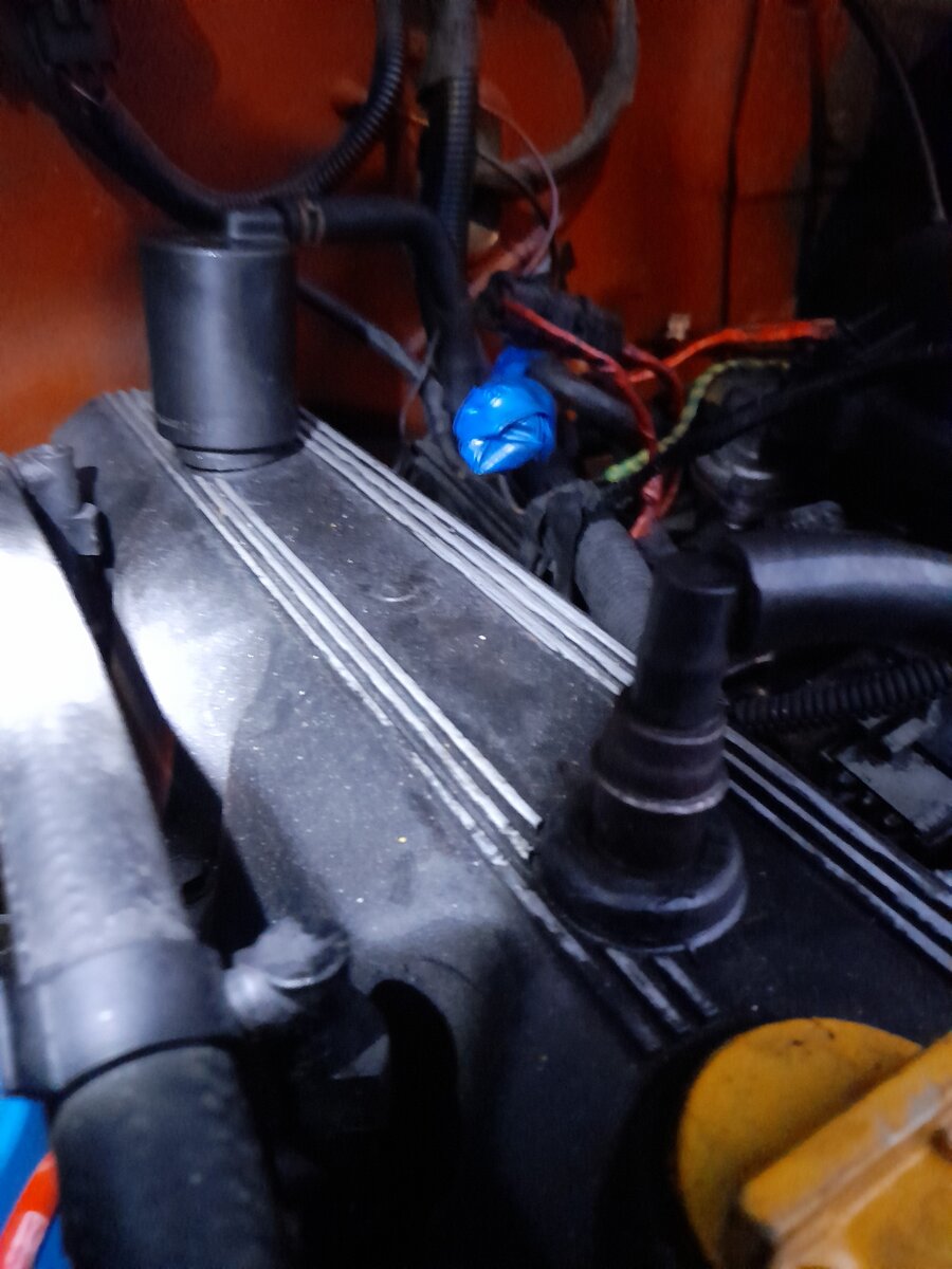

The front one is a PCV valve or "Positive crankcase ventilation" valve. They are typically $5 or so at any auto parts store. You should be able to hear the check ball rattle freely if you shake it a bit. Although my 91/4 cyl is different a bit there is also a rear line like yours. On mine it goes to the air box so it can suck in filtered air into the engine. To prevent a oily mass inside the valve cover there are baffle plates at either hose location. Im guess in on yours it may be a empty can or sorts or what is called a "catch can" the oily mist can accumulate and drain back into the engine. Could be wrong on this one but its my guess.
At any rate DO not destroy any parts that you might think are worn out and easily replaced as some are not by a long shot, like that "catch can" as I call it. Your TBI injection was only used a few years and may prove to be a bit difficult for replacement parts when needed.

all YJ HAVE A PCV SYSTEM 2 PATHS, ONE SUCKS (VACUUM END) AND THE OTHER IS FRESH CLEAN AIR. BY LAW USA FOR AGES.
IT EATS UP THE NASTY CRANKCASE, BLOW BY GASES, SO HUMANS DON'T BREATH IT. END STORY. PCV

the valve is a spring loaded check valve,. they love to clog up, so we buy one or just clean it, (soaked in , acetone solvent over night) most folks just replace it.

that rear PCV fitting is the fresh air end.
that may be 1 of 2 things in that huge tube.
a filter or a baffle inside and some can clog too.
if both ends clog the engine leaks oil out front and rear crank seals.
and more.
both ends not clugged. is a goal.
if clogged it can also push oil and blowby fumes back to the air filter (main) and soak it in oil. not a good thing.
I look at the air filter first.
