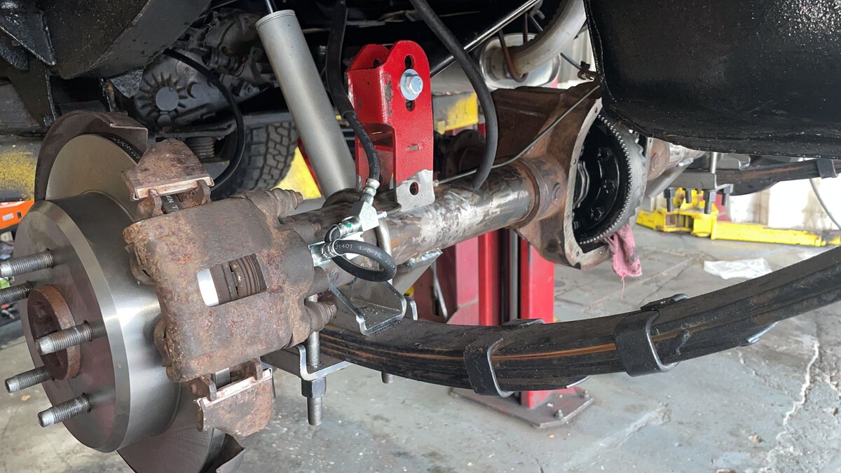

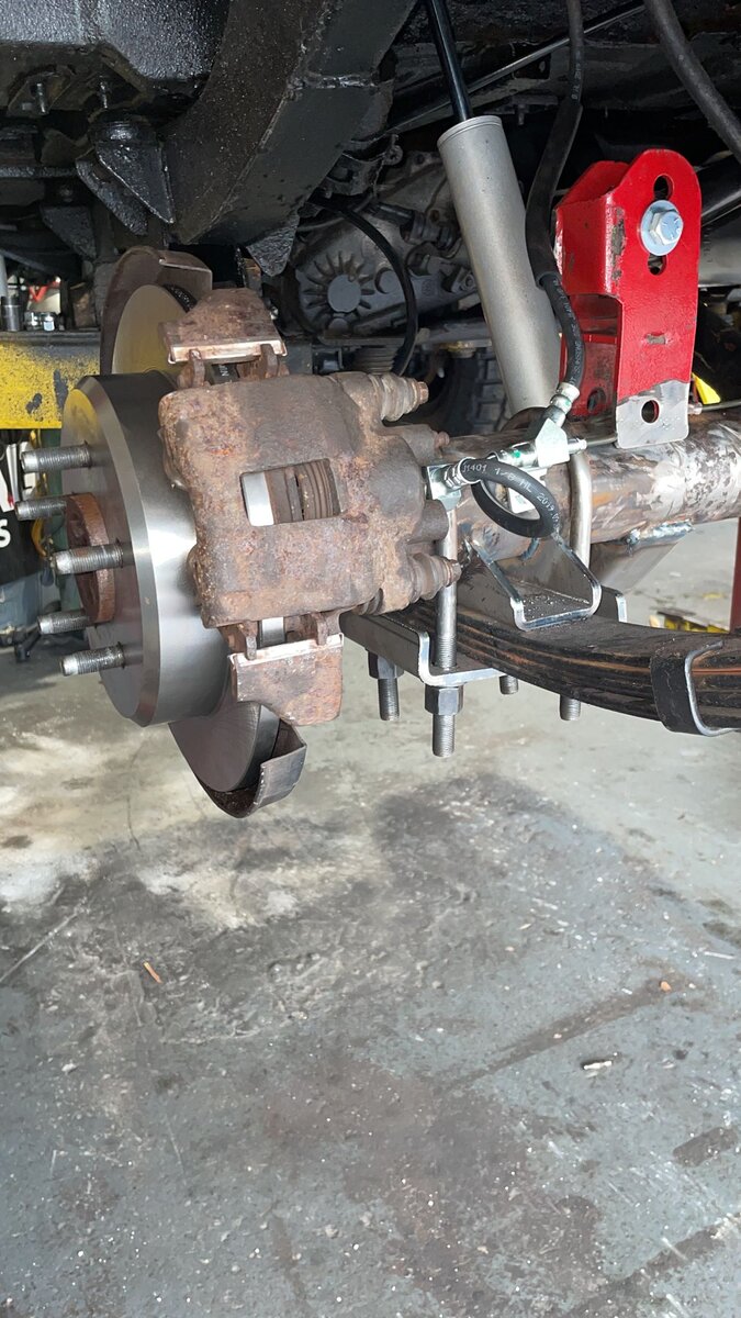

Thanks - apparently the mechanic bled them today and still the same. Here’s some photos he sent me after the axle swap. LMK if there’s any red flags you can see …
Calipers appear to be on the proper sides. Maybe he needs to bench bleed the master cylinder? Not sure but I know it’s possible to have a good setup with nothing but stock hydraulic parts to operate the rear disc swap. Mine is that way and is perfect and it makes sense since the TJ came factory that way in later years.
