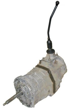

For me the quickest easiest visual distinction is the cast iron midplate on the AX5 vs the AX15. Seen in the photo below it's the dark band in the middel of the case. The AX15 does not use a cast iron midplate and looks silver vs dark.
