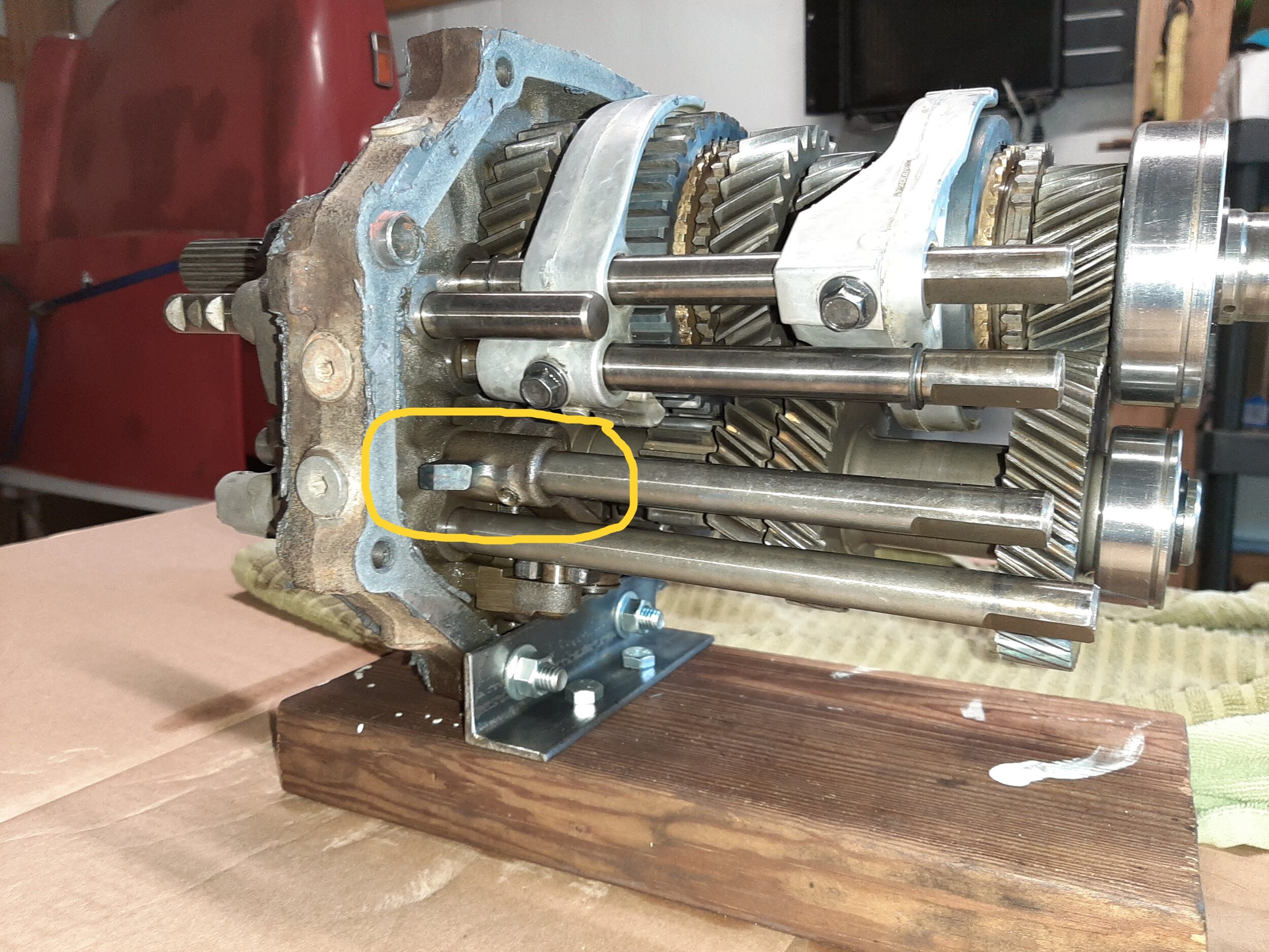

Here is a picture of that cup the shift lever end ball goes into when it's in the neutral position. It sounds like yours is down and to the left. There should not be much play to move that cup around if it's in gear.
That cup does normally move forward and back, left and right, with effort when shifting. Left - right in neutral is easy. That cup is part of an arm that goes to the three different shift rods for 1-2, 3-4, 5-R.

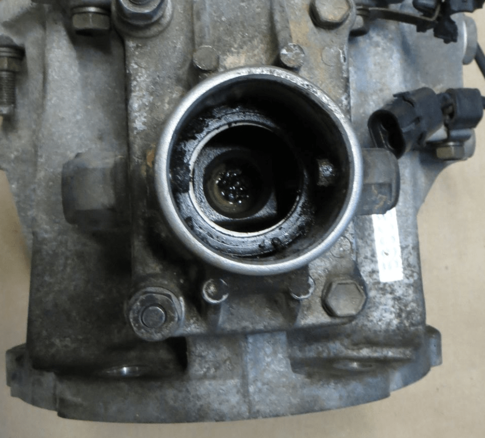

I got a95 YJ 2.5 5 speed it got cold and tried to take it out of reverse and the shifter moved but it stayed in reverse how do I fix the problem
This happens and here's the fix.
This is what you're looking for inside the hole when the reverse switch is removed.
