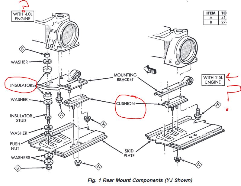

if the engine/tranny motor mounts fail they move excessively and against old hard boots, and it jumps gear. (see both are bad and the effect is worse)
use a lever to test mounts, mounts can beat them self to death this is first. (or ask shop to do that)

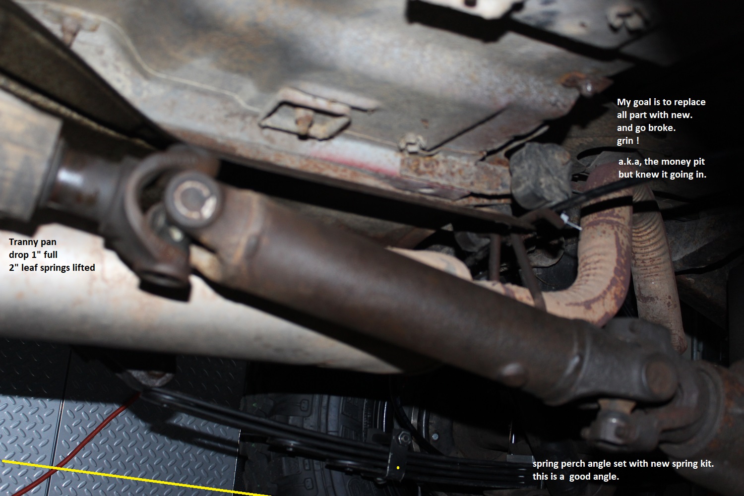

also the rear prop shaft, if the pinon angle (done wrong) is excessive the rear of the trann/xfr case vibrates violently and can pop the gear, again take the boots off. the box. even drop the 4wd lever.
what is your rear pinion angle?. if not done right it will be a huge problem. is the transfer case
pan, have the 2 drop rails there? or not./?
many jeeps the mount on top of the pan just above, is a wreck, and is weak, and small./

with the boots off no kidding you can see if the tranny is jumping like mad, for sure 1 drives and 2nd watches safely
