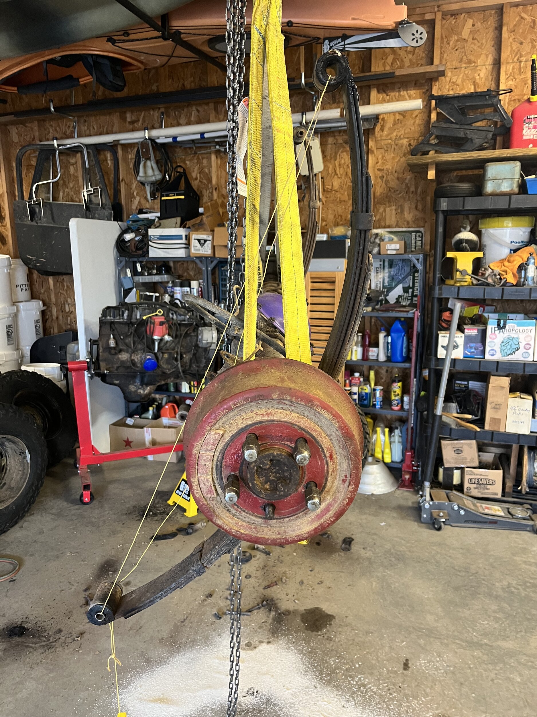

Pulling a cord from spring eye center to spring eye center and measuring down to top of leaf spring at axle is 7 1/2". There is no weight of course, but what would be the opinion of the lift kit experts on the amount of lift over factory? When it was on the jeep my best guess was 4" but I could not get a good measurement.
From the looks of the spring arch Id guess 2.5" lift. I was gonna say post a pic of the jeep sitting on the ground but I can obviously see its in many places scattered thru the shop 😳
Thanks Gilaguy, when it was all together it was hard to tell and my measurements were based on using a tape measure and eyeballing from spring eye to spring eye. It also had a 3” body lift and 35’s, so measures from the ground up were hard for me to estimate based on what stock would be.
