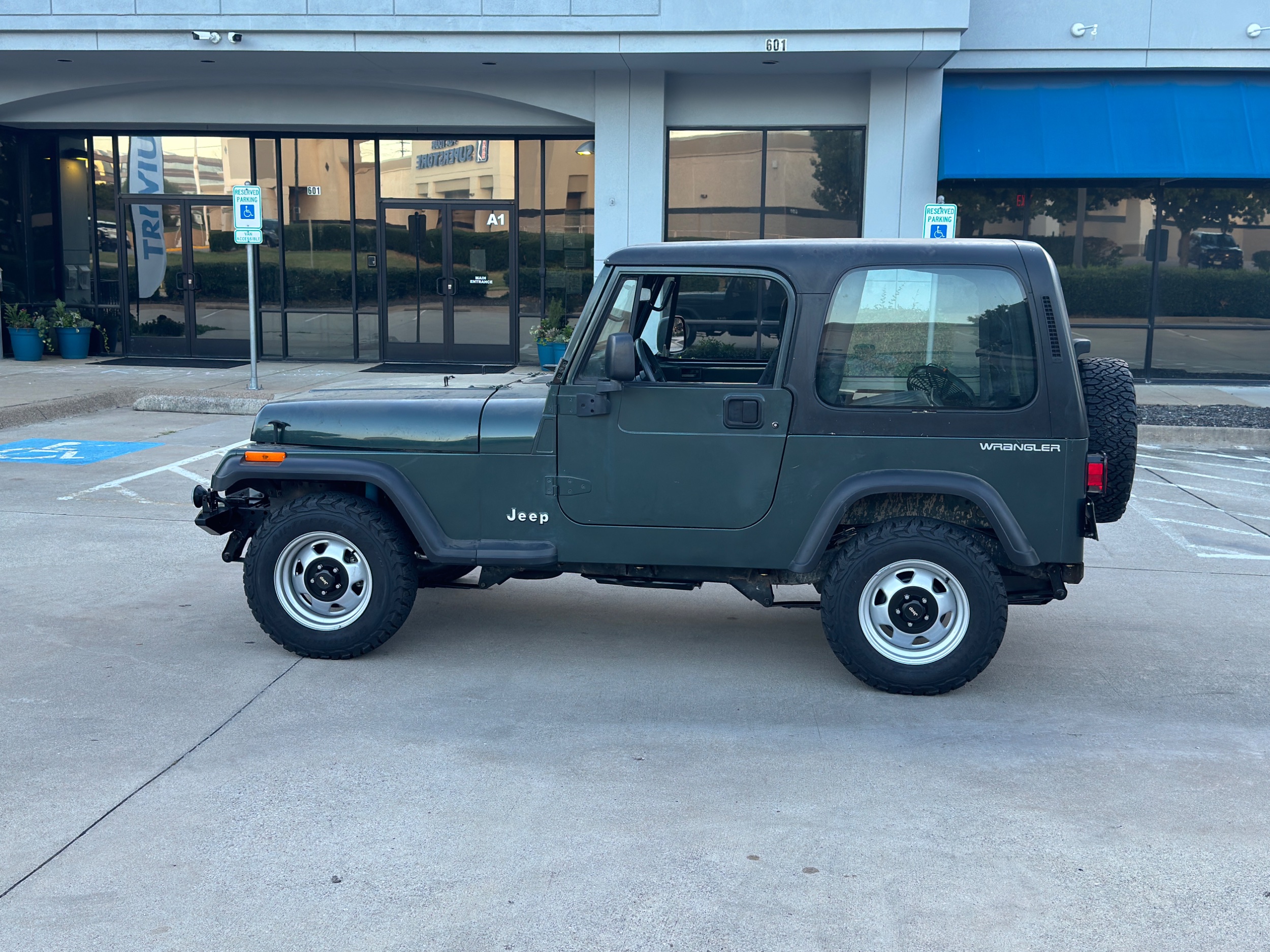

I'm wondering if a set of 245/75R16 will fit beneath my stock 93? Or be too much tire.
The reason I was considering this size is, to my knowledge the shortest hight (30.5) with a sectional width (9.7) and will still fit the 8" wide wheels.
Thanks. The 245s may work but that’s basically a 31” tall tire. Will be a little tight unless you add a body lift or small suspension lift. It’s tough with them being 8” wide; not a lot of tire sizes for 16” that are wide enough for a wheel that side and also not too tall for a YJ.
That's just it, it's equivalent to a 31" tire.
I'm not sure what the 03 TJ Tomb Raider used for sneakers, but Chrysler must have started lifting the TJ's higher than they did when they built the YJ.
Didn't really what to start doing body or suspension lifts at this age, Especially Due to the fact that you just don't see many factory original 93 YJ's in the condition mine is in for the N.East
So I just looked up the stock Tomb Raider tire and it turns out they ran a 245/75R16 from the factory. The sight that had that information also gave some other recommendations for + or - 3% sizes.
One of the sizes recommended is a 255/70R16
That would possibly get me a tire size of 30"x10"
If I can find a good off-road/on-road this might be the ticket.
Is there anyone else familiar with the 255/70R16 tire size?
