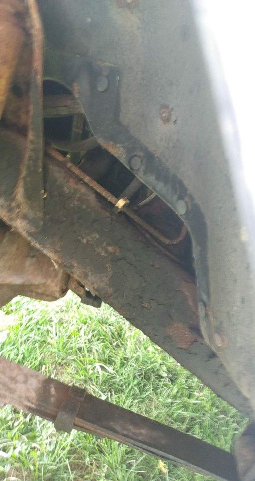

Hi, new to the forum, just accidentally posted to the wrong forum, so not off to a great start lol. I'm looking at a 93 right now, but I'm concerned about the rust. Advice?
Any rust holes…give it a poke with a screw drive in a few spots to check. Also check the tub mount locations to see if they are having issues. If the frame is questionable pass on it.
From the pic it dont look to good. Look inside a couple of the frame holes or stick your finger in one and see/feel if its worst which it may very well be. Also between the skid and frame is typically a bad spot for rust or failed skid inserts.
