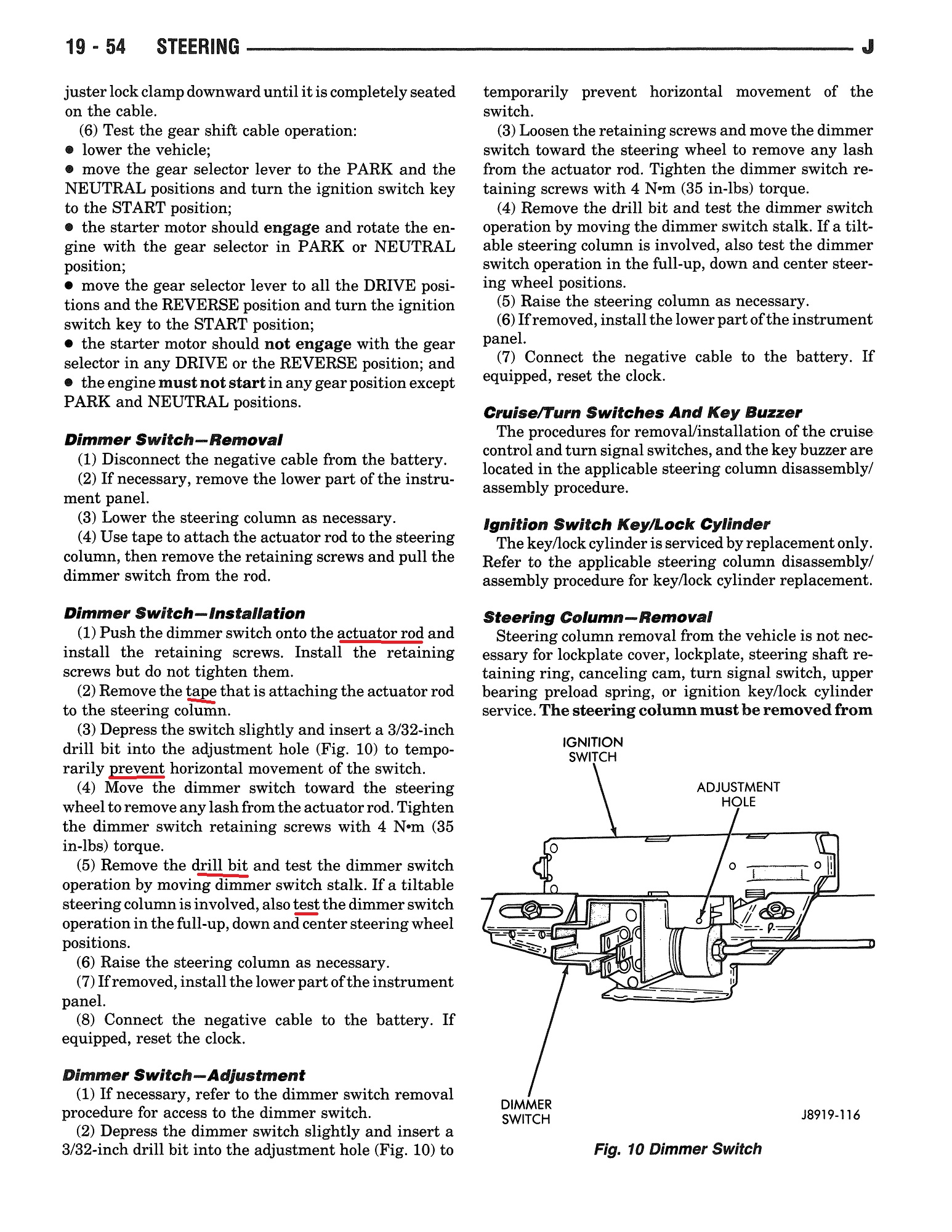

chapter 19 page 54.
titled ,DImmer switch.
the rod connection is covered. here.
extract the page for your below
as you can it must be put in correctly using drill bit. (or equiv)
