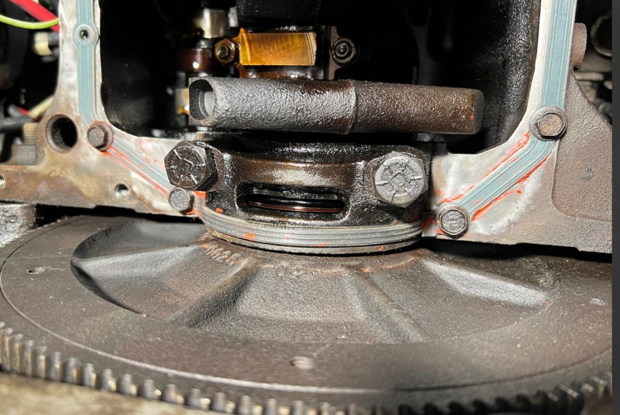

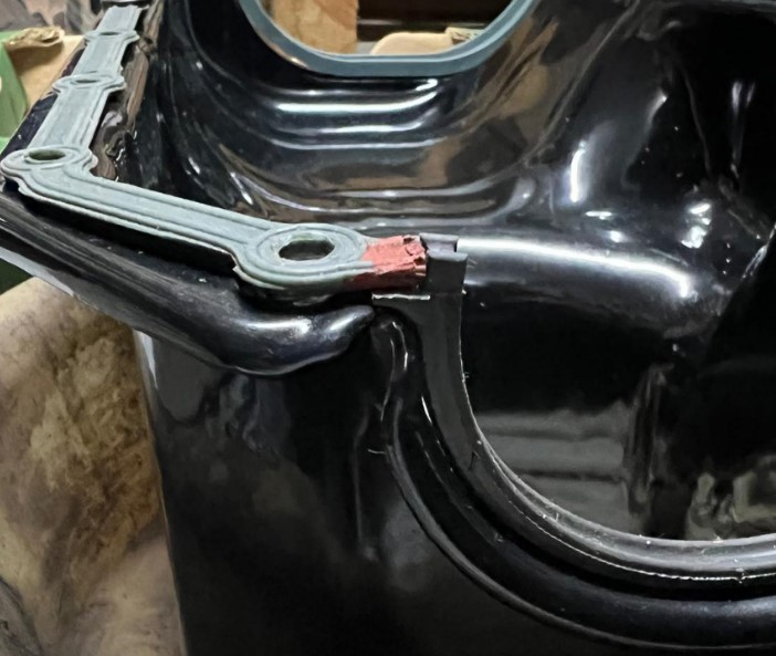

Here’s another picture of the section that doesn’t fit.

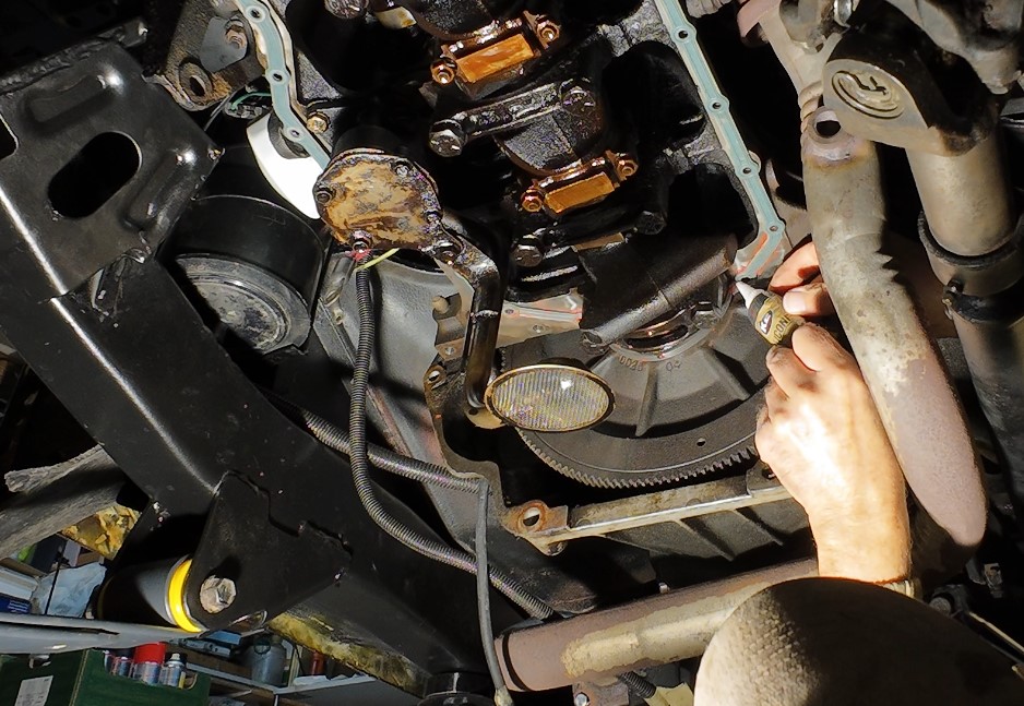

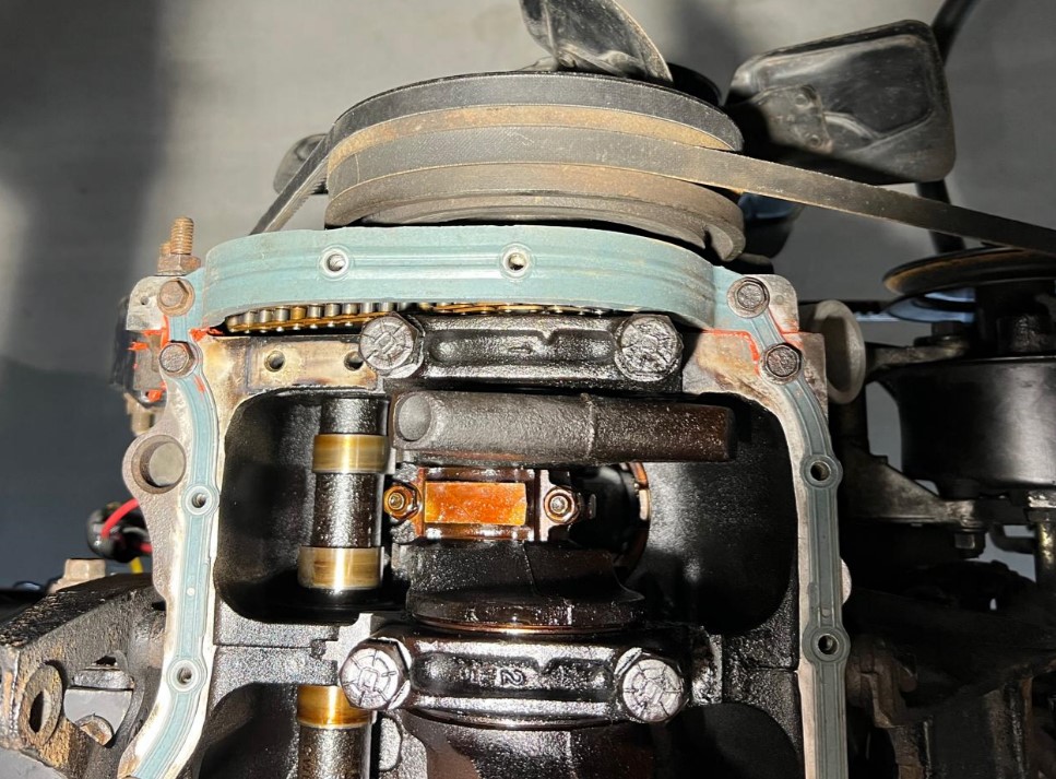

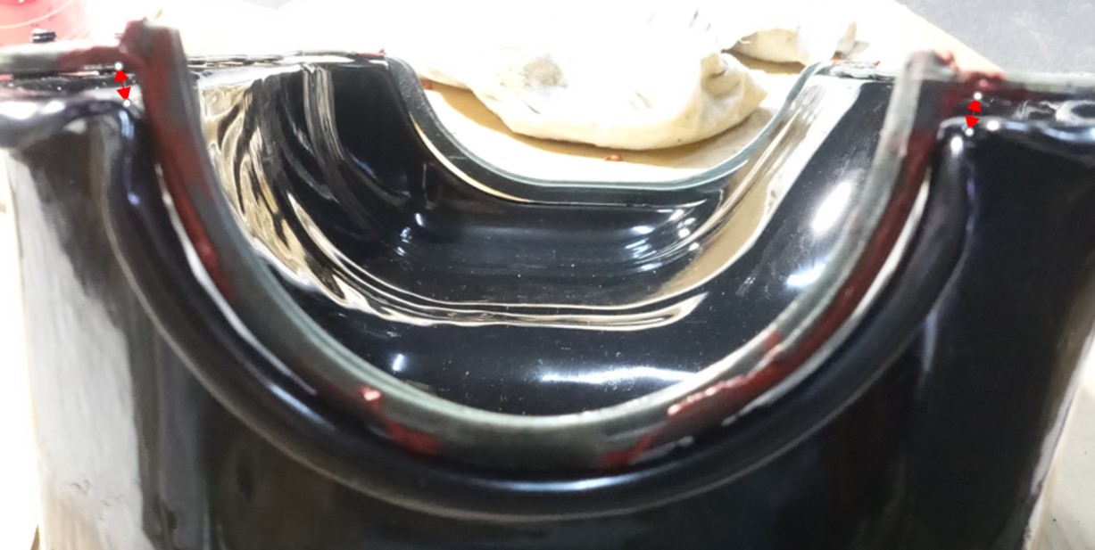

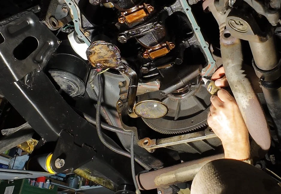

In any case, I managed to fit the gasket parts successfully and bolt on the oil pan. With a bit of patience, the installation turned out to be pretty straightforward:
  • I cleanly trimmed off the overly long section and cut it flat enough so that the two parts (the curved piece from the 4-piece set and the rest of the gasket) fit together with as few gaps as possible.
  • I glued both parts to the engine block using RTV and smoothed out any excess.
  • Let it cure overnight.
  • The next day, I applied a bit more RTV at the joints between the two gasket sections.
  • And the following morning, I bolted the oil pan back on.
Here are a few pictures of the process. As mentioned, for now it looks like everything is sealed, though of course I can’t make a final judgment yet…
