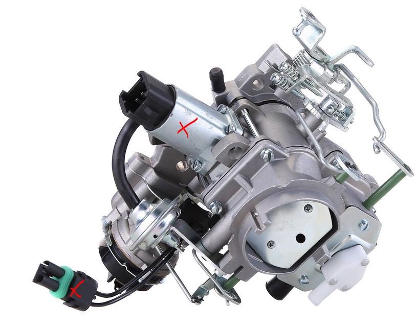

see 1 page here, on BBD carb
ever do a full tune up, spark and all filters.?????

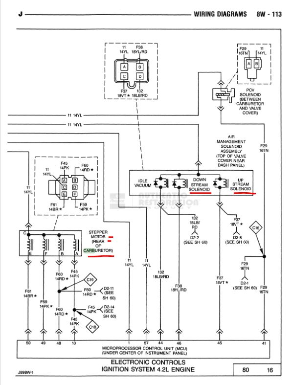

x = stepper motor
this electric feed back carb C2BBD
I see many carbs used, this but one.
