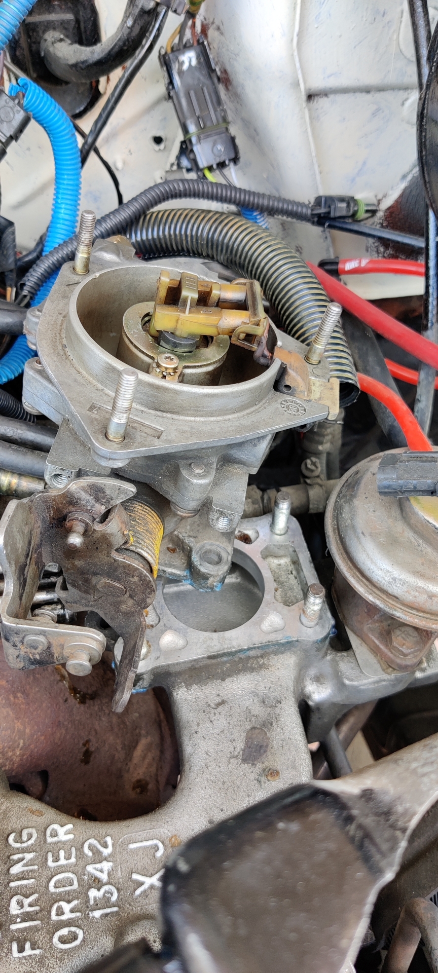

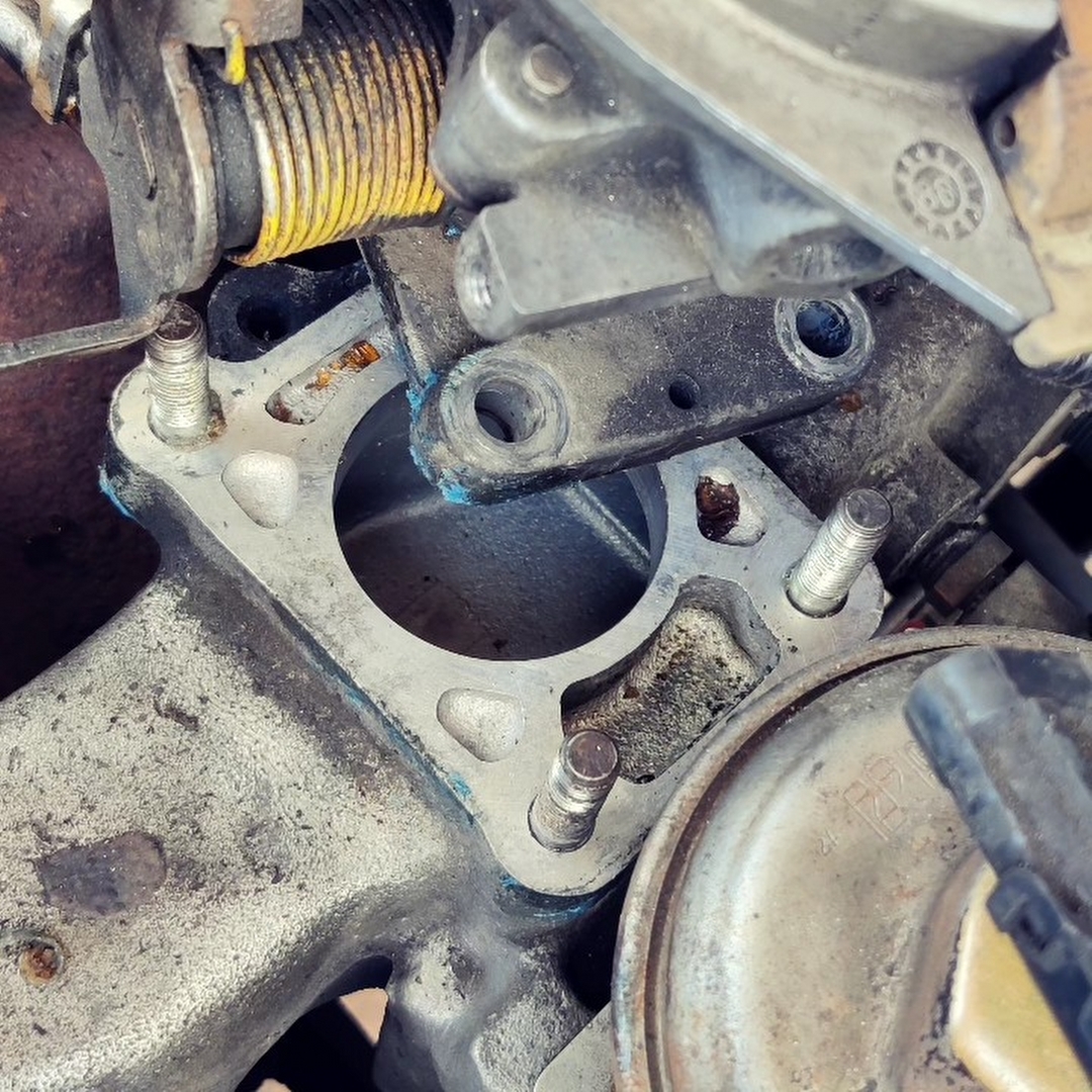

Hi from the UK.
I took my TBI apart on my 1989 2.5l to resolve a vacuum leak between the TBI body and the intake, the paper / card gasket was virtually gone, so the whole thing whilsted at high speed!
I replaced it with blue sealant we have in the uk, lightly spread over both surfaces of the TBI and the intake, torqued it back up and let it 'heal' for a couple of days before taking it out. Never had a problem again in that regard.
These are the only pics i have of that little job - may be of some use?
Cheers!

Ok, that helps. I see how it's mounted now.
