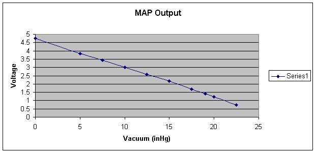

here are the mAP readings
i made nice exel graph. as vacuum drops as you near WOT The hg goes low and voltage rises to 4v or more. I made this off my JK.
vacuum is about 20 at idle and for SURE
NOT BOUNCING, oops a vacuum gauge finds that.
