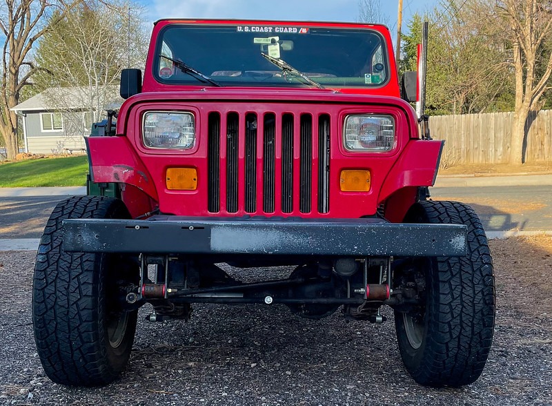

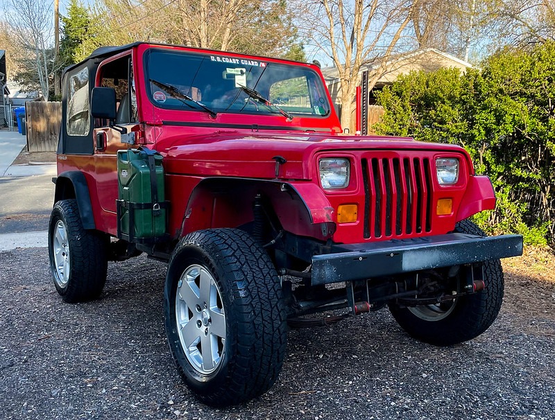

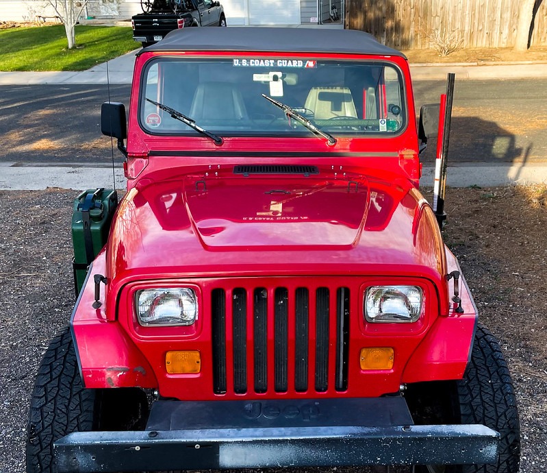

Hey guys, here is my Wrangler 2.5L build.
First Mods:
1, Jerry Can with mounts
2. New master/slave cylinder
3. New steering shaft
4. New Dizzy cap, wires, coil, spark plugs
5. Rebuilt front end
6. New air intake
7. New Soft top (Rampage)
8. New driver's floorpan
9. New Kenwood Stereo
10. New Sony 3-way dash speakers

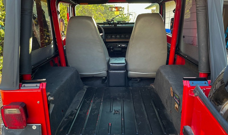

11. Floors painted with bedliner, carpet cleaned and re-installed
12. New Hankook Dynapro 32" AT2's
13. New take-off 2010 Rubicon 18" Wheels
14. Hi-Lift with mounts
15. Midland GMRS Radio with RAM mounts

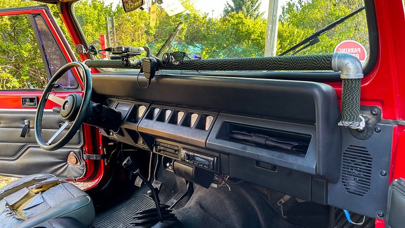

16. Dash accessory bar
17. Fender trim (too much rust)
18. Billet 1.25" 5x4.5 to 5x5 wheel adapters
19. Re-welded stock carrier with new 5x5 pattern
20. New engine mounts w/bushings
21. 36 Tooth short-shaft speedometer gear
Next Mods:
1. Posi-Lok system for front axle.
2. Waterproof subwoofers
3. Offroad Lights (considering Hella 500)
4. Winch and winchplate
5. Engine overhaul at 140k miles
6. Clutch replacement at 140k miles

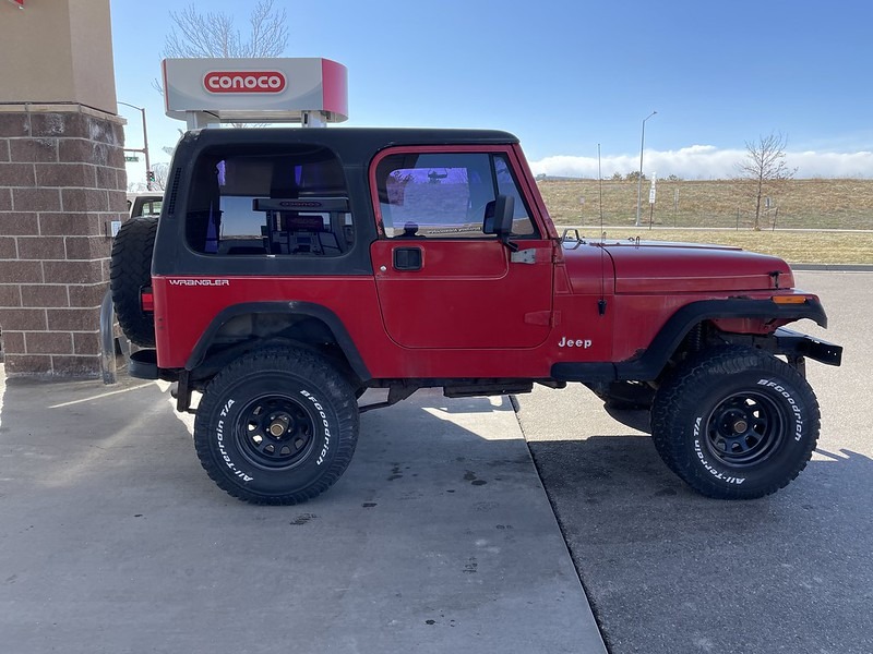

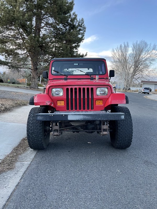

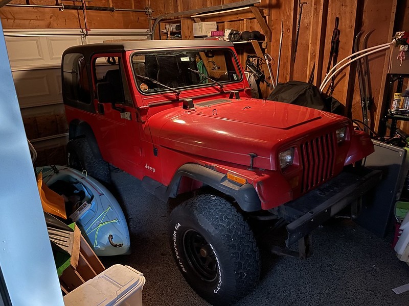

Original Photos: (Day 1 of ownership. 4.5" lift, steering all over the place, woof)

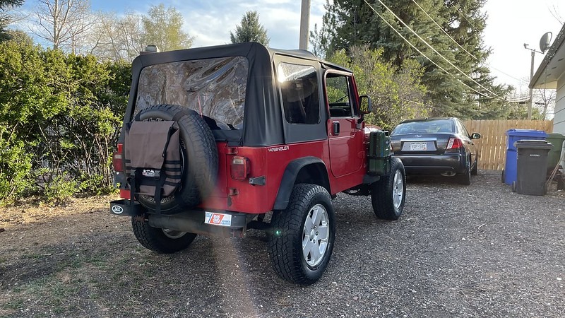

Most Recent: (4/29/2021)
