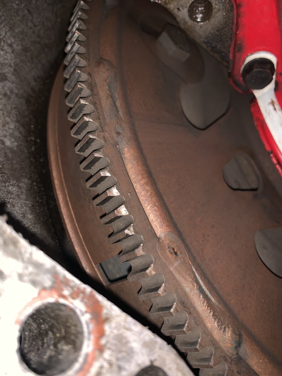

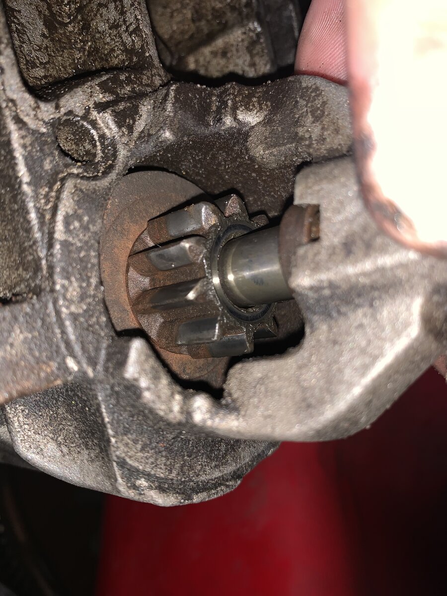

Hi all,
New to the forum world and was wondering if anyone has had to replace their 2.5L flex plate before? This all started when one day the Jeep had rough sporadic starts. I've previously dealt with a bad PCM so I thought nothing of a rough start - and considering its a jeep, it didn't concern me as much. Since then the starting has become a real issue - rough starts almost every morning and I am pretty sure that my ring gear is becoming warn on the starter mating side (see attached picture - I have included a picture of the starter as well for reference). My main questions are: What is involved in this repair? Are there any additional things (rear main seal, throw-out bearing, etc...) I should be replacing since I will be in there? Any tips or recommendations on transmission maintenance since it will be out of the jeep?
Thanks in advance for your help.
To clarify a "flexplate" goes with an automatic transmission. A "flywheel" with a stick trans. Unless my eyes are playing tricks on me,old age, you have a automatic based on the flexplate pic. . Every flywheel Ive ever seen was solid which is where I get my thought. Some vehicles use a replaceable ring gear. Take a good steel chisle and in a valley between the teeth a few good smacks with a BFH and it splits the ring gear. Freeze the flywheel and heat the new ring gear and quickly drop it on and wallah, your in business. In your case the ring gear is welded to the flex plate or flywheel if im wrong here. The starter looks ok but inspect it closely and there are some ground up teeth on the ring gear. Regardless, if your gonna pull things apart, then yes, fix what you can afford while in there as opposed to doing it again sooner than later if leaks show up from the rear main etc. Same goes for a stick trans. New clutch set up is worth the investment if your gonna tear into things.

Also you need to define "rough start" Is the starter grinding or clunking like there's missing teeth on the ring gear or is the engine starting but running rough?
I see in your profile you have an automatic transmission and that does look like the flex plate for an auto. No clutch so no throw out bearing for a clutch.
Reactions: Connor_Wagner
So its a bit hard to explain but the engine itself runs fine after start up. The starting itself - and problems associated - vary from start to start. Sometimes there's grinding on the start, like the starter gear isn't engaging properly or skipping over worn or broken teeth (sounds like the engine is sputtering or backfiring while trying to start) - though I didn't see any when I was inspecting the flex plate. Other times the starter just stops cranking in the middle of the start sequence and whines as if the gear is stuck and not engaging the flex plate - spinning freely.
I have had the torque converter as well as some other parts replaced after my trans pump blew out in the past but will be putting in a new rear main seal when I attempt the job.
In the middle of the pic you can see what looks like some ground down teeth. I wouldn't think thats enough to cause a good working starter to no engage the flex plate, but if there is a bad enough burrs on the gears edges then perhaps its preventing the starter from engaging 100%. May be a short term fix if it even works for you but replacing the starter may do the trick. Nothing like paying a shop a bundle to do the trans and then having to pull it again shortly after due to this. Worst case is the new starter will get messed up after a while.
That's a great point. I wonder if replacing the starter gear might even be a cost effective short-term solution until I can get the funds together to replace the flex plate and everything else. I suspect this will become a horseshoe nail story and I will end up getting more than I bargained for.
Im thinking its an internal issue with the starter bendix. From the pic the gear looks good but if its not engaging right due to internal wear that whats causing the problem. The bendix pushes the gear out to engage the ring gear. if its worn out it wont work right. A new starter is about $65 on rockauto. Might be worth a go ya know.
