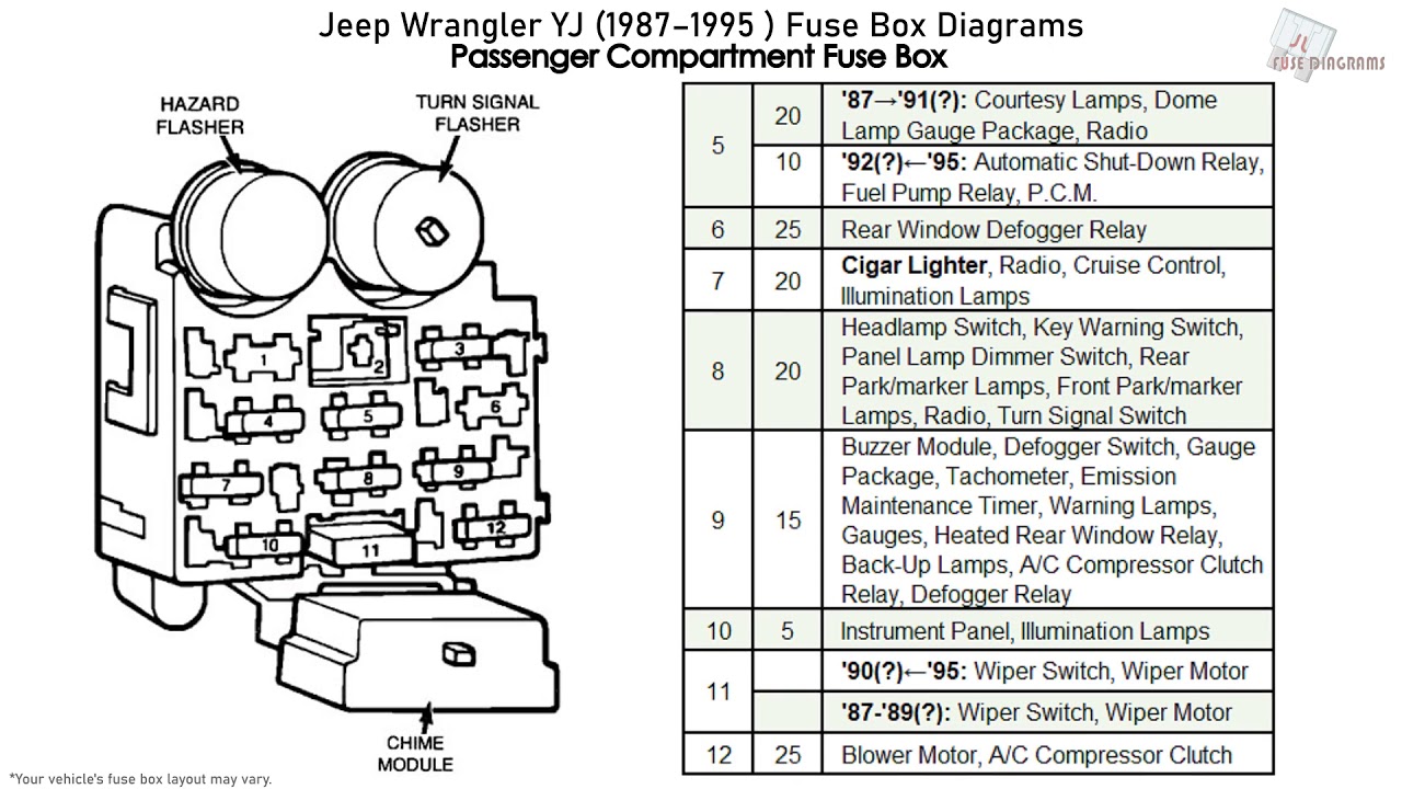

I have been through this......Note number 10 on '92 and up and all that it controls.................
