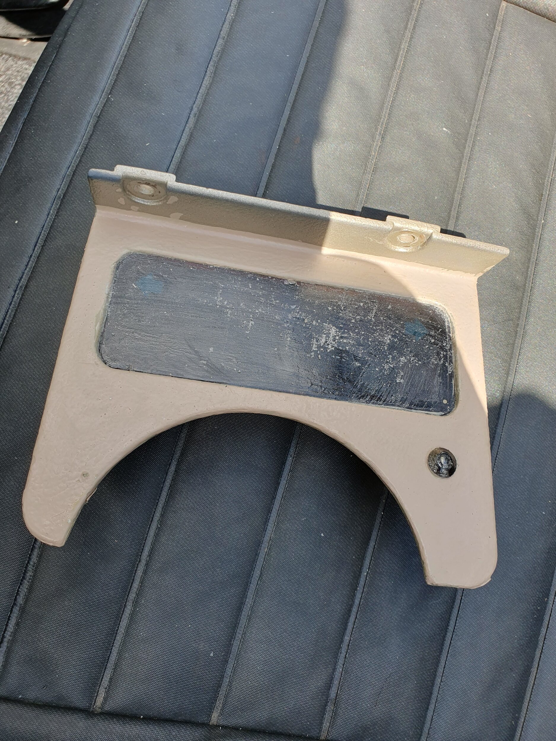

Hi all, pop quiz!
What the blazes is this thing called and can i buy the see thru plastic screen bit?
Mine is crazed over and almost pointless.
Thanks all!
BEZEL, Warning Lamps
5CN7 6LTB Spice
5CN7 6LXA Cinder
Only complete part, see-through plastic is not available separately. Looks like being covered with clear paint. Maybe try to get rid of that paint first.
Excellent thanks. Yep, the clear laquer was me trying to fill in the scratches. Sort of worked , mainly didnt haha. Now just going to replace it with new/ 2nd hand. Thanks for the numbers.

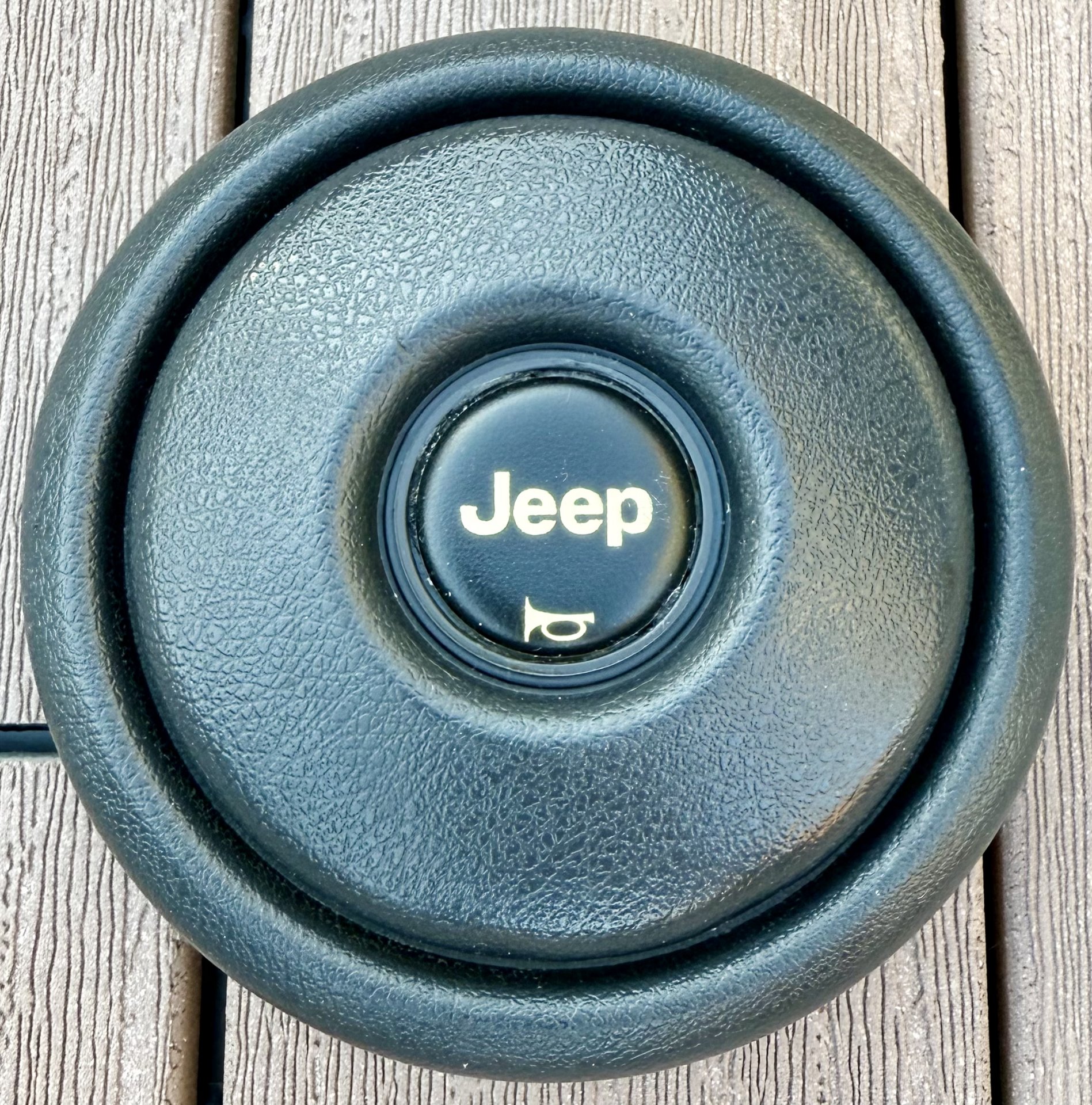

You can try fine sanding, and then clear paint, but with spray. Did this with a scratched Jeep logo on the steering wheel center and it worked well. Five layers of clear spray coating:

Copy...that lens bezel online should be the correct one. I believe the difference between the 87-91 and 92-95 was the location of the 4WD indication lights. Your bezel has the indication in the lens, the indication for 92-95 was located in the first of the four center gauges that are above the environmental panel and radio.
You're spot on Chief, the 4WD light is indeed on the bezel. I always wondered what the gauge was for on other YJs. Thanks. (My 4WD was not working when i bought it in '22 and only this April a mechanic fixed it and did some stuff with vacuums etc. The light came on when he put it in 4WD. Blue as I recall.
