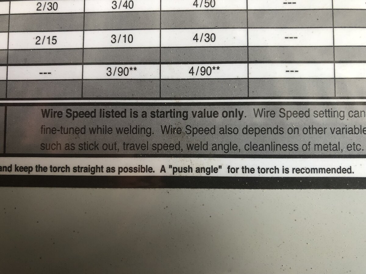

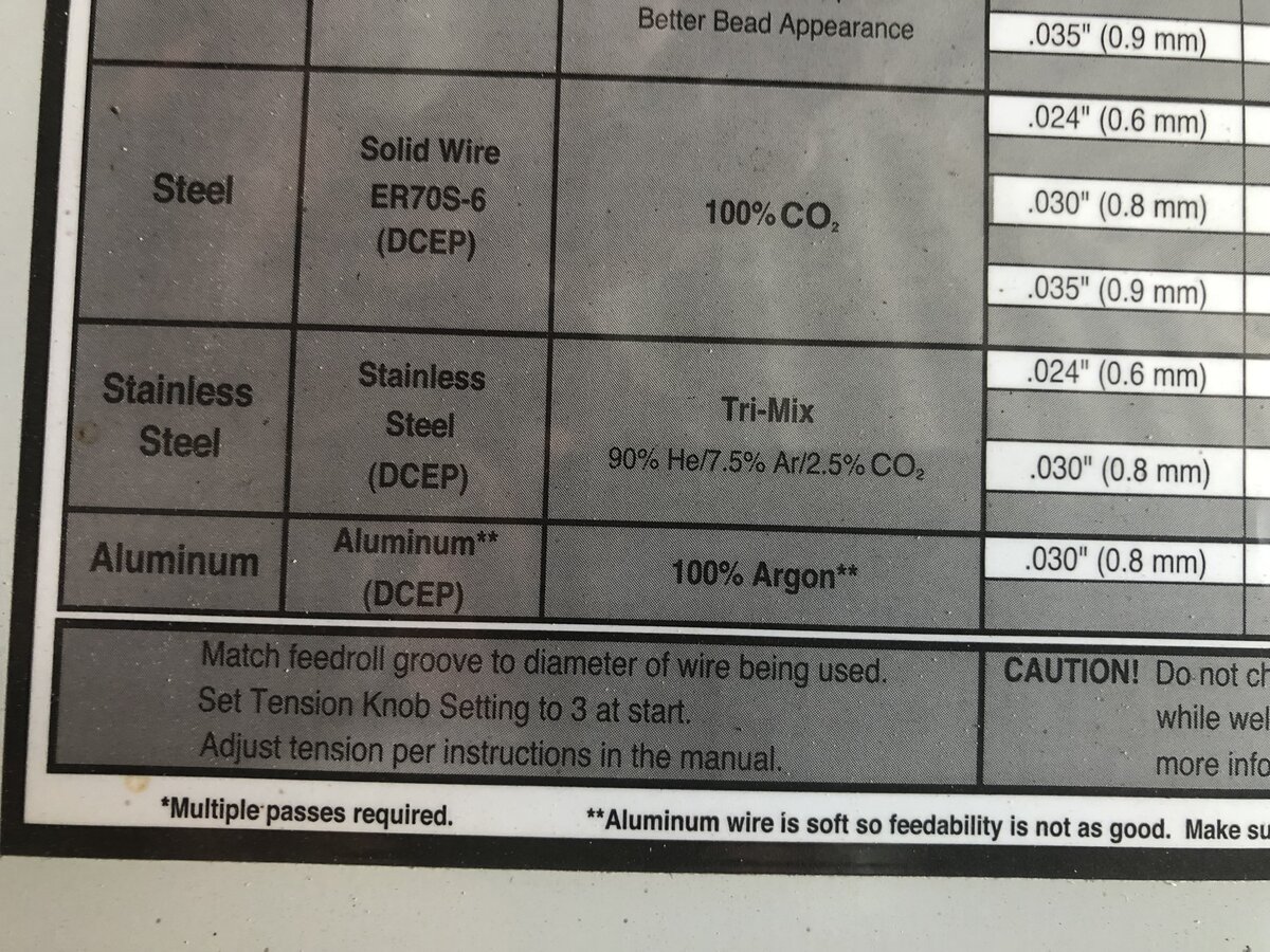

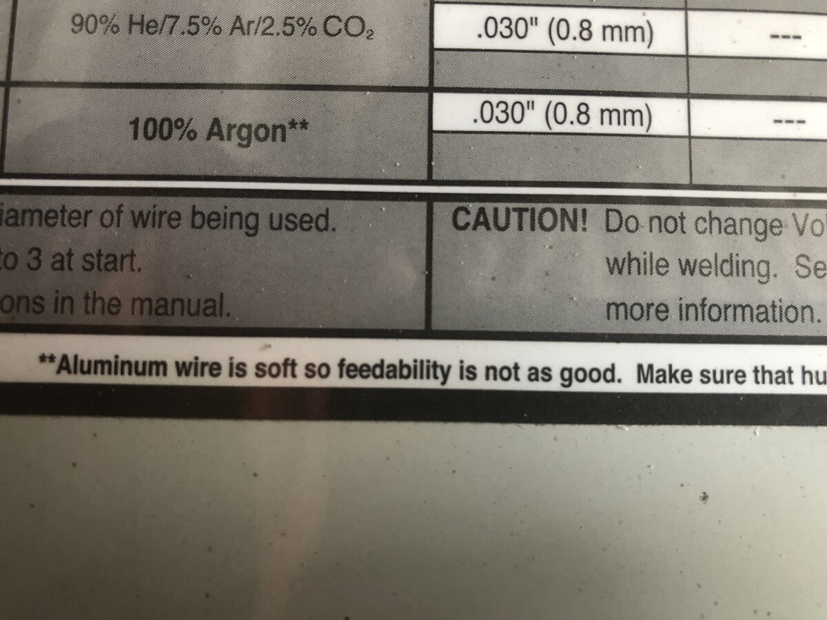

<blockquote data-quote="Bucky" data-source="post: 434767" data-attributes="member: 19423"><p>Yes I’ve used it to make short aluminum welds. The lead must be kept as straight as possible and I put on a new tip.The wire does jam once in while but it gets the job done. The down side is that I need to switch to a tank of Argon gas. I bought the 140 used and it came with standard gas and Argon gas tanks.The 140 served me well for a lot of years but the 230 is far superior. I have not used the 230 for aluminum but I would need to use a spool gun because the lead is much longer so the resistance on the aluminum wire would be too great.</p><p>Below is the setup label on the 140.</p><p></p><p>[ATTACH=full]119868[/ATTACH]</p><p></p><p>[ATTACH=full]119869[/ATTACH]</p><p></p><p>[ATTACH=full]119870[/ATTACH]</p></blockquote><p></p>
[QUOTE="Bucky, post: 434767, member: 19423"] Yes I’ve used it to make short aluminum welds. The lead must be kept as straight as possible and I put on a new tip.The wire does jam once in while but it gets the job done. The down side is that I need to switch to a tank of Argon gas. I bought the 140 used and it came with standard gas and Argon gas tanks.The 140 served me well for a lot of years but the 230 is far superior. I have not used the 230 for aluminum but I would need to use a spool gun because the lead is much longer so the resistance on the aluminum wire would be too great. Below is the setup label on the 140. [ATTACH=full]119868[/ATTACH] [ATTACH=full]119869[/ATTACH] [ATTACH=full]119870[/ATTACH] [/QUOTE]
