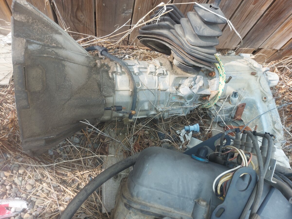

I have a 1994 with a 2.5L 4cyl with a bad transmission, I also have a 1989 4.2 transmission (I think it's a Peugeot BA-10) complete with transfer case and bell housing. Would this make sense to put on the 1994 2.5L and is significant modification required?
Picture is of what I believe is Peugeot BA-10
The Peugeot BA-10 is considered an inferior transmission. It will be okay for your 2.5, but I just pulled mine last week. 1987 YJ Wrangler. I replaced it with an AX-15. The Peugeot has an internal slave cylinder. That means you will have to pull it back out if you ever need to replace the slave cylinder.
Check spline count on output shafts. Could be different.
Bellhousing is different between the 2.5 and 4.2.
The question is will the Peugeot transmission mount to the bellhousing behind the 2.5?
