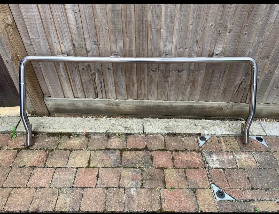

Will a TJ lightbar that sits around and slightly in front of the windshield, fit on a YJ windshield frame?
It's the chrome one that has the four light plates and is bolted in to the bottom outside of the windshield frame in a TJ.
One for sale over here but I don't know if it will sit on the YJ screen frame ??
Or can it be jiggled a bit to fit?
Thanks
Here the one for sale.
Just the chrome mount, not the chrome plates on the Jeep.

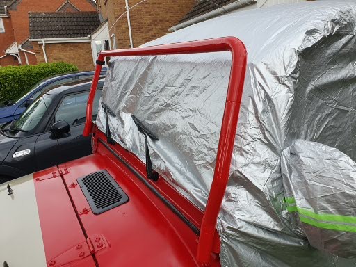

I am pretty sure the TJ windshields are wider. The YJ's windshield is around 53-54", but the TJ is an inch wider. It may be able to stretch in, but don't quote me on it.

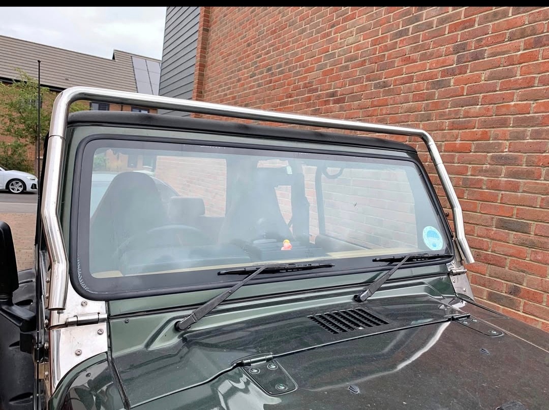

Good news! It fit really well. Had to drill two holes in either side of the frame to accommodate it as it didn't align with any holes on my shield but it sits perfectly on the shield and looks great. Not bad for £40 or $53 in real money.
