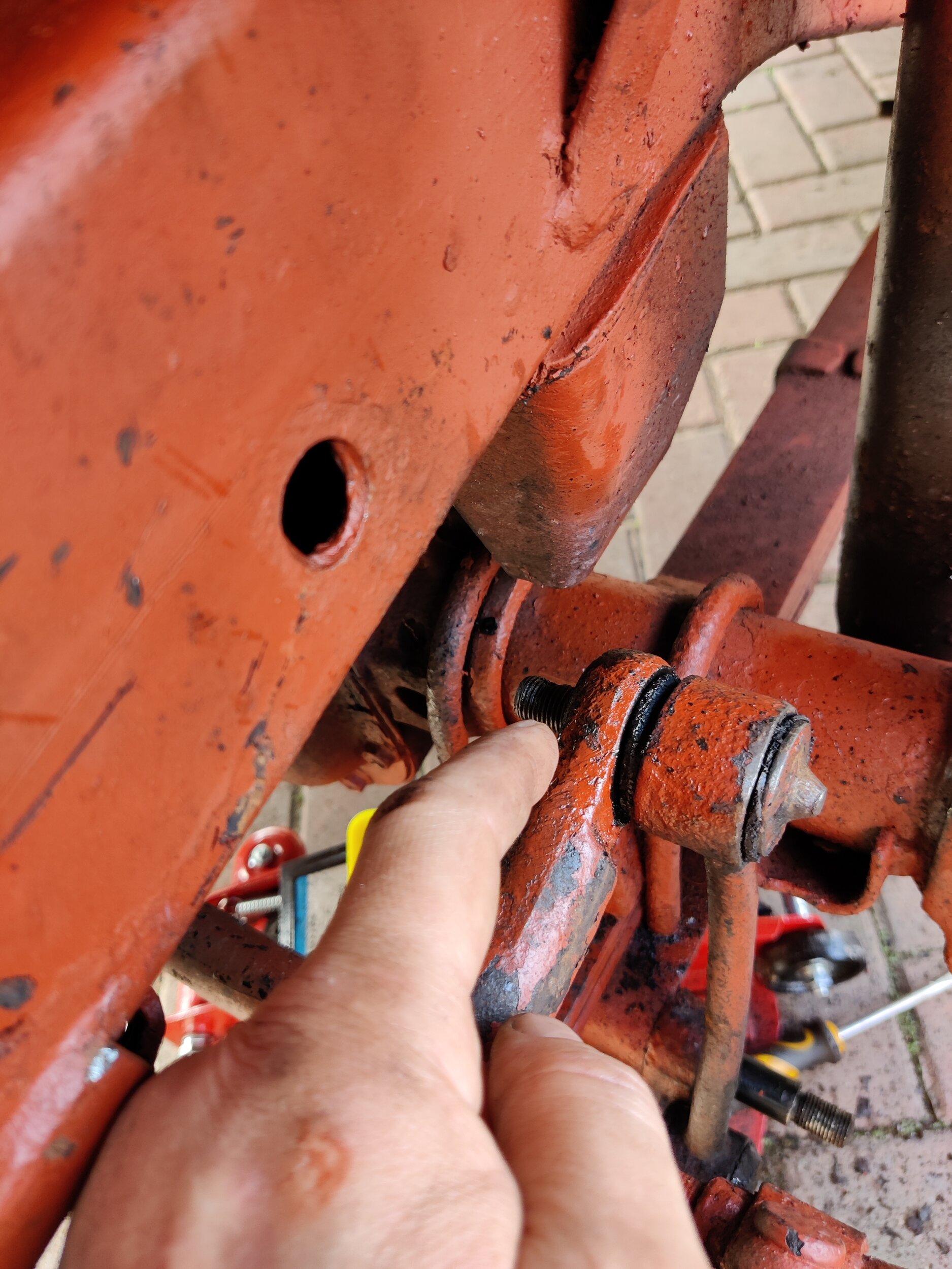

Revisiting this one as I need some more sway bar link advice please?
Can anyone tell me if these links are on back to front please?
I'm asking as I'm trying to workout where an annoying 'kronk' is coming from each time I drive of my curb on to the road. No noises at all when driving on the road but it's returns when I reverse up drive again.
Could the link bar be hitting, grinding, knocking against the shock mount, because to me there looks to be about 2mm clearance from the back of the link bar to the axle support.
Should the link bar be put back on but with the bowed side facing the front of the car?? Giving the axle more space?

the one u-bolt looks like it broke? if it kronk when reverse, could be transmission mount.? sorry to hear about your health. a pickel fork and a good hammer and help from a friend wiil break that link loose. good luck.

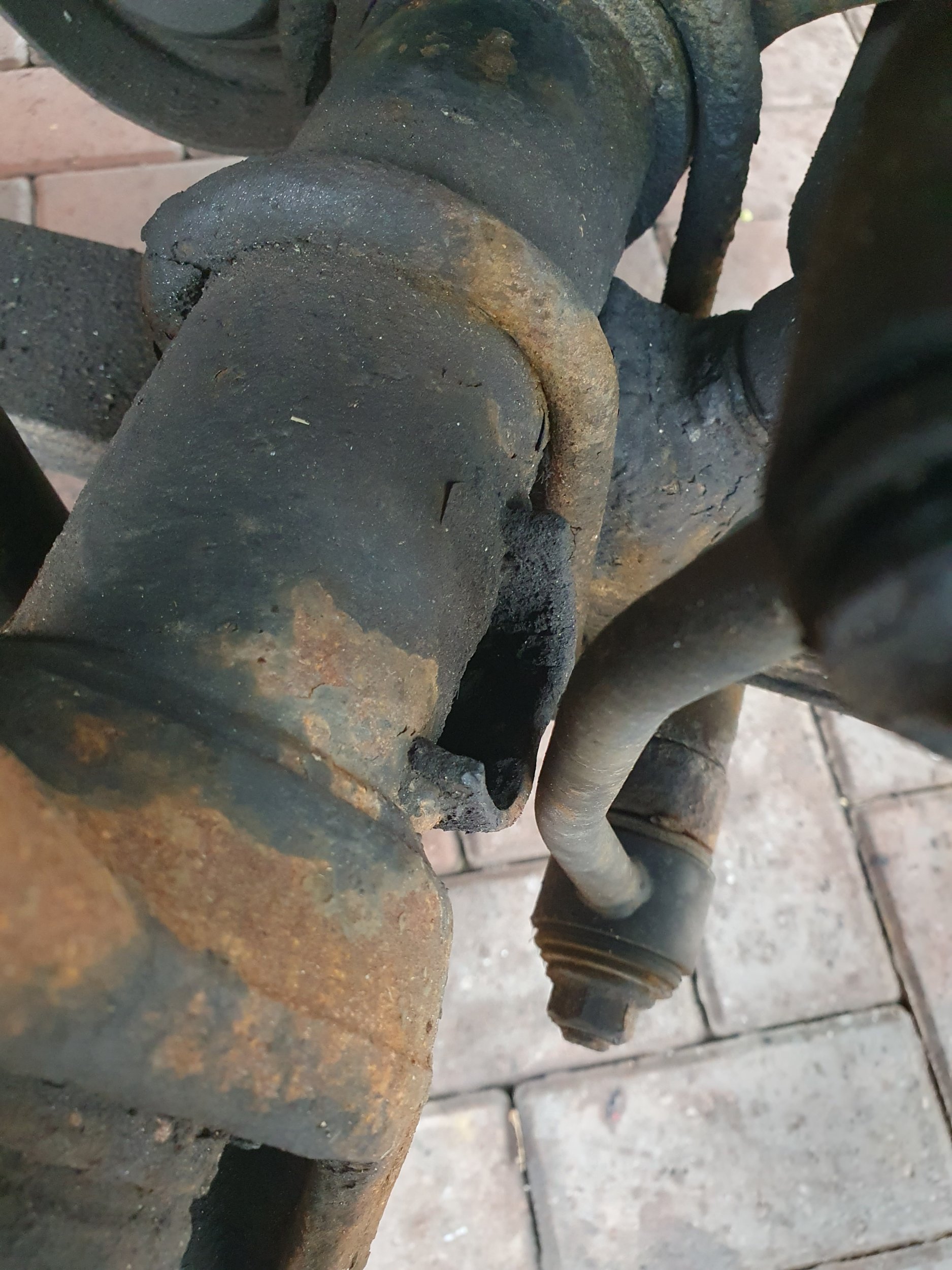

Just out of interest, can you tell me where you think the U bolt might be broken on my pics please?
Juat in case I'm totally missing something as they are so dirty.
Also, do you think the sway bar links are far too close to the metal joint behind them and may hit them when one side or the other of the Jeep goes up a kerb or over a brick for instance?
Will it affect the Jeep if it turn then around to give more clearance??
It's perfectly quiet when going over a bump evenly in both front wheels but only kronks / donks when one or the other wheel goes over a small bump?
i looked closer with mag.fine glass and i think the grease build-up may be what i seen as a crack? it looks like sway bar link is very close to axle mount? if it was hitting there would be a small mark or bright place where it hit. i never seen bar link turned around? hope your health keep improving.

Hi, I double checked the suspension U-bolts carefully and they appear to be in good condition, if a little grimy / dirty. I'll be getting under it at the weekend and scrubbing them to then paint them with rust protector. The British winter has really brought out some surface rust on the chassis and leaf's!
