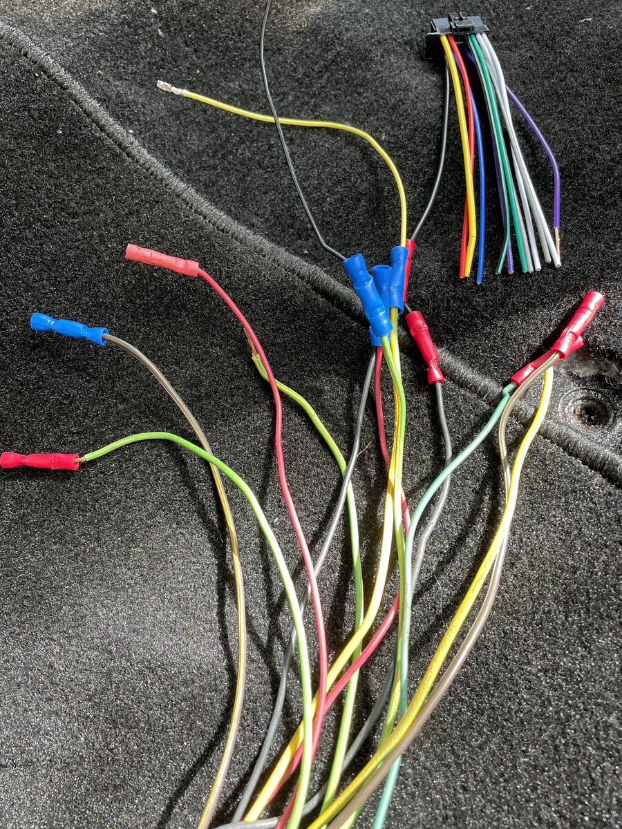

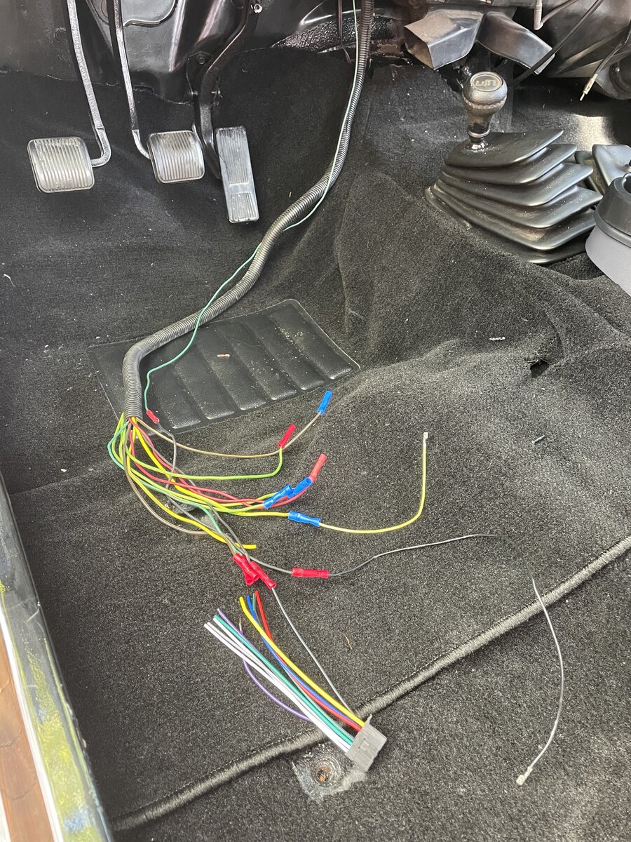

<blockquote data-quote="machoheadgames" data-source="post: 431540" data-attributes="member: 18789"><p>A meter will really only be able to tell you if something has power or not and you can use the continuity function to determine if two wires are the same or if a wire is a ground wire. A better way to go about this is find the wires back where they connect to the factory wires and use the factory color to figure out what each is. Then label the ends where you put on those crimp connectors.</p></blockquote><p></p>
[QUOTE="machoheadgames, post: 431540, member: 18789"] A meter will really only be able to tell you if something has power or not and you can use the continuity function to determine if two wires are the same or if a wire is a ground wire. A better way to go about this is find the wires back where they connect to the factory wires and use the factory color to figure out what each is. Then label the ends where you put on those crimp connectors. [/QUOTE]
