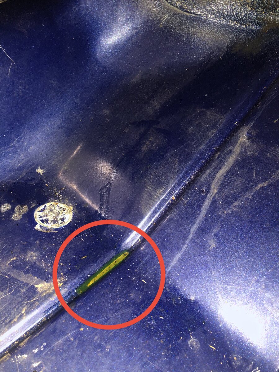

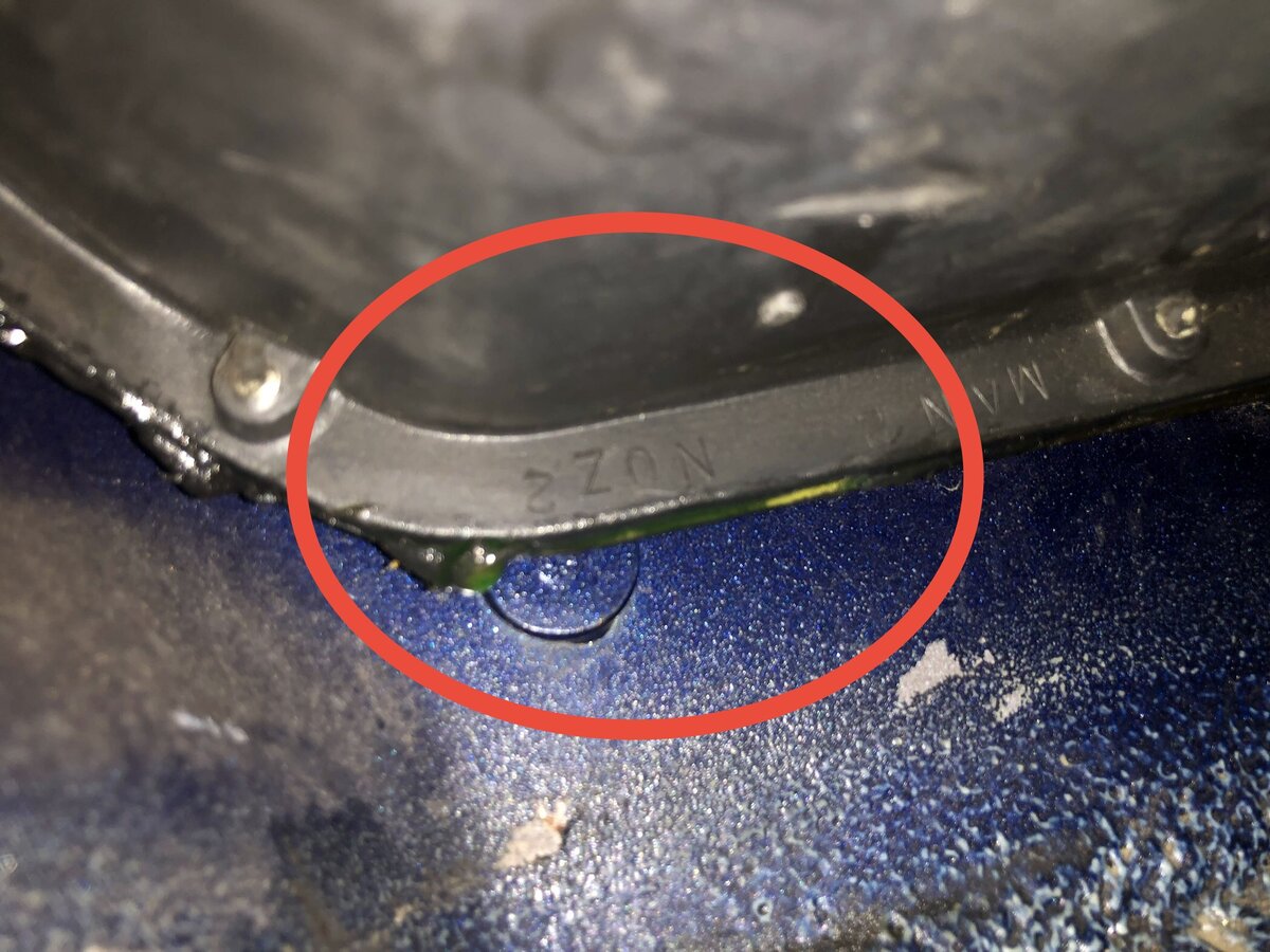

i pulled the carpets as I am planning on bed-lining the floors. I have since noticed a very small amount (Tablespoon) of coolant that pools on the passenger floor daily.
I can see the probable area of the leak as the base of the heater core housing where the two plastic pieces come together. There is a black gooey sealant material around the majority of this seam, but it is missing from the leaking area.
Heater core seems to be functioning as I have measured temp from the heat vents to be 175 degrees, the inlet and outlet hoses that run through the firewall are both hot, the amount of coolant in the system stays full.
My plan is to flush the heater core and see if that helps. I am up-in-the-air about dumping a sealant in the system (read mixed things). Any other advice is welcomed and appreciated.
