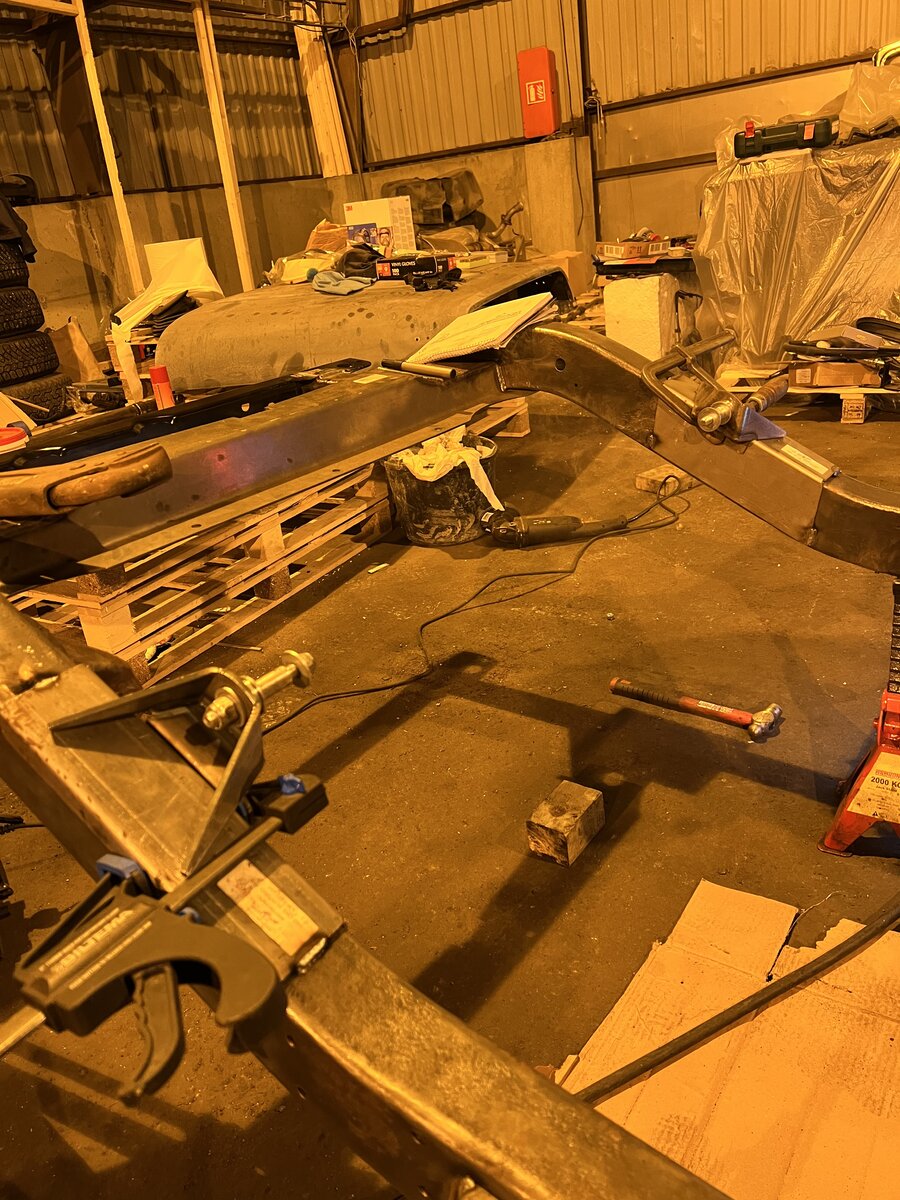

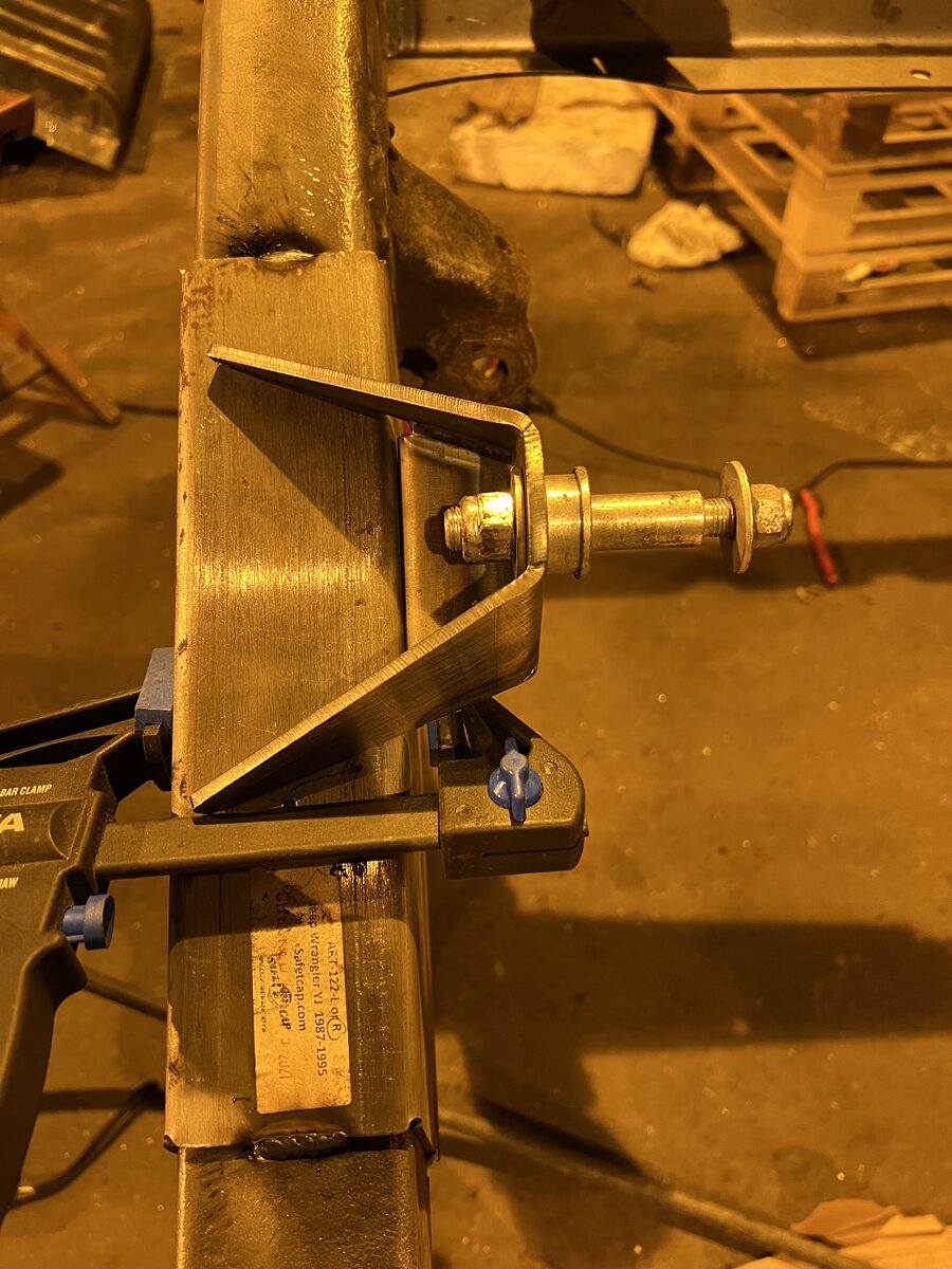

When mounting the upper shock mount and the rear upper shock mount section from Safe-T-Cap the space between the two shock mounts is about an inch less than what the space between the OEM shock mounts were. This means that the top mounting point of the shocks will be around 1/2 inch closer to the centre of the vehicle. Do you have any ideas as to what I should/can do?
