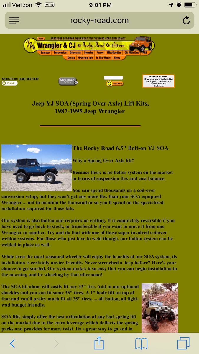

Has anyone used or looked into this SOA Kit? It’s cheaper than getting the Rubicon Express 4.5” extreme duty lift kit. I can also get a heavy duty steering kit included for $1399.
Has anyone used or looked into this SOA Kit? It’s cheaper than getting the Rubicon Express 4.5” extreme duty lift kit. I can also get a heavy duty steering kit included for $1399. View attachment 117198
Well, what are you using your Jeep for? If it’s mild wheeling, I advocate for staying SUA and wheeling it with 4 inch springs and 33’s.
Going to a 35 inch tire is opening up all kinds of need for support. In an ideal world you would need bigger brakes, longer brake lines, lockers, chromos, re-gear, SYE, and arguably hydro assist.

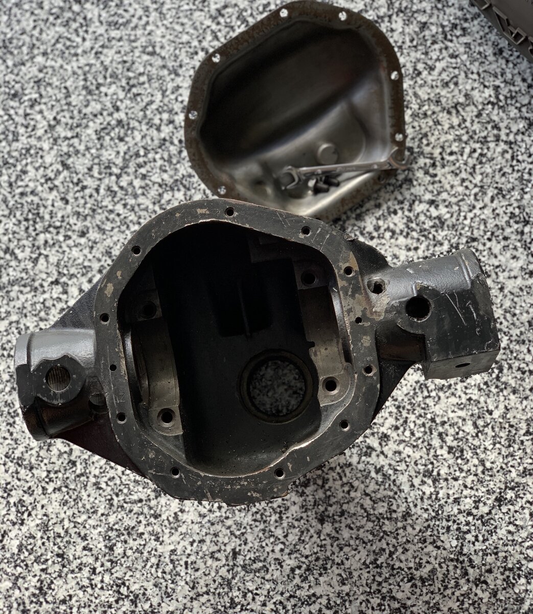

The fourth leaf pad is ideally cast into the housing center section. Requiring no welding or setup.
Attached is a picture of a SUA Dana 44 with the ideal leaf mount cast into the center section.
If going to a one ton, the Ford Dana 60’s are also cast into the centersection, along with Chevy Dana 60’s, aftermarket Dynatrac ProRock 44’s, 60’s, Crane’s Dana 44’s, and Solid Axle Industries Dana 44’s.
