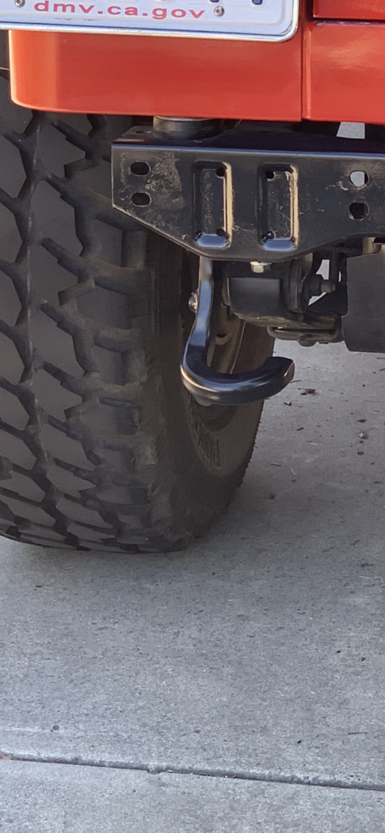

Please post pics on where you have installed one on your yj and if it is on the left or right side. Any options that don’t involve dropping the fuel tank in order to drill frame holes? Any existing holes for bolts? Thanks.

Ended up mounting a JL rear tow hook by drilling through the frame in between the shackle and OEM bumper. Had to trim the horizontal bracket off the hook. Also removed bumperettes and a trailer hitch. Lots of people are getting rid of these hooks off of new wranglers when they upgrade their bumpers.
