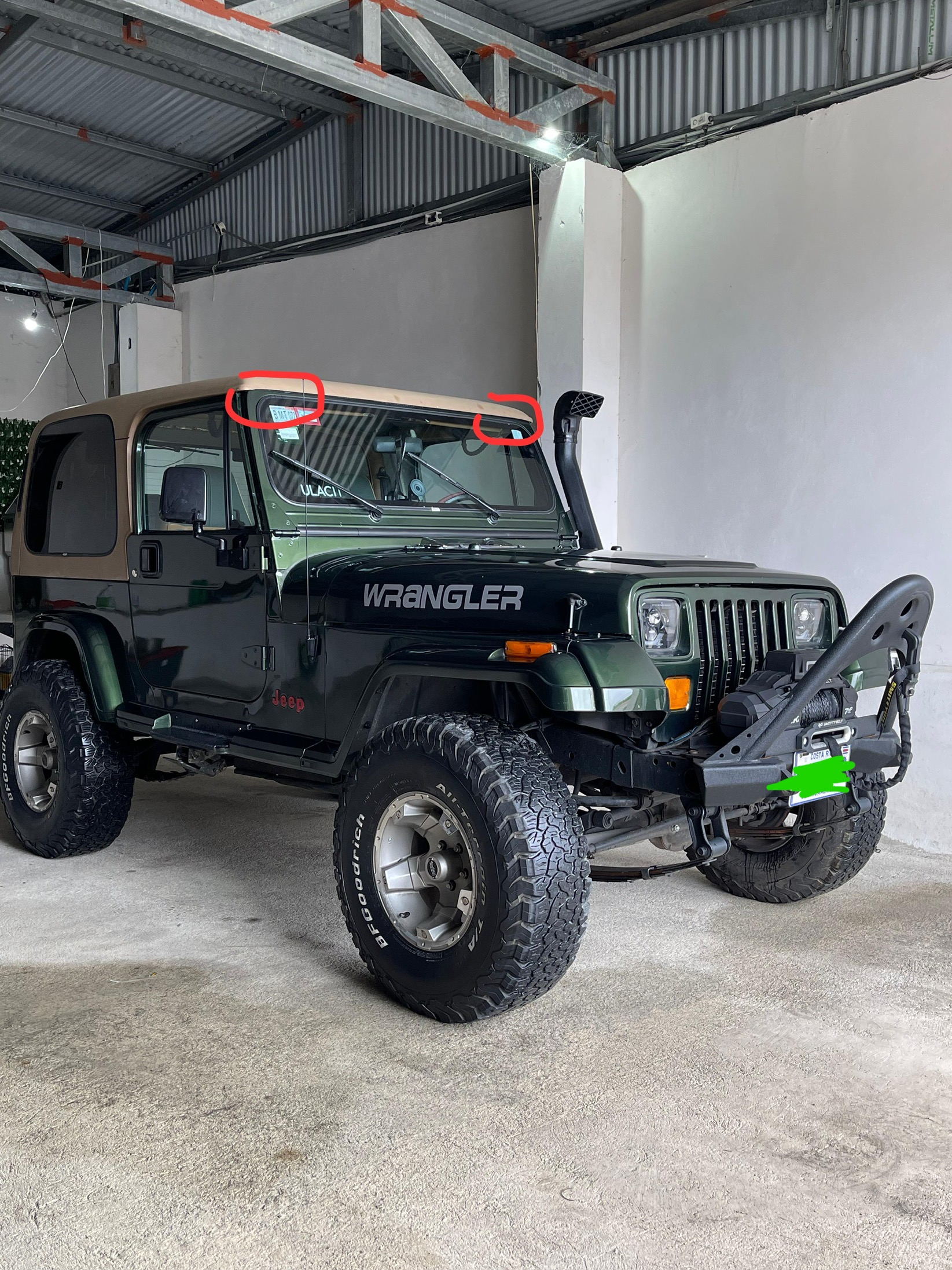

I would avoid the Omix-Ada replacements for those corners. I tried them and while they fit into the hardtop pretty well they are thicker than the oem parts were. I saw other complaints regarding this issue as well. I was having a hell of a time getting the hard top to sit properly on the Jeep again after replacing the front seal and both of those corner seals. I figured well they are new so maybe they just need some time to settle. After months it didn't change and I finally yanked them out.
