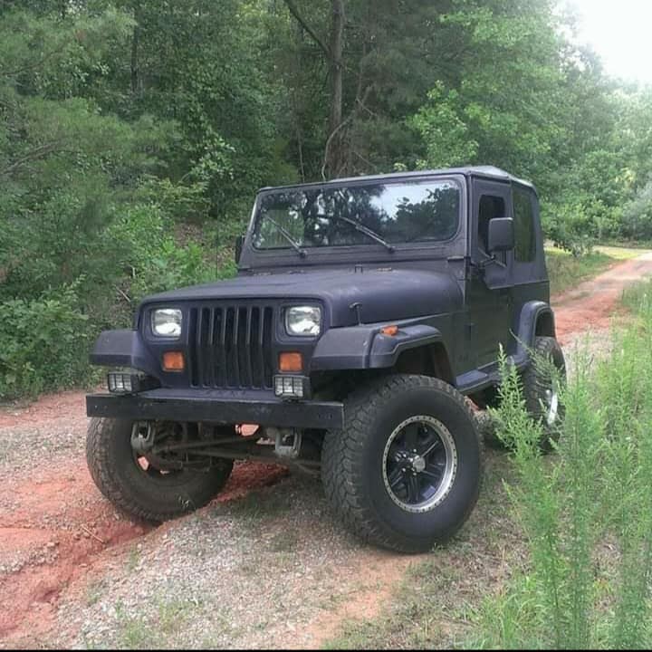

Suppose I'll add to the build threads here and create my own. If you're reading through my thread I hope you'll find something useful in it or get inspired to build your rig. I like to think my build is a little unique compared to other builds, you're going to see stuff that's been done and probably a thing or two you haven't seen done to a YJ before.

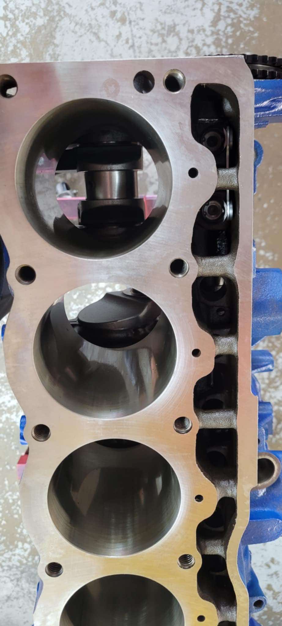

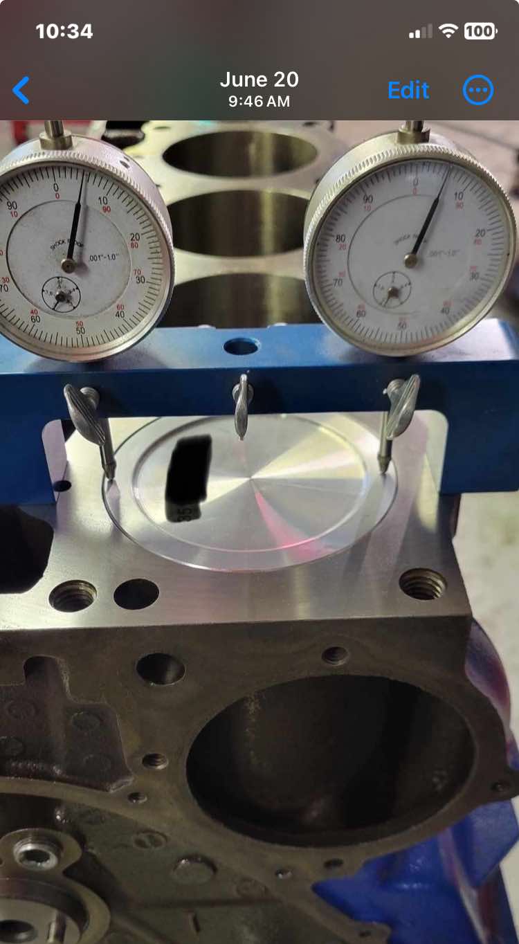

I'm going with as much made in the USA parts as I can ordering from companies like GenRight Offroad, PSC, FlowKooler, Kentrol to name a few, and I'm using a local engine builder to build a one off unique 258 who's known for building the most powerful Jeep Inline 6 engines on the planet, Keith Newcomer of Newcomer Racing. He's going to feature my build on his personal YouTube channel and do a dyno session so we all get to see what it does. I'm not going for 1000 HP or 800 hp... I told him I'd be happy in the 350/400 range, and there are no guesstimates as to what this engine will produce as its a kinda of prototype build so we will just have to wait and see.

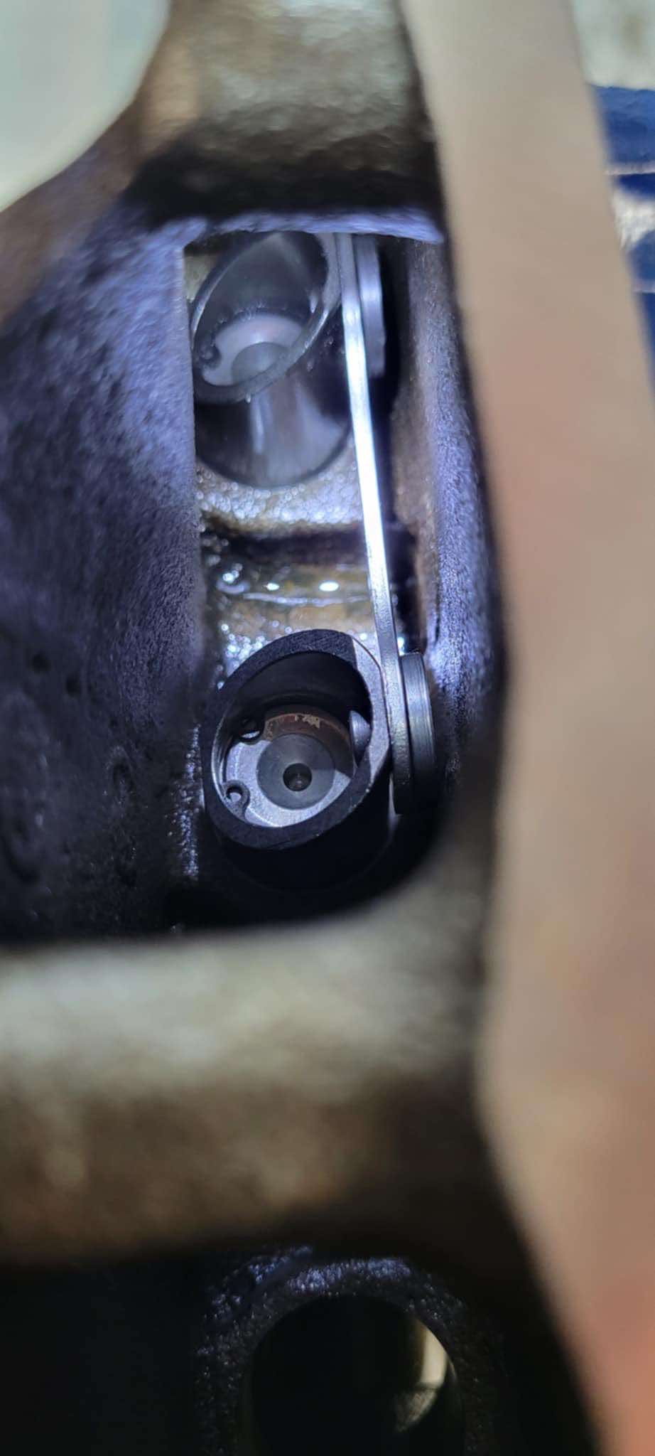

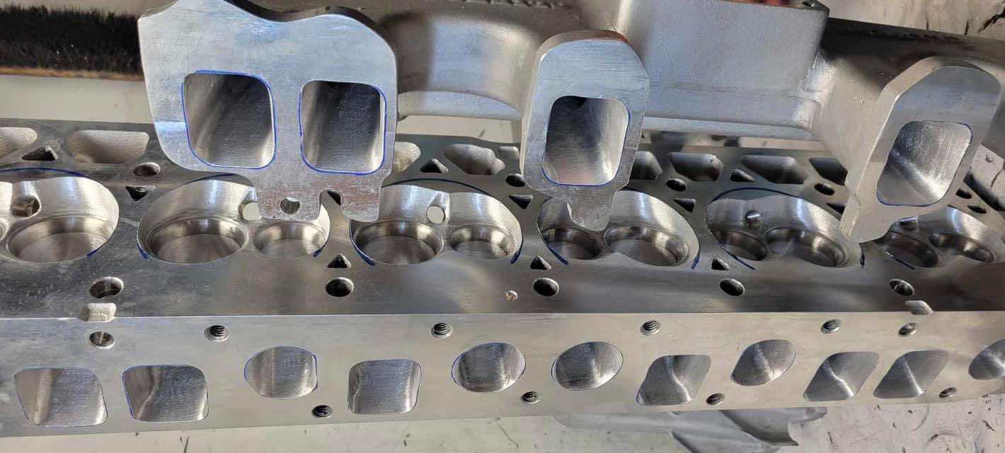

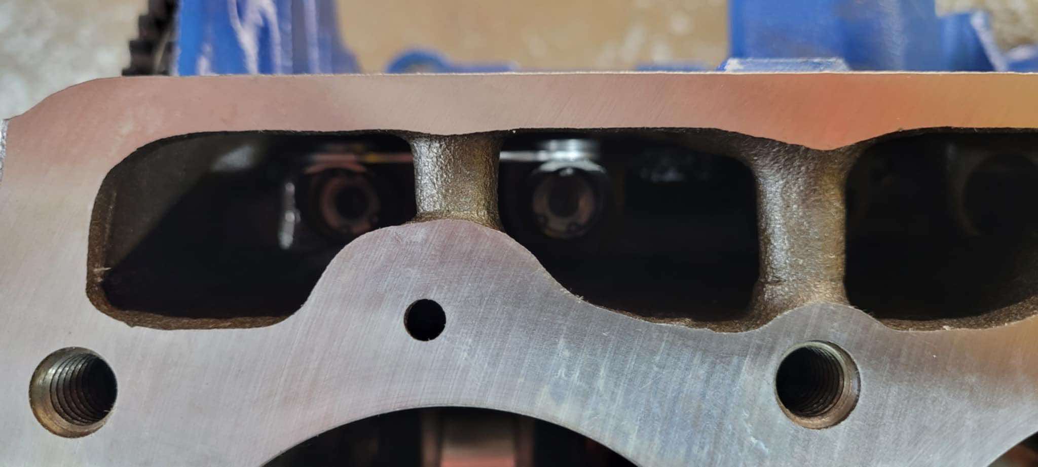

I suppose I can tell you he's done a full port and polish on my Edelbrock head and installed larger valves and 1.7 Newcomer Racing spec adjustable Scorpion Roller Rockers. He also ported and polished the Clifford 6=8 4bbl intake manifold and I've added a 1" spacer and topped that off with an MSD EFI Atomic 4bbl kit, but for the dyno he's going to break it in with his trusty Holley 4 barrel often seen on his YouTube builds. I'm not able to talk about the bottom-end or camshaft selection, you'll just have to wait and see it in the video. Just know, I've spared no expense for this build and its the most expensive part of my YJ build, holding that in-between the frame are Brown Dog Super Mount Engine Plates & 1" polyurethane engine mounts.

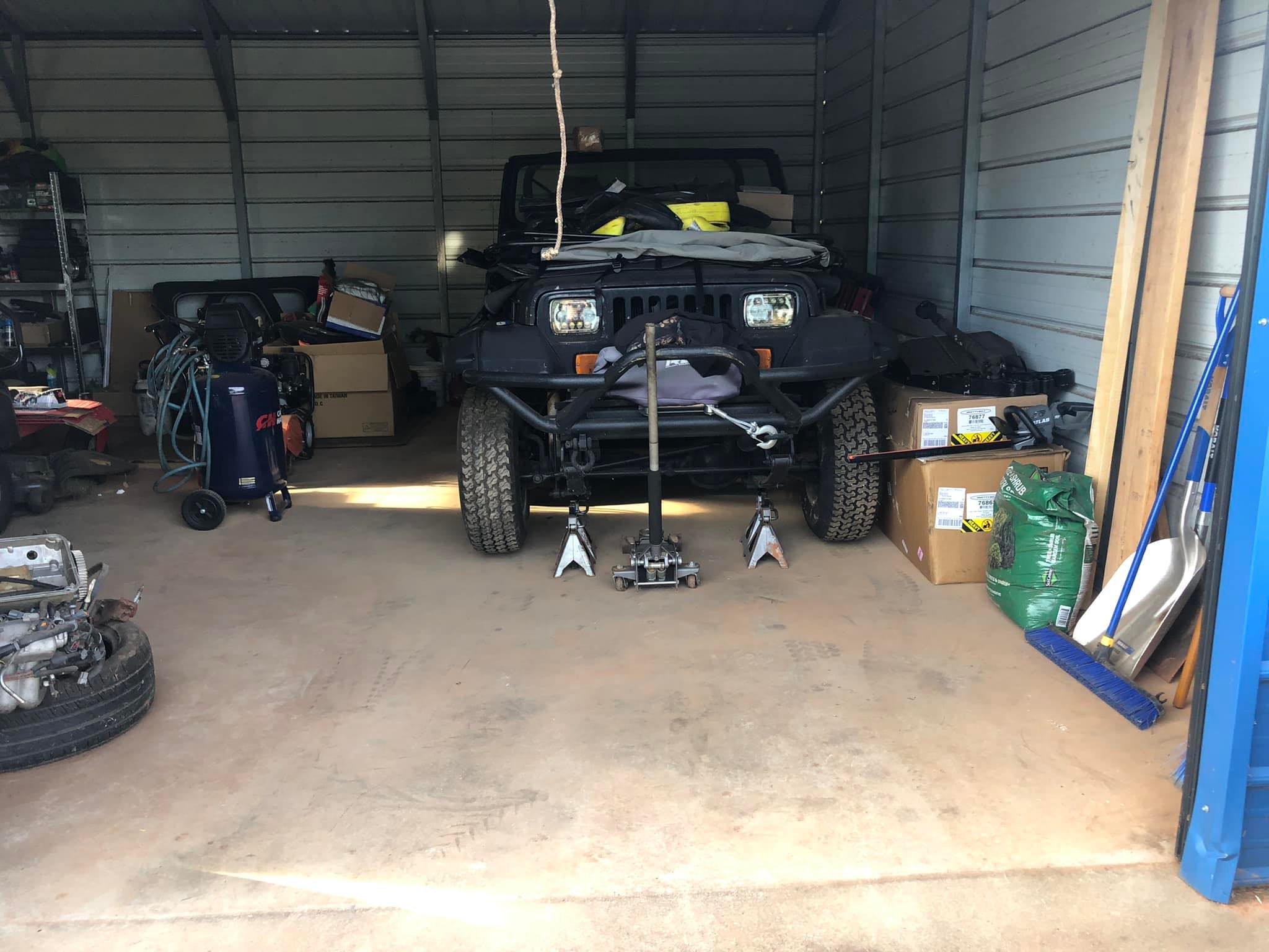

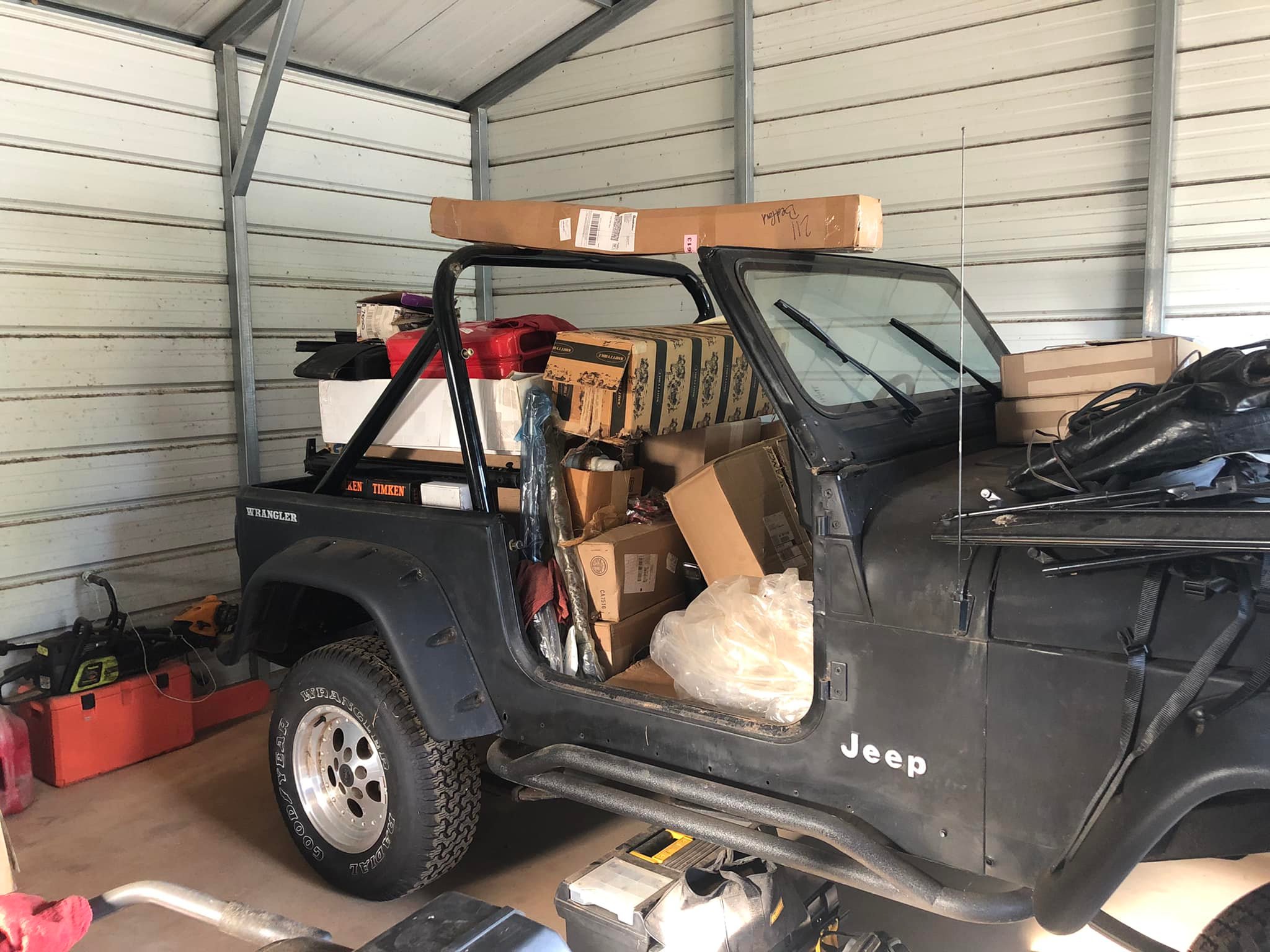

There are so many more parts and items to talk about that I have (my storage building looks like a parts warehouse) but I'm going to cut it off here and I'll just pick the rest up as I go along. Thanks for following along.
