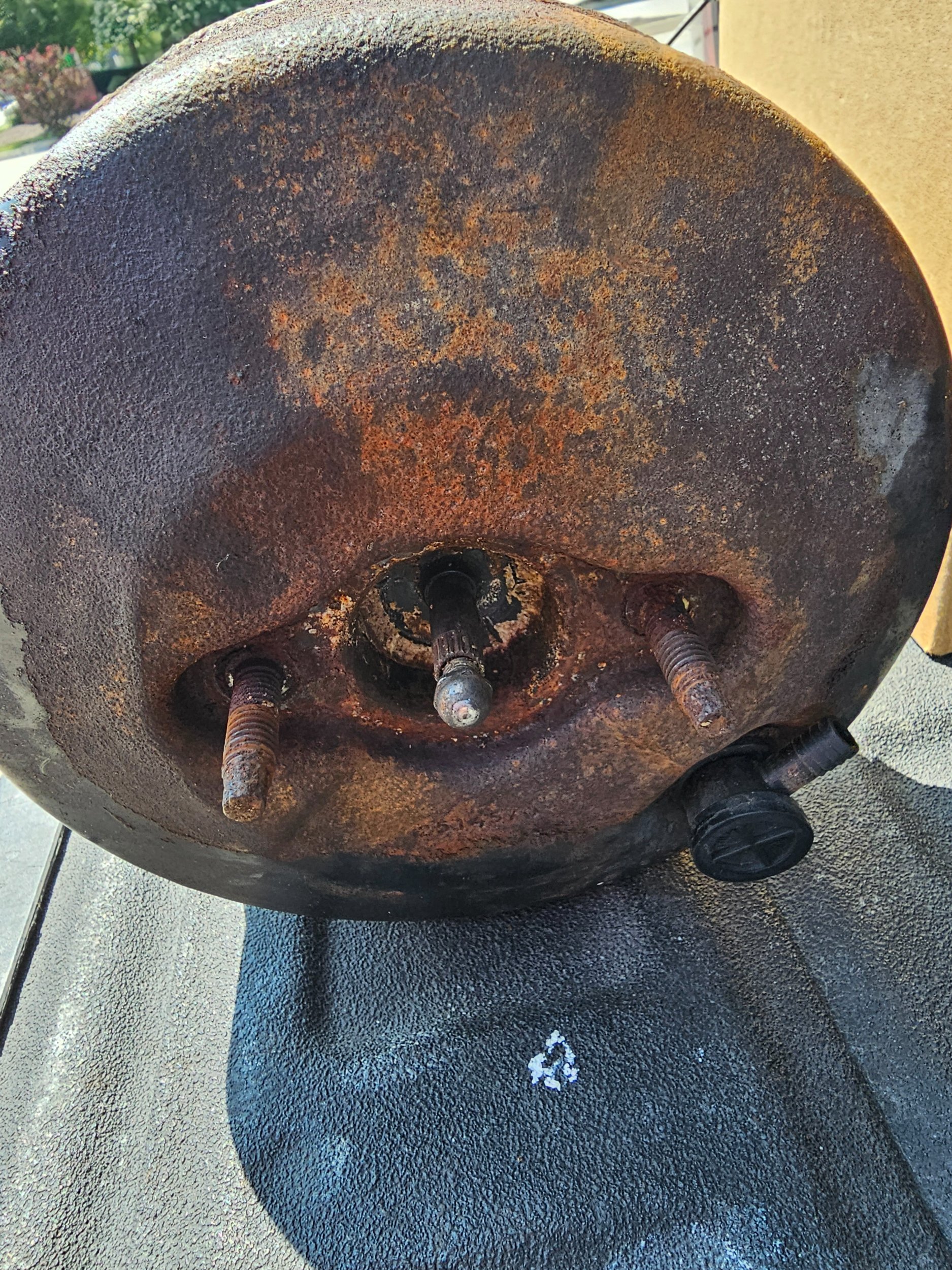

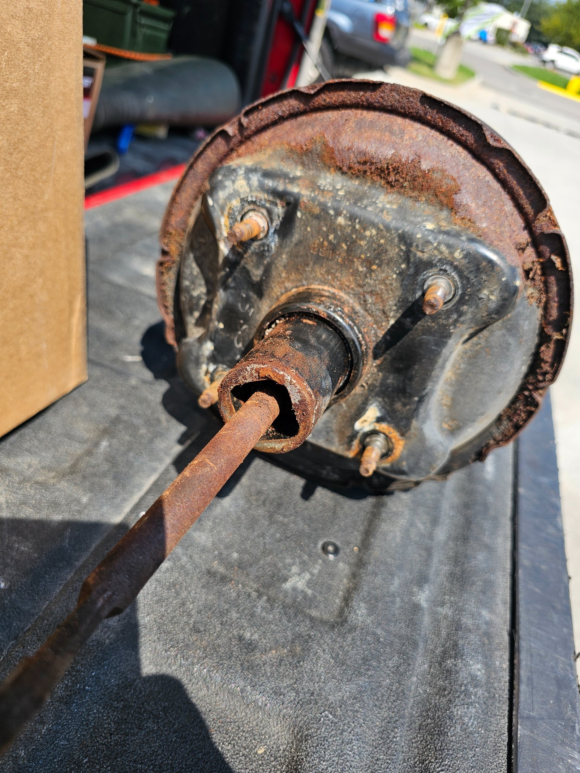

I am about 4 weeks into my brakes issue that came up after replacing my hubs. First, I thought it was a M/C as it was way rusty and had bubbles in rear port of front brake res. That didn't fix it. While on the goodness knows which bleed event, went with new hoses at all 3 location. Then, during another bleed session, could hear air in passenger caliper but no fluid leaking. Changed out calipers for re-mans. Still cannot get air out of front. Rears "seem" to bleed up fine enough. Bench bled M/c on vehicle enigine off, zero bubbles and dluid movement when it should. Connect back up, whole other bottle of fluid and still have air in system and very, very weak pedal. Anyone with ideas? Oh, and changed booster and P-valve and both front hard lines and m/c to p-valve lines
