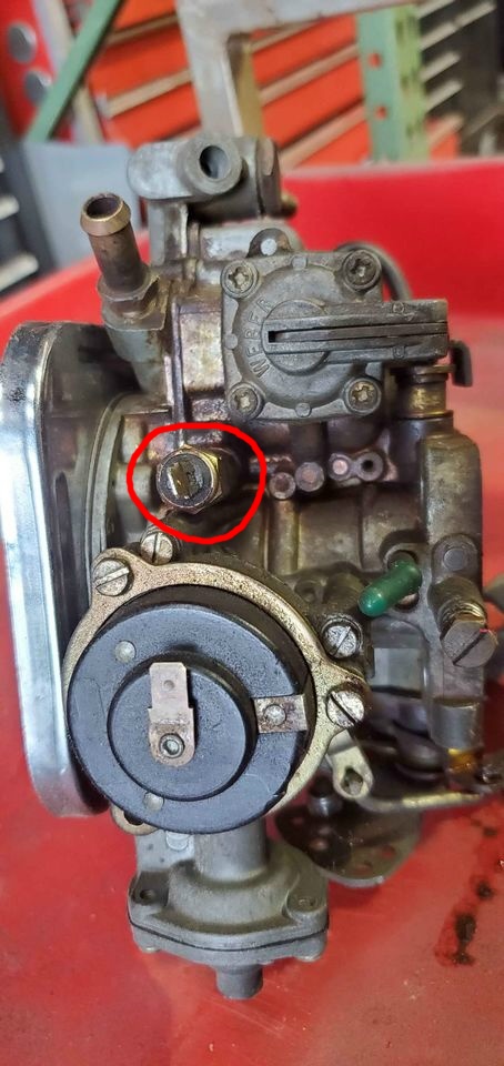

Having some identification problems. I want to put this carb on my 87 Wrangler 4.2. It has two electric plugs on it. I don't know what to hook to them. I have found the one smaller on on the parts identification sheet but still don't know what to do with it. The larger one I have no idea at all. Can somebody help me with this?

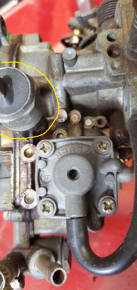

Thanks for the reply but I guess I wasn't clear on my requests ... I need to know what the ones are that are in the circled area.. The RED on and the YELLOW ones.

What you show is a slightly different model, but: On my Weber: The red one is where the Idle jet is.
I've seen the yellow location (on the opposite side) call out a main jet.

I've been told the red one is the fast idle adjuster. It's very sensitive so apply tiny increments to get it running smooth.
