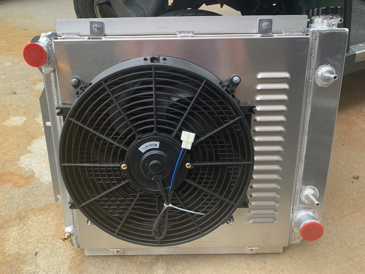

As far as the drive train I have a new aluminum radiator with electric fan and motor mounts from Novak along with the adapture for my transfer case to the Automatic transmission. Also have acquired Shifter and floor panel cover too.

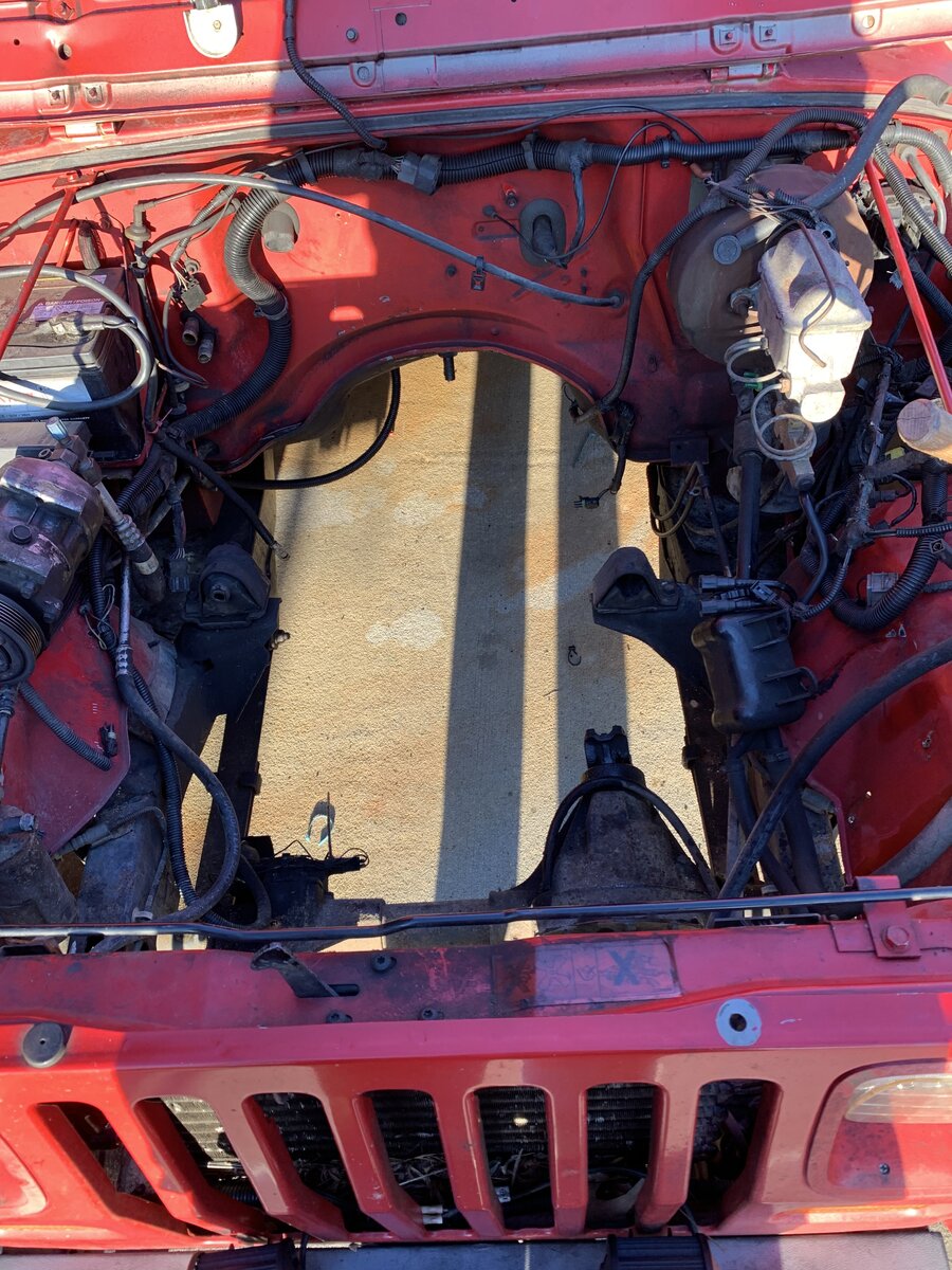

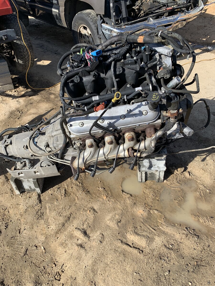

This pic just shows the engine, transmission and TC out. I have since stripped all wiring and AC. Getting ready to remove front grill and fenders and cut and weld motor mounts, then paint.
Its going to be an adventure just like riding the jeep with the tops all removed.!! More to come.
