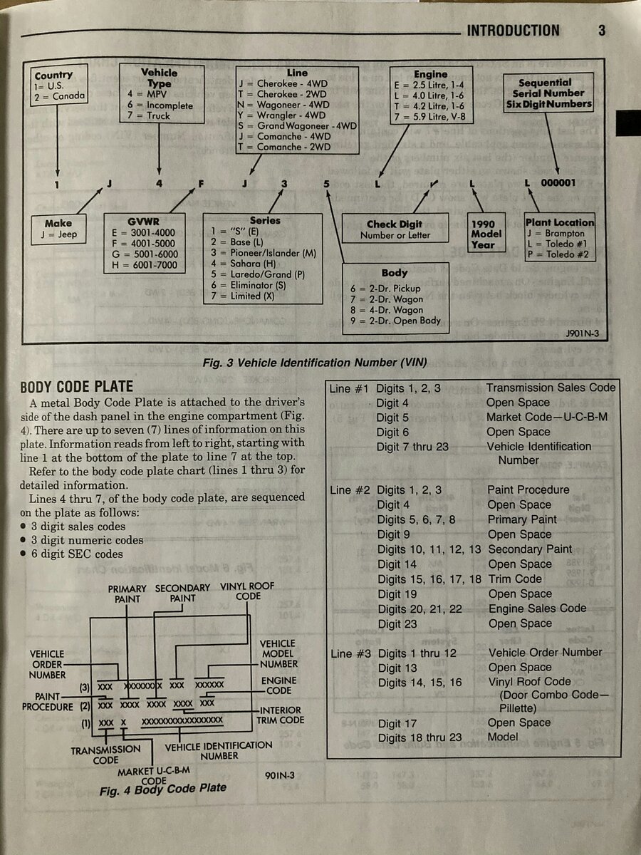

The paint code should be listed on the body trim tag located on the driver side of your firewall, you'll find it on the second line...try the following to sort it out. Excerpt is from a 1990 Jeep Wrangler shop manual but the trim plate specifics should be the same...

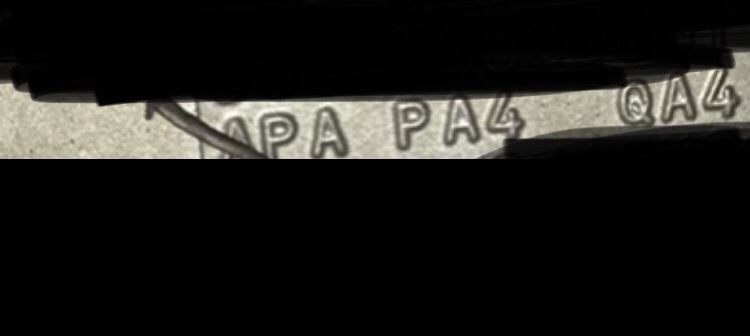

Here is where is says PA4 on my plate so that has to be it. I’m seeing some online for sale with that paint code but are around $40 for a spray can. Is there some way to find an exact match through this paint code? Or am I just going to have to match it by sight. I am only I’m trying to spray one small corner.
I admit, I'm not well versed when it comes to paint issues except to say that the flake size in the mix will make a difference when it comes to matching the area you will be shooting to the surrounding area. Did you engage the reps at the two links provided and are you shooting the paint yourself?
